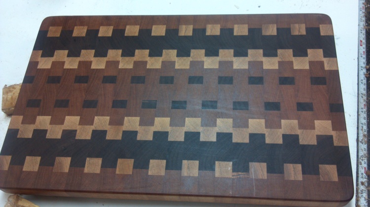

Board #1

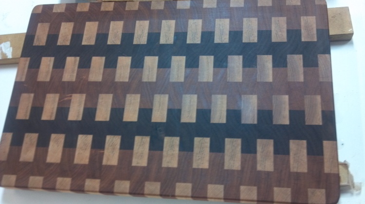

ning-walnutstyle1-24454-15.jpg?width=750Board #2

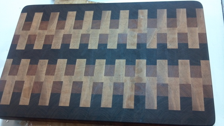

ning-style3cuttingboard-24454-89.jpg?widBoard #3
ning-style4cuttingboard-24454-36.jpg?widWho would have ever thought you would really enjoy going to the shop to sand?

Very nice looking cutting boards.

I really like the pattern. To get the effect, do you edge join different species of wood then cross cut it into strips,  then flip every other one and then glue and clamp? You should blog the process.
You got it Mike. That is the process. I have a blog on here for doing them I did when we first started the site. I'll look the link up and post later.
