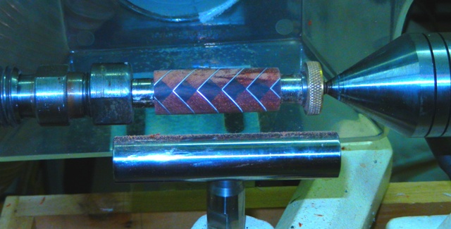

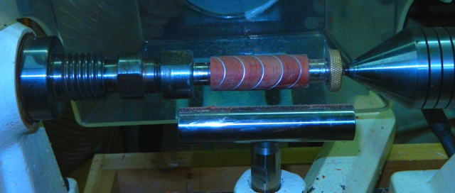

September 7, 201213 yr comment_24357 This is a segmented pen blank made from Paduk, Rosewood & Aluminum flashing. I saw a gentleman on IAP that made one and I wanted to try it out. This is almost finished. I'll post a blog when shes completed and assembled on the pen kit. www.thepatriotwoodworker.com Proud Supporter of Homes For Our Troops Report
September 7, 201213 yr comment_24360 Wow!! That is way cool Mike! I love the aluminum with the wood. Let's see it turned!John MorrisThe Patriot WoodworkerProud Supporter of Wounded Warrior Project and Homes For Our Troops Report

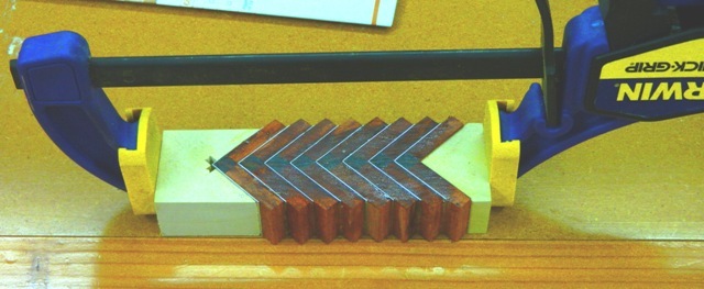

September 7, 201213 yr comment_24359 Cool, Mike! Did you use epoxy to glue the pieces?Lew Kauffman-Wood Turners Forum HostTime traveler. Purveyor of the world's finest custom rolling pins! Report
September 7, 201213 yr Author comment_24358 Thanks John! I'm about 3/4 done with turning, It's a slow process trying not to be too agresive so I don't have any seperations on the segments. I should be done with it today.Thanks Lewis! The Rosewood and Paduk is joined with CA and the aluminum is attached with epoxy then the sub-assemblies are joined with epoxy as well. www.thepatriotwoodworker.com Proud Supporter of Homes For Our Troops Report
