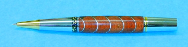

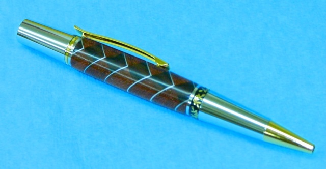

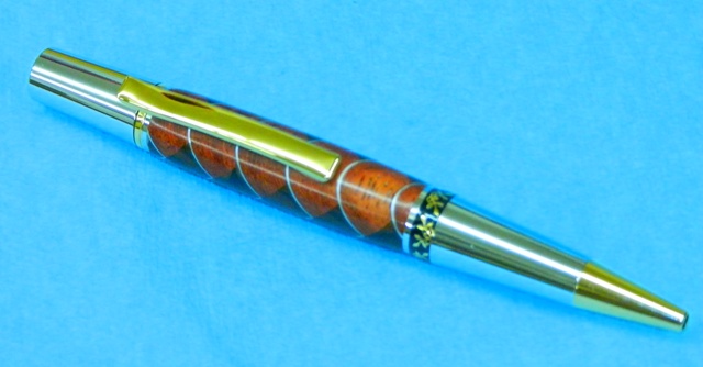

September 8, 201214 yr comment_24303 I've been working on this pen for 2 days and finally completed it this evening. This is a design I found on IAP. A gentleman with the handle of "FireWhatFire" was kind enough to provide a blog for those that wished to try it out. My rendition is made from segments of Paduk, Rose wood and Aluminium mounted on a Craft USA Artisan Aero 10K gold & chrome kit. The finish is 10 coats of CA.  Building the blank didn't take very long but the turning was very time consuming. I had 2 blowouts during turning and repaired them. Next time I will use wood that has greater contrast with each other and I'll use a less porous wood than paduk. For those interested I'll post a blog on how the blank is constructed. Thanks for viewing and comments and critiques welcome! www.thepatriotwoodworker.com Proud Supporter of Homes For Our Troops Report

September 8, 201214 yr Author comment_24310 Actually Arlin I assembled the blank and then drilled it. I do most of my drilling on the lathe. Before drilling the blank I wrapped it with cheese cloth and then saturated it with thin CA glue. I'll show the process in the blog shortly.www.thepatriotwoodworker.com Proud Supporter of Homes For Our Troops Report
