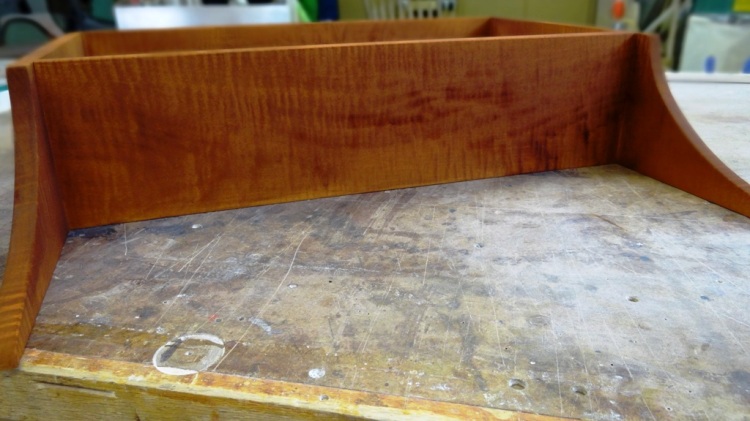

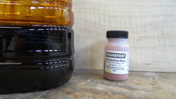

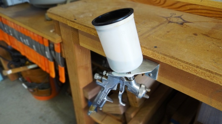

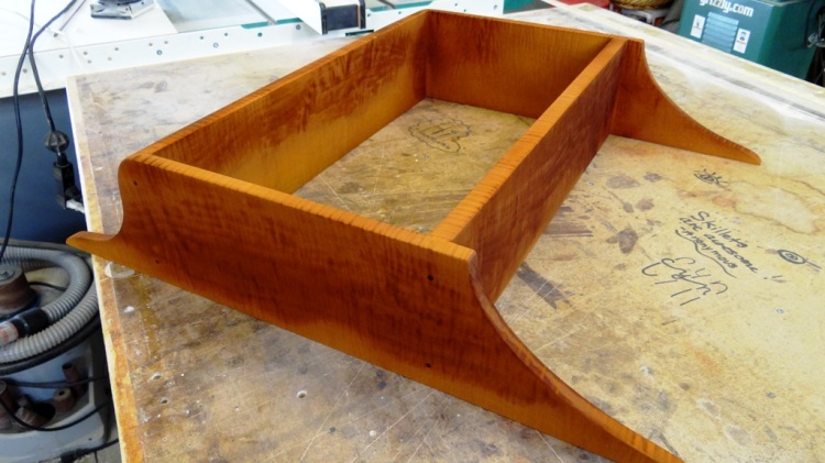

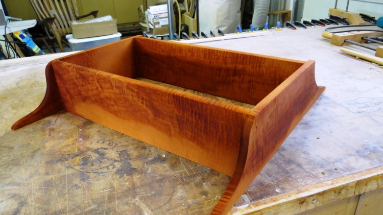

September 10, 201214 yr comment_24235 For Parts One and Two go to Simple Wall Shelf Part One and Simple Wall Shelf Part Two. Well here we are again folks. Today I finished sanding my shelf out to 180. And I applied one coat of Early American Transfast Dye. All in all I spent about 30 minutes in the shop today going through this process. Since I already had a batch of the dye made up from my last project, all I had to do was pour about a cup of dye in my Gravity Feed Spray Gun and set my regulator to 60lbs and off I went. I love my gravity fed gun, unlike cup guns, the finish is bled down through the gun by gravity, the cup guns depend on suction and if you've used cup guns enough, you'll know that when the material gets low, and you tip the cup gun, it sucks air and does not apply material. With the gravity fed you don't worry about that, it never runs dry when low. In this first pic you can see the type of dye I used, I love this dye, it is easy to use and I can custom color my work as I see fit. Plus the folks who make TransFast Dye's have a great finishing forum that we can access for questions about using their product. As you can see I stored my last batch of dye in this convenient 1 gallon water container. I mixed the dye per the instruction at 1oz per 2 quarts ratio. Now the nerve racking part about using dye is when you first apply it, it can look horrible! It is blotchy, and uneven. But don't be tempted to smooth it out!!! Let it dry, it will all even out during the drying process. Believe me, the natural instinct is to reapply immediately, follow up with a brush to even it out, and all other sorts of techniques to even out stain, don't do it!!! It's ok to have a brush handy for drips, but beyond that, apply, and leave it alone! I took this photo below so you can see how blotchy it looks immediately after application. Looks horrible doesn't it! Don't worry. You'll see how it evens out in just a matter of hours when I post an update tomorrow. Tomorrow I am going to follow this up with a coat of BLO, and then we'll go from there. Thanks for reading! John Morris The Patriot Woodworker Proud Supporter of Wounded Warrior Project and Homes For Our Troops Report
September 10, 201214 yr comment_24250 The dye really makes the grain pop!Is that a regular spray gun or a HVLP gun?Lew Kauffman-Wood Turners Forum HostTime traveler. Purveyor of the world's finest custom rolling pins! Report
September 10, 201214 yr comment_24249 I'm an idiot! Can't read!! Sorry about the spray gun question.Lew Kauffman-Wood Turners Forum HostTime traveler. Purveyor of the world's finest custom rolling pins! Report

September 10, 201214 yr comment_24245 Very nice looking John. I just got to give the dye thing a try. I have never used it but I sure like the look and the way it evens out. I like the Woodriver HVLP gun. That is the same one I use. I spray a lot of shellac and varnish with mine.John MoodySite AdministratorJohn Moody Woodworkshttp://www.johnmoodywoodworks.com Report

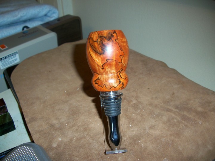

September 10, 201214 yr comment_24244 I'd like to try dying some maple. I made a spalted maple bottle stopper last year that some of you may remember. It was dyed orange for Halloween, I believe i got it from WoodCraft but i cannot remember for sure. I would really like to try it on some maple I already have. I'll have to look up the different parts needed to do this and see if it is something I can afford.   John Moody said: Very nice looking John. I just got to give the dye thing a try. I have never used it but I sure like the look and the way it evens out. I like the Woodriver HVLP gun. That is the same one I use. I spray a lot of shellac and varnish with mine.John MoodySite AdministratorJohn Moody Woodworkshttp://www.johnmoodywoodworks.com Report
September 12, 201214 yr Author comment_24243 Charles, the little bottle of powder costs about 16 bucks, and it yields a gallon of stain if you stick with the ratios suggested. You would mix a small amount as a time per ratio, but I think it would fit into your woodworking style and conditions nicely. It does not take up much room like cans of stain do. I am sold on the dyes, there is just way too much you can do with them as far as colors and such. I highly recommend dyes to anyone looking to expand their color charts beyond Home Depot or Cabots!Charles Nicholls said: I'd like to try dying some maple. I made a spalted maple bottle stopper last year that some of you may remember. It was dyed orange for Halloween, I believe i got it from WoodCraft but i cannot remember for sure. I would really like to try it on some maple I already have. I'll have to look up the different parts needed to do this and see if it is something I can afford.   John Moody said: Charles NichollsSite Hostnicholls61@att.netProud supporter of The Wounded Warrior Project, Homes For Our Troops and the NRA John MorrisThe Patriot WoodworkerProud Supporter of Wounded Warrior Project and Homes For Our Troops Report

September 12, 201214 yr comment_24241 Very nice looking dye job. Can't wait to see it after the BLO. Will that be the final finish?I've not tried Transtint , however I have used water based dyes from Lee Valley. They are only wood tones, though. Lee Valley suggests using applying their dyes with a rag. A spray gun would be far less messy, I'm sure. Gene'The true soldier fights not because he hates what is in front of him, but because he loves what is behind him.' G. K. Chesterton Report
September 12, 201214 yr Author comment_24240 The BLO just adds a bit of honey warmth Gene for this project. We are going to brush on one coat of 2lb Amber Shellac and two coats of oil based varnish. Gene Howe said:Very nice looking dye job. Can't wait to see it after the BLO. Will that be the final finish?I've not tried Transtint , however I have used water based dyes from Lee Valley. They are only wood tones, though. Lee Valley suggests using applying their dyes with a rag. A spray gun would be far less messy, I'm sure. Gene'The true soldier fights not because he hates what is in front of him, but because he loves what is behind him.' G. K. ChestertonJohn MorrisThe Patriot WoodworkerProud Supporter of Wounded Warrior Project and Homes For Our Troops Report
September 12, 201214 yr comment_24239 Please explain why you'd use shellac under the varnish. I be cornfuzed.Gene'The true soldier fights not because he hates what is in front of him, but because he loves what is behind him.' G. K. Chesterton Report
September 13, 201214 yr Author comment_24238 Gene, it works as a great sanding sealer or first coat, but primarily I love the tone you get with a coat of shellac, I love the warmth of shellac, I will be using garnet shellac under the varnish.Gene Howe said:Please explain why you'd use shellac under the varnish. I be cornfuzed.Gene'The true soldier fights not because he hates what is in front of him, but because he loves what is behind him.' G. K. ChestertonJohn MorrisThe Patriot WoodworkerProud Supporter of Wounded Warrior Project and Homes For Our Troops Report
September 13, 201214 yr comment_24237 Thanks, John.I'll try it on an pin oak gun cabinet. My next project is a maple briefcase to hold a couple 45s. Would that finish be durable enough with a few coats of McClosky's  Man-O-War varnish?Gene'The true soldier fights not because he hates what is in front of him, but because he loves what is behind him.' G. K. Chesterton Report
September 13, 201214 yr comment_24236 Putting the shellac on first also helps to give it a really good smooth surface. When sprayed on it will really smooth out and make the varnish really slick up.John MoodySite AdministratorJohn Moody Woodworkshttp://www.johnmoodywoodworks.com Report
