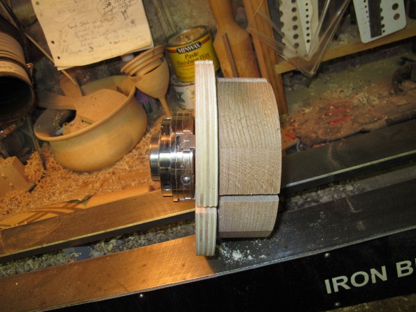

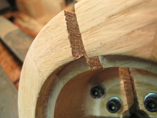

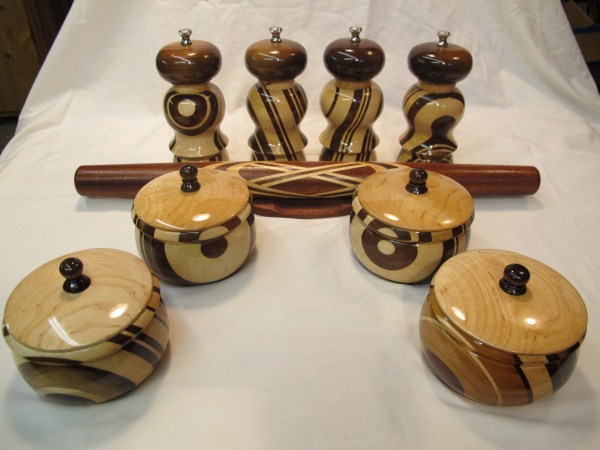

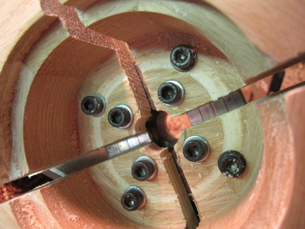

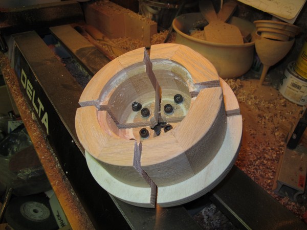

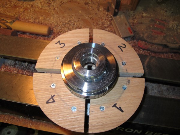

September 13, 201214 yr comment_24114 YOU ONLY HAVE 18 DAYS TO GET YOUR PROJECTS ENTERED INTO TURNING CONTEST. ALL INFORMATION CAN BE FOUND BY CLICKING ON THE WOODCRAFT/EASY WOOD TOOLS BANNER AT THE TOP OF THIS PAGE. REALLY GREAT PRIZE!! Well, finally got a few days in the shop and finished up my pepper grinders, salt cellars and a rolling pin. There were a total of five salt/pepper combinations but one was given as a belated wedding present before this picture was taken. I really need to build a light tent/box to improve the pictures. In the middle of the sanding of these, David Reed Smith's news letter arrived and spurred me to create a better method of finishing the bottoms of the lids and bowls. Previously, they were held with a stationary jig and finished with a random orbital sander. Mr. Smith's newsletter showed various methods of making jigs for round objects. Modifying my Nova chuck, with new jaws, yielded a way to turn/sand the parts more efficiently. A plywood circle and oak jaws. Removed tho metal jaws and screwed the new jaws in place Turned a tapered lip at the outer edge to lock the pieces into place. Made the jaws in one piece, marked the holes, drilled and mounted to be certain every thing lined up. Turned everything flat and true. Turned the lip. Then quartered the piece on the bandsaw to make the four separate jaws. The most difficult part of the build was laying out the holes to match the chuck screw holes. The range of close to open on this chuck is about 3/4" but it is enough to allow both the lid and bowl to be done without separate jaw sets. Here's a link to Mr. Smith's newsletter- http://www.davidreedsmith.com/Articles/ShadowSphereJig/ShadowSphereJig.htm Although his newsletter was illustrating a "Shadow Sphere" turning, there is so much more shown. In one picture, you can see some of his home made hollowing tools and at the end of the article there are quite a few different jigs shown for holding round objects. Safe turning!  Lew Kauffman-Wood Turners Forum HostTime traveler. Purveyor of the world's finest custom rolling pins! Lew Kauffman-Wood Turners Forum HostTime traveler. Purveyor of the world's finest custom rolling pins! Report
