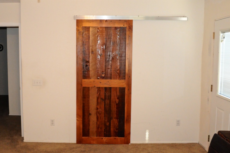

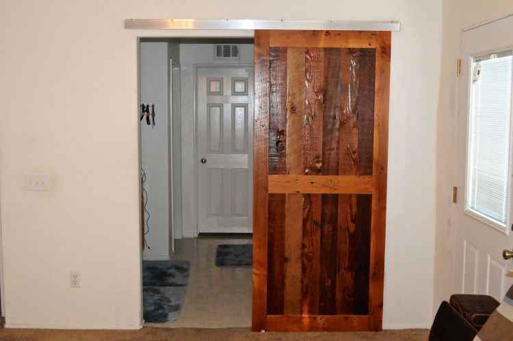

September 14, 201214 yr comment_24011 Today I got the sliding door between the Master Bedroom & Master Bath completed and installed. The door is 36" wide made from reclaimed Doug Fir that came from a building made in the 1800's. The door was given on the front side a seal coat of blond shellac and then 3 coats of "General Finishes High Performance Water Based Finish" in satin. The back side just received a seal coat of blond shellac as it will be painted down the road to match/compliment the bath. The over head sliding door hardware I bought through Home Depot as it was cheaper to go through them as opposed to buy direct from the manufacturer. Here is a link for the hardware that I used: http://www.homedepot.com/webapp/wcs/stores/servlet/ProductDisplay?productId=100658033&storeId=10051&langId=-1&catalogId=10053&MERCH=REC%2d%5f%2dproduct%2d1%2d%5f%2d100658056%2d%5f%2d100658033%2d%5f%2dN#.UFK9tULN7dk The install was really pretty easy to do. The hardest part was just drilling and mounting the hardware to the wall. Once I got my my measurements squared away, I had to find and mark the studs and then drill the holes in the aluminum rail and then attach it to the wall making sure that it was level. Once hung, it was a breeze to get the door into the channel and then do the final adjustments. I will be making a wood valance to cover up the aluminum rail. I do not know yet if I will make it from the same reclaimed wood or if we will use the same trim that we will use for the crown in the room. The door slides very nice and smooth. The most important thing is that my wife is happy. Here is the door in both the open and closed positions. This is the backside from the bathroom. It will be painted when my wife figures out the colors. Â Allen Worsham Corona, CA allenworsham@earthlink.net 'Graze in every man's field, but always give your own milk' J. Vernon McGee Report
