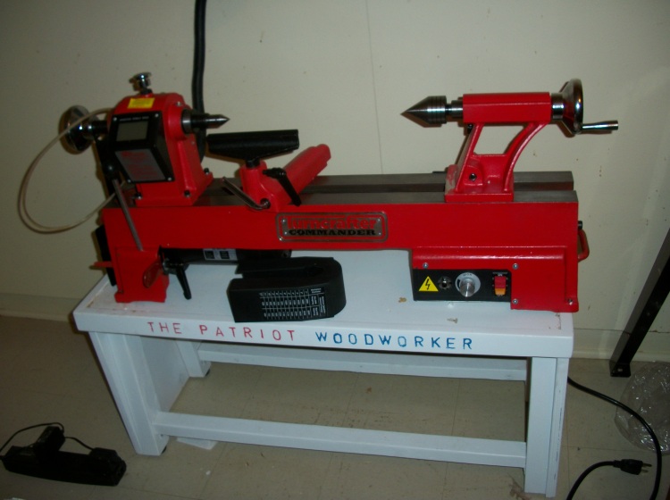

September 16, 201214 yr comment_23838 Ok as most of you may know I am not an electrician so I have what is starting to be a problem The wiring appears to be ok yet there are times where I turn the lathe on and nothing happens. There have also been times that I have turned it on and it hesitates before fully coming on. This is a Turncrafter Commander VS 10" Shown just after being unpacked in 11/11 Basically I am wondering if it's possibly a motor issue or just wiring issue that I don't see and looking for ideas. Charles Nicholls Site Host nicholls61@att.net Proud supporter of The Wounded Warrior Project, Homes For Our Troops and the NRAhttp://www.etsy.com/shop/nichollswoodworks Report

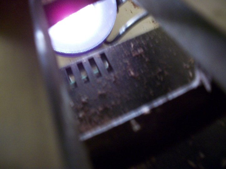

September 16, 201214 yr Author comment_23851 Thanks guys, In this case the motor itself is totally enclosed until you remove screws to take the housing off, so most likely its a control box issue if it's dust causing the problem. Let me see if I can get a flashlight at the right angle to see in there. Well i wasn't quite correct on that, There are openings on the motor, but they are at the rear of the motor, and not exactly subject to direct contact by dust but still will be checked as soon as i can figure out how I am going to be able to get to it. The controller box though ha several access points for dust to just fall into.  Charles NichollsSite Hostnicholls61@att.netProud supporter of The Wounded Warrior Project, Homes For Our Troops and the NRAhttp://www.etsy.com/shop/nichollswoodworks Report
September 17, 201214 yr comment_23850 After blowing out the dust from the switch, motor & controller as best as you can without disassembly. Try turning on the lathe. (If you disassemble the electrical components you may void your warranty). If it still doesn't rotate on it's own then with power still on rotate the head stock and see if it starts. If it runs then it could be motor brushes that are worn down or the motor armature. If it still doesn't rotate on it's own it could be the variable speed controller. With the late turned on try rotating the rheostat (speed control knob) and see if it starts. You could have a dead spot on the rheostat. If you have openings in the motor, try blowing air into them as you rotate the lathe by hand which may help get any dust off the area that make contact with the brushes.Those slots in the controller box are for cooling and should remain open with no obstructions. I clean my controller out with canned air after each use otherwise it gets covered in sawdust and can cause overheating which will lead to premature failure. The components on these controllers are not top of the line parts.Good luck, I hope you get it figured out.  www.thepatriotwoodworker.com Proud Supporter of Homes For Our Troops Report
September 17, 201214 yr Author comment_23849 Thanks Mike, everything turns as expected with no problems other than the not turning on or hesitating to turn on.I did notice that at the front bottom of the control box there are a few slots just like there are at the top, this leads me to believe that I may be able to get a vacuum cleaner head up there to get the dust out of the control box. If that doesn't work, I'll get out the compressed air to try and clean it out. It may be several days before I know if this was successful or not, so I'll post again if any other problems arise.Mike Dillen said:After blowing out the dust from the switch, motor & controller as best as you can without disassembly. Try turning on the lathe. (If you disassemble the electrical components you may void your warranty). If it still doesn't rotate on it's own then with power still on rotate the head stock and see if it starts. If it runs then it could be motor brushes that are worn down or the motor armature. If it still doesn't rotate on it's own it could be the variable speed controller. With the late turned on try rotating the rheostat (speed control knob) and see if it starts. You could have a dead spot on the rheostat. If you have openings in the motor, try blowing air into them as you rotate the lathe by hand which may help get any dust off the area that make contact with the brushes.Those slots in the controller box are for cooling and should remain open with no obstructions. I clean my controller out with canned air after each use otherwise it gets covered in sawdust and can cause overheating which will lead to premature failure. The components on these controllers are not top of the line parts.Good luck, I hope you get it figured out.  www.thepatriotwoodworker.com Proud Supporter of Homes For Our Troops Report

September 27, 201214 yr Author comment_23841 Finally got the switchbox out today, and other than some dust which I blew out, there doesn't seem to be anything else going on in there, although it's mighty crowded in there with all the wiring. I hope it doesn't quit again but we'll see.Charles NichollsSite Hostnicholls61@att.netProud supporter of The Wounded Warrior Project, Homes For Our Troops and the NRAhttp://www.etsy.com/shop/nichollswoodworks Report
