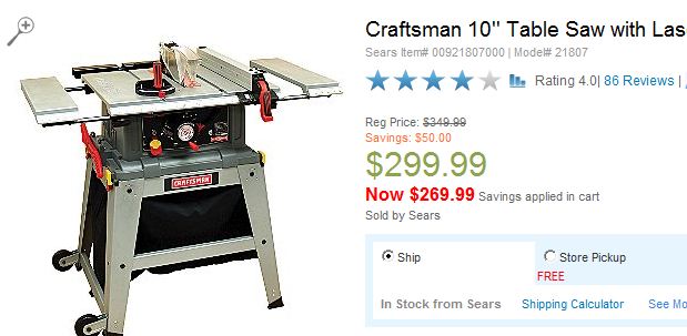

September 18, 201214 yr comment_23780 The best advise I can give is don't be afraid to buy a small saw to start with and then move up as you learn more and decide more what you really want to build. Most of us here don't have the same tools we started out with. As time has allowed and we learned more about things we have taken the direction and deals we found and moved up and built the shop around those. I started with a Sear table saw like the one below and it was 179.99 when I purchased it. Using that saw and a plunge router and a few hand tools I made this pencil post bed. And later the dresser to go with it. I now have a Delta Unisaw and other tools but I grew the shop as I saw what I really wanted to do and what became available. Almost everything in my shop has been purchased used as I got to know other woodworkers doing what I was doing. I bought their piece and they were moving up to an even bigger piece. Not saying it is wrong to buy the best, certainly get the best you can, but you don't have to have the newest biggest to build furniture on. Go look at some nice antiques and those were not built on a 5 HP Delta Unisaw. but many with hand tools. John MoodySite AdministratorJohn Moody Woodworkshttp://www.johnmoodywoodworks.com Report
November 8, 201214 yr comment_23779 If you are uncomfortable with a table saw, particularly the area you need to operate it, then consider a track saw. I own the EZ-1 from Eurekazone.com. You don't need to start with the EZ-1 table, which is much more expensive than the Craftsman 10" table saw. I suggest you start with one of the starter kits which is a length of track, a saw base, and some clamps. This would be about half the cost of the table saw. With a EZ track saw you use your own circular saw attached to the saw base that then rides on the track. You get straight guided cuts, the spinning blade is below the wood (therefore physically separated) from your fingers. This is a great system for reducing sheet goods.. Only drawback is redued thickness of cut due to depth of saw base on the track. Report
