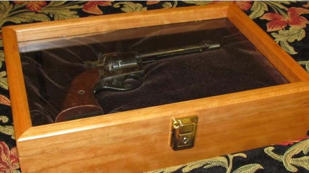

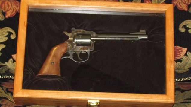

September 24, 201214 yr comment_23594 I know it's popular to bed guns in foam these days but I'm a big fan of frenching. French fitting also offers the box maker some structure to mount the sides and bottoms.This is what I'm referring tohttp://thefiringline.com/forums/showthread.php?t=353946All the accoutrements like extra magazines and rounds also get form fitting compartments Report
September 25, 201214 yr Author comment_23593 Hi Cliff,I've made a few Frenchies. The box in my avatar is one. It's lined with leather.The reason this case will be foam only (except for a box for cartridges and one for cleaning supplies) is that my son hardly ever keeps a particular piece longer than a year. This one is for a 45. Heck, he may trade for a Baretta 9 mm, next month....who knows?If he's ever lucky enough to obtain a sweet old pistol like the one you referenced, then a Frenchie would be in the works.Gene'The true soldier fights not because he hates what is in front of him, but because he loves what is behind him.' G. K. Chesterton Report
