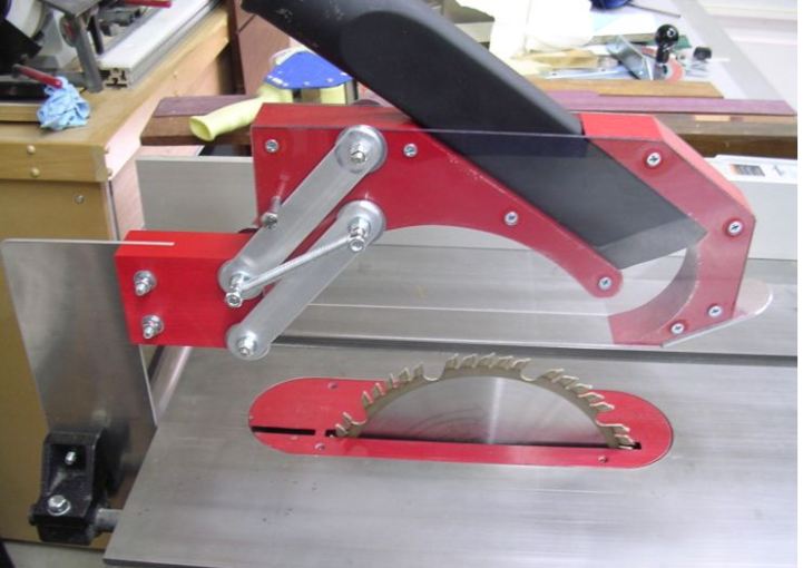

September 26, 201214 yr comment_23368 Awhile back I posted an above table saw guard with dust collection:Â http://www.thepatriotwoodworker.com/forum/topics/completed-tabsaw-blade-guard?xg_source=activityIt works pretty good and the dust doesn't spew out like it used to. I also switched to an HF dust collector with a cartridge filter that filters to 1 micron and has more CFM than my Rockler DC.www.thepatriotwoodworker.com Proud Supporter of Homes For Our Troops Report

September 27, 201214 yr Author comment_23362 I know Mike built a Table Saw blade guard/dust collector. Which by the way if very cool if you haven't seen it. I am just wondering if any of you have any experience with any of the commercial ones or have any others built one to serve as a blade guard and dust collector like this one. I kinda like the ones that stand off to the side but I am sure there are draw backs to it also. By standing off to the side and being suspended you wouldn't have to remove it when making dado cuts. You probably don't need it for those type cuts but it if is mounted on the back you would have to remove it. I just found when I had a blade guard on and had to remove it to make certain cuts, soon it just didn't get put back on. Seemed like it was on and off all the time. Just wondering what you thoughts are on overhead suspended vs mounted guards with dust collection. John MoodySite AdministratorJohn Moody Woodworkshttp://www.johnmoodywoodworks.com Report

October 5, 201214 yr comment_23355 John this guard also has a mount that attaches to a pipe that can be attached to the side, I just made an extra one that uses the splitter. I need to build the arm that attaches to my extension table. It's on my list.John Moody said: I know Mike built a Table Saw blade guard/dust collector. Which by the way if very cool if you haven't seen it. I am just wondering if any of you have any experience with any of the commercial ones or have any others built one to serve as a blade guard and dust collector like this one. I kinda like the ones that stand off to the side but I am sure there are draw backs to it also. By standing off to the side and being suspended you wouldn't have to remove it when making dado cuts. You probably don't need it for those type cuts but it if is mounted on the back you would have to remove it. I just found when I had a blade guard on and had to remove it to make certain cuts, soon it just didn't get put back on. Seemed like it was on and off all the time. Just wondering what you thoughts are on overhead suspended vs mounted guards with dust collection. John MoodySite AdministratorJohn Moody Woodworkshttp://www.johnmoodywoodworks.com Report
