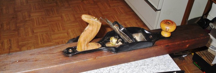

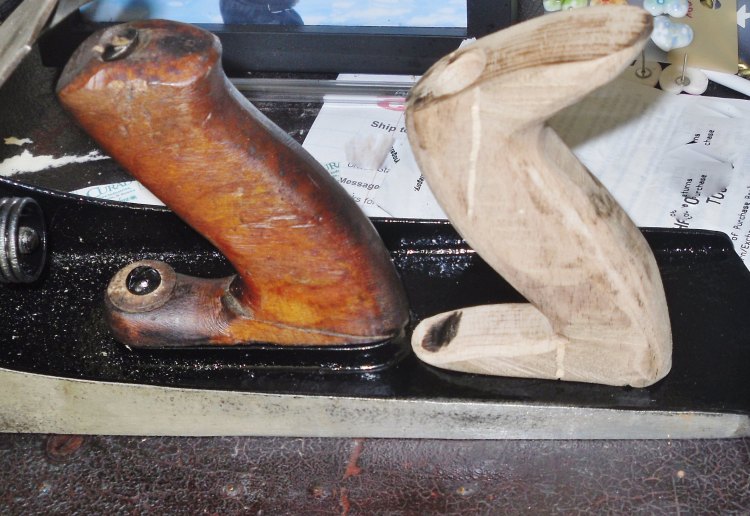

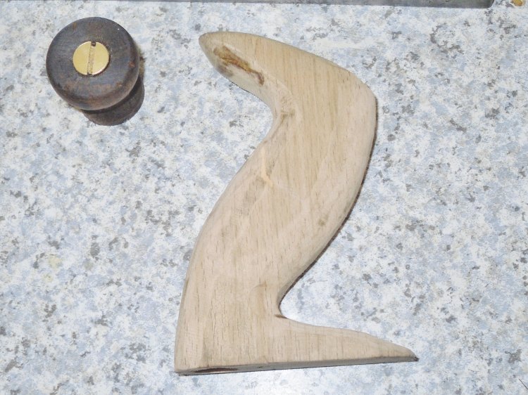

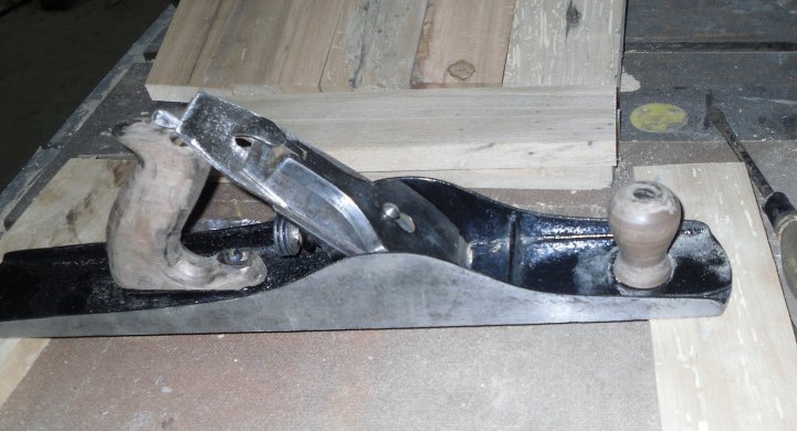

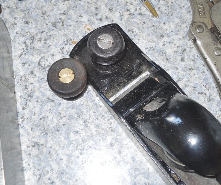

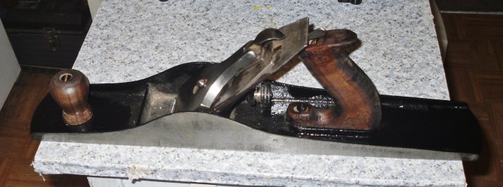

October 1, 201214 yr comment_23189  Ok, first up, I got the 130 look-a-like drilled for a new bolt, old one had rusted off.   New threads were cut with a 1/4" x 20 tap.    I had TWO Sargent style knobs, each with a different bolt in them.     Trying to decide between a Steel bolt, or a Brass bolt...One will go here, the "loser" will go on another "Fulton" block plane, due in this week.    Say, I just might have to thin the herd a bit...and this is without the two that are on their way here.  Ok, next:  I had some old Beech tote blanks out in the barn.  Thought I'd dress one up, into a usable tote for one of the planes of mine.  Drilled, and ground to shape.     Used both a regular grinder, and a belt sander. Still needed a little more sanding.     Sat it on one of the planes...Looks like I will have to make one for this old Savage #6, as well.    Got the tote as smooth as I could, and mounted on another small plane...Darn, looks like I will just have to turn a new front knob as well.   Tote does have one coat of BLO on it, maybe a second or third might darken things up?  Handle is still a might tall, but I can adjust that.   Seems to fit the spot though.. So, back to the main question.   Brass , or Steel?     This will be for that double ended block plane.  Doesn't have a "brand Name" on it, but seems to be made by Sargent.   I have another handle-less block on the way, shouldn't be any trouble to re-handle.   I now have a "Bottoming Tap".   Since I had two "normal" type taps, I ground one into a bottoming tap.   use the regular tap to start, finish up the threads all the way to the bottom of the hole.   Should come in handy.... Sign on pick up truck's back window..:' Save a Horse, ride a Cowboy' Report
October 1, 201214 yr comment_23202 I usually like brass because the warm feeling it gives, whereas the steel is more of a cold look but in this case it seems to go better with the steel than the brassCharles NichollsSite Hostnicholls61@att.netProud supporter of The Wounded Warrior Project, Homes For Our Troops and the NRAhttp://www.etsy.com/shop/nichollswoodworks Report
October 1, 201214 yr Author comment_23201 Looks like i should have made this into a Poll?    Nah, too many Polls out there, right now. I'll give both bolts a try, for awhile.  Now, IF I can just get back out to the Pole Barn Shop, I might get some more handles made.   Lets see, I'll need a tote & knob for that Savage #6, I have a block plane that has a Bakelite blob for a knob, gotta make a Stanely style knob for it, and turn a knob out of beech for that big Trans plane. Maybe an afternoon's work????As for the tote on the Trans #33?Yep, gotts to turn a knob, now.   The two should match, you know.... Sign on pick up truck's back window..:' Save a Horse, ride a Cowboy' Report
October 1, 201214 yr comment_23200 I like the color of the tote, a matching knob really would look great Charles NichollsSite Hostnicholls61@att.netProud supporter of The Wounded Warrior Project, Homes For Our Troops and the NRAhttp://www.etsy.com/shop/nichollswoodworks Report

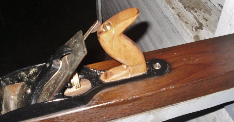

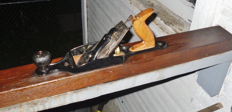

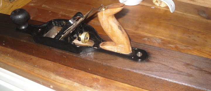

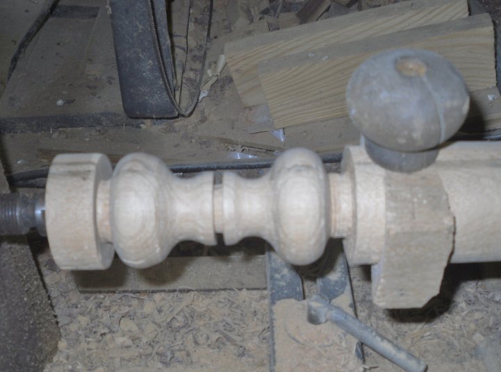

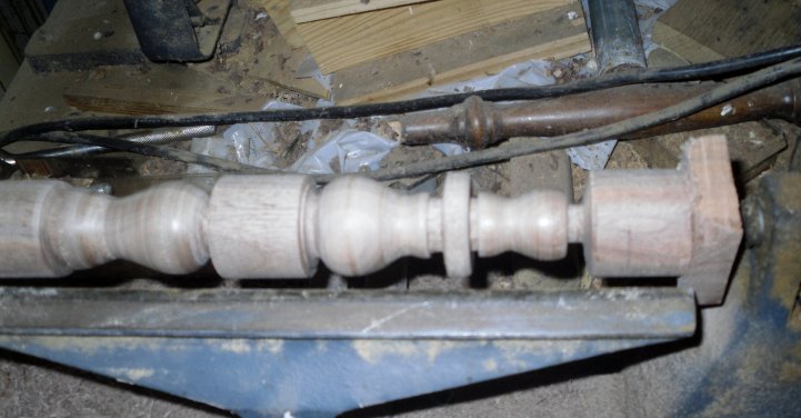

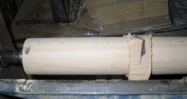

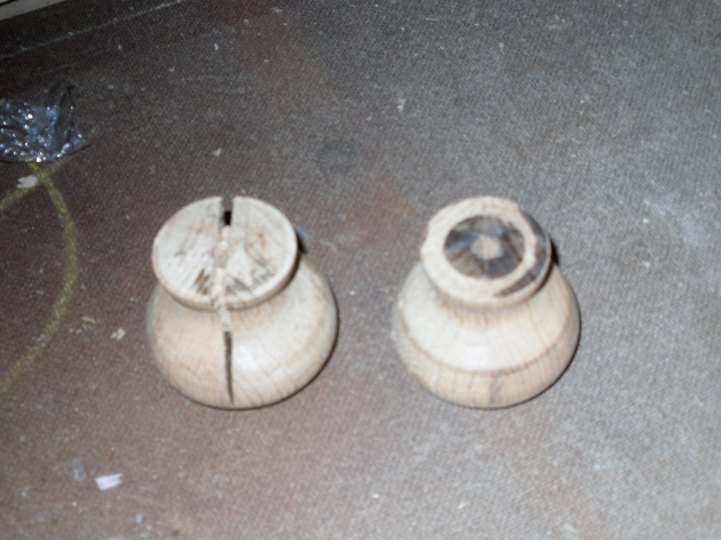

October 1, 201214 yr Author comment_23199 Amatching Knob is on the way, I actually got out to the Pole Barn Woodshop today.  Had to glue up a blank for the Beech Knob.    Gave it a spin on the lathe, AFTER I had marked out where a big old nail was.  You will see a black marker, showing the spot..Next, a little lathe work, and, I always will turn a pair of knobs...Cut them loose, and went to drill them out...and now you see why I always make two.     Hate when that happens.    I have the "good knob in a BLO bath, be back later, with the results.   Make a few other knobs as well, except they were out of walnut...Left to right:  Savage #6 knob, a Union #3 knob, and a Stanley #110/120 knob.  Cut them out, drilled them out ( NO SPLITS, this time) and installed the two larger ones.  Savage #6 also got a new tote!Both of these handles will get the BLO treatment..  Just playing around, making some handles... Sign on pick up truck's back window..:' Save a Horse, ride a Cowboy' Report

October 1, 201214 yr Author comment_23197  Got the BLO done on some handles..Mr. Seth Savage, your plane is ready.   Now both handles match.   BLO STINKS! Sign on pick up truck's back window..:' Save a Horse, ride a Cowboy' Report

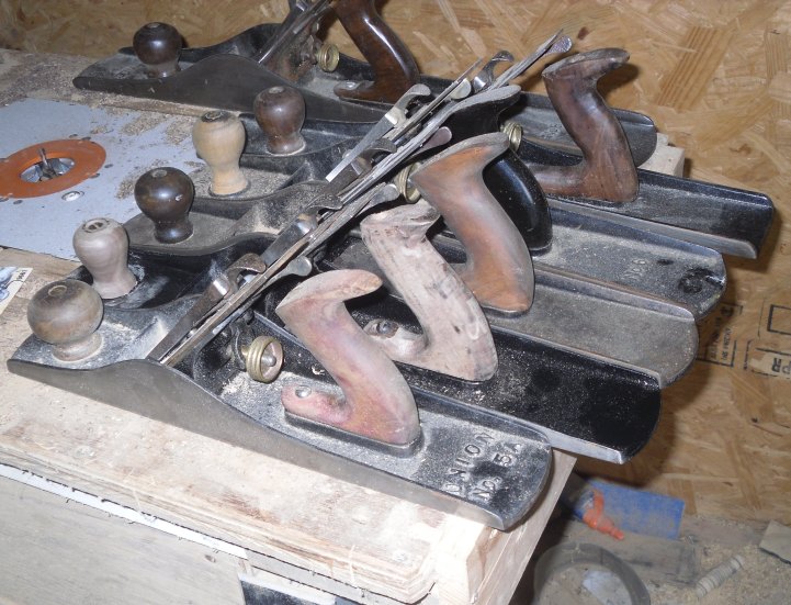

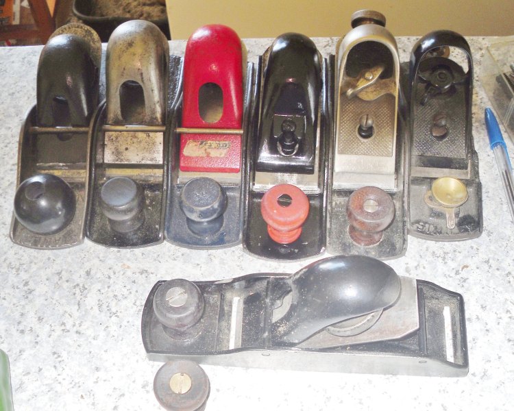

October 2, 201214 yr Author comment_23196  I think i'm getting the hang of making those totes..Six planes, showing their totes.  Only three are stock, the other three were made by me.   Hint, one is a Painted black by Stanley.    The #8c in the back is scheduled to get a new tote.   And the third stock tote??? Sign on pick up truck's back window..:' Save a Horse, ride a Cowboy' Report

October 3, 201214 yr Author comment_23190  Normal toolbox sort of thing.    I have a few Stanley #4s A set of handyman planes, and a set of Union planes.   Working of a set of Sargent Block Planes.    Can't afford Sargent Bench planes, though.  Some planes, I will re-hab, then sell, some I will keep.  The savage #6 will replace a Stanley #6.    The Stanley is a little too new for me, just 60 years old....Sign on pick up truck's back window..:' Save a Horse, ride a Cowboy' Report
