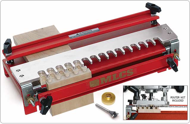

October 3, 201214 yr comment_23011 Here's a site for the ones I use. http://www.mlcswoodworking.com/shopsite_sc/store/html/smarthtml/pages/katana_bits9.htm You also will need a 1/2 straight bit if you do through dove tails. Have you got the jig yet? Depending on which one you get, they'll tell you what bits you need. Gene'The true soldier fights not because he hates what is in front of him, but because he loves what is behind him.' G. K. Chesterton Report

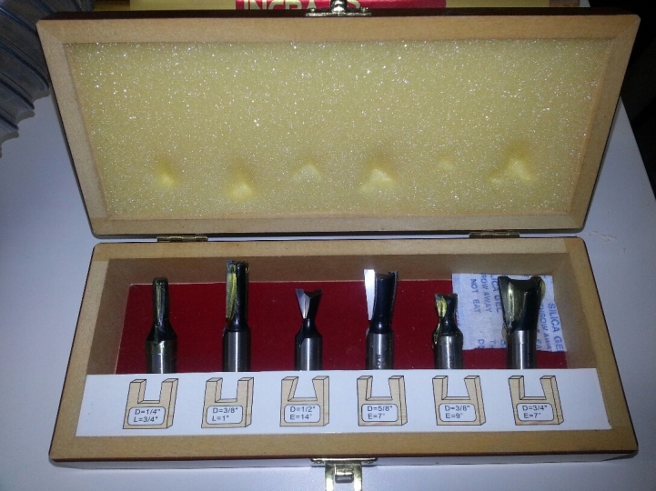

October 4, 201214 yr comment_23006 Wayne this is a set I bought from Rockler for my INCRA jig. The set normally sells for $90.00 but was on sale for $22.00. I'm not sure if they are still available but I couldn't pass it up. I originally saw the set on sale at Rockler and had it in my hand but a gentleman standing next to me when I pulled it from the cabinet said "I was just about to grab that set but you beat me to it" He was in the middle of a project and needed these specifically for a project he was in the middle of. I handed him the set because I was only buying them because of the sale and wasn't quite finished with my router cabinet and didn't need them yet. After walking out I felt good about giving them up but didn't know if I'd ever see that deal again but 3 months later I saw 1 set at Rockler on sale and grabed them and would't let them out of my site this time. www.thepatriotwoodworker.com Proud Supporter of Homes For Our Troops Report
October 5, 201214 yr Author comment_23005 OK I'll just reply to all. I do have a jig and no it not one of your better name/brand one. I bought the one that HF has for about $ 29 bucks.         At the time I bought it was to just practice making dove tails and if for some reason I screwed up and damage the jig it would be of no great loss at least money wise. Maybe just my old pride. I have dragged it out half a dozen or more times over the years and just played with it. As far as dovetail bit, I have one that is 1/2 " in dia 14 degree with 1/4" shank from a set I bought from MLCS years ago.  It has a few nicks from practicing on the jig.  Still I have not master this thing yet but getting there. Now I'm getting caught up on some of woodworking from the list of things my son wanted and needs to go marching on to other woodworking list. My list is rather long and getting longer. Once I master the dovetails I'm looking to toss this jig out the door mostly it sort of funky in setting up and I'll most likely buy the one that MLCS has.  Model # #8706 1/2" shank bits. then buy the each different templates later over time. Wayne E Wayne E Report
