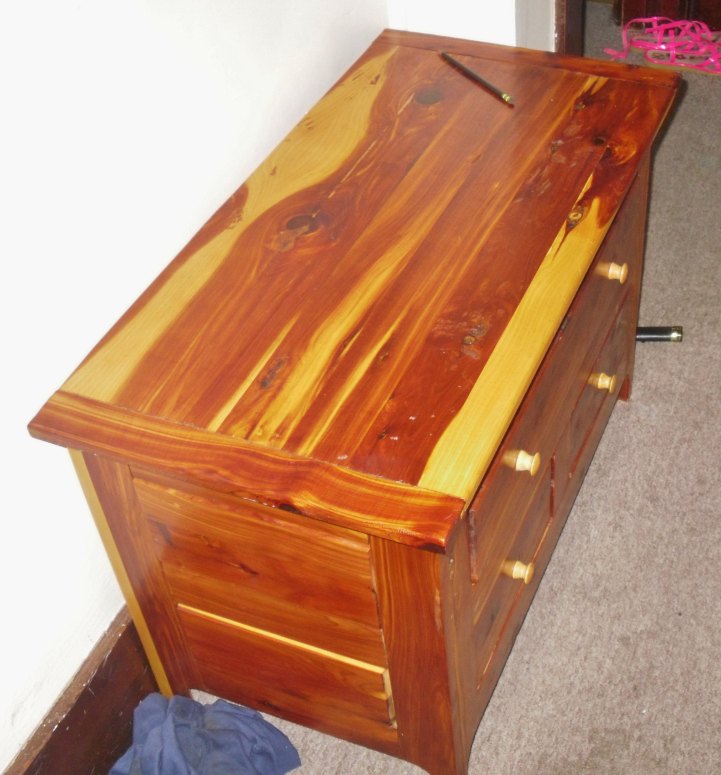

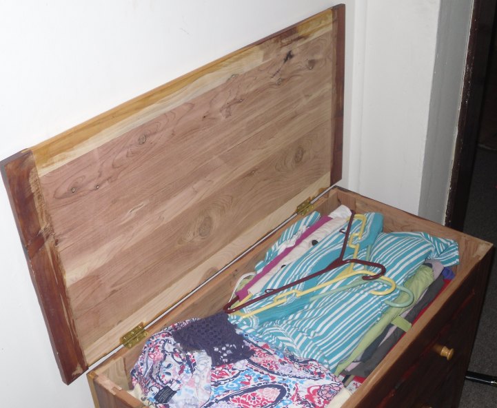

October 21, 201214 yr comment_22290 Three coats ofPoly on the outside, and...Nothing on the inside. Top "Drawer" is a fake, bottom two are real drawers.Used pine forthe inside/outtasite wood. Sign on pick up truck's back window..:' Save a Horse, ride a Cowboy' Report
