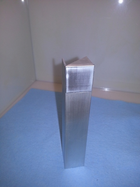

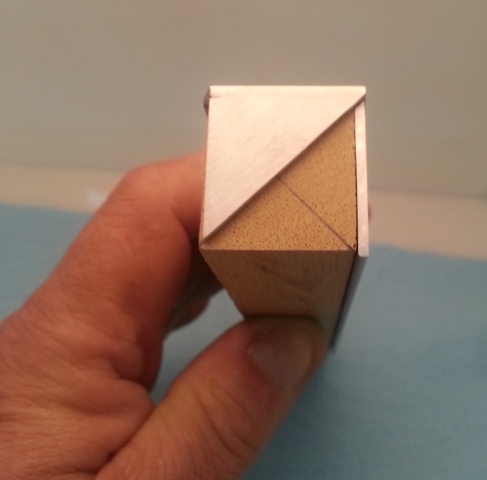

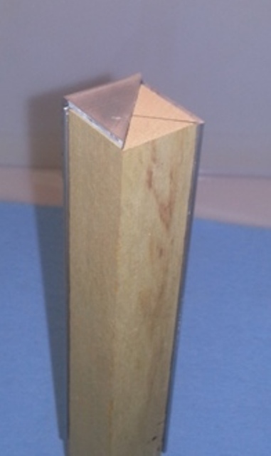

October 20, 201214 yr comment_22277 Ok so I couldn't wait till the morning. It took longer for the 5 minute epoxy to cure than to cut the pieces out. Materials: 1" X 1" X 6-3/4" angle aluminium         5 minute epoxy 1. With a miter gauge set to 45 deg cut a 45 deg angle on one face of the aluminum. I used my table saw but a band saw  would work. 2. Set miter gauge to 0 deg or square and cut the angled piece to 1" in length. 3. De-burr all edges of the aluminum. 4. Place the angled piece over the end of the main body (long piece) and check for fit. Scuff the mating pieces. 5. Apply 5 min. epoxy to the main body and attach angled piece to main body making sure the angled is lined up with the inside bend of the main body leaving enough room for a sharp pencil point. Once everything is aligned, clamp until epoxy is  cured. With a razor blade trim any squeeze out especially on the inside where it may prevent full seating of the blank in the gauge. Tonight I'll buff and polish my gauge up so it's pretty, but you get the idea.         1" www.thepatriotwoodworker.com Proud Supporter of Homes For Our Troops Report
October 20, 201214 yr comment_22276 You can make these things as large as needed, just use angle that has the inside angle at a sharp bend or it could prevent the stock from seating square to the sides of the gauge.Charles Nicholls said:I'd love to see one on the market that is twice that size, say for bottle stoppers. I don't have any trouble finding the center of a straight piece anymore because I have a 4 jaw chuck, but for those that don't it would be cool to have.Charles NichollsSite Hostnicholls61@att.netProud supporter of The Wounded Warrior Project, Homes For Our Troops and the NRAhttp://www.etsy.com/shop/nichollswoodworks Report
