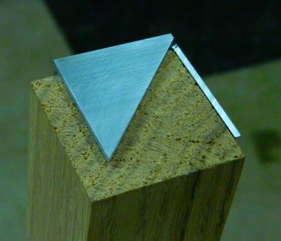

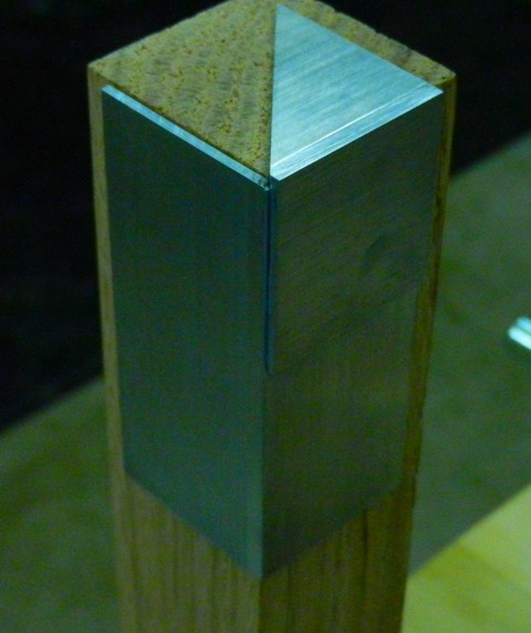

October 23, 201214 yr comment_22147 This is a larger version of the center finder gauge for pen blanks.. Charles was wanting a larger one for marking the center for his bottle stopper blanks. I'll alodine it tonight and get it out to Charles. Charles PM me your address and I'll get it out to you. www.thepatriotwoodworker.com Proud Supporter of Homes For Our Troops Report

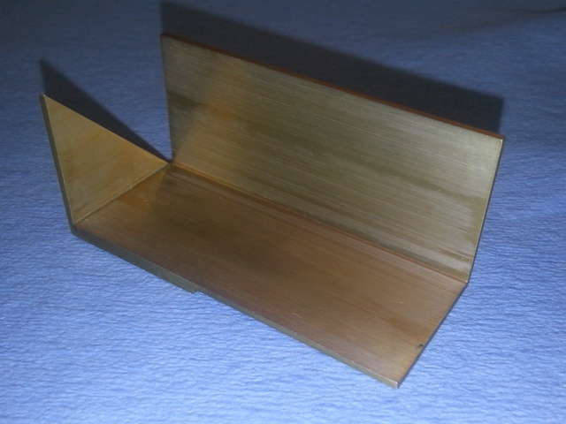

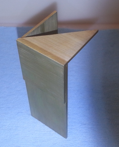

October 23, 201214 yr Author comment_22157 Here is the gauge after alodining. Alodining is similar to Anodizing, the difference is Alodine is a chemical process where Anodizing is an electrical process. They both harden the surface of the metal to prevent corrosion. Aldine is much cheaper than Anodizing. The depth of penetration and the degree of color is dependent on the time the metal is left in the solution. Once the desired penetration is achieved rinse the part in water to stop the reaction process. www.thepatriotwoodworker.com Proud Supporter of Homes For Our Troops Report

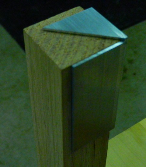

December 1, 201213 yr comment_22148 This particular one works best on 1.25 to 1.5" square stock and it is great I have no trouble getting it to center when I stay in that size range. Charles NichollsSite Hostnicholls61@att.netProud supporter of The Wounded Warrior Project, Homes For Our Troops and the NRAhttp://www.etsy.com/shop/nichollswoodworks Report
