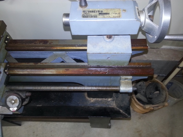

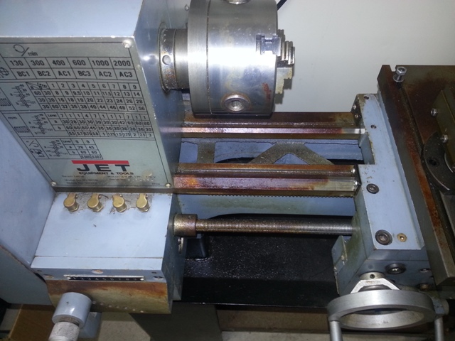

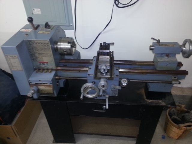

October 27, 201214 yr comment_21955  Yesterday I picked up my Jet BD-920N metal lathe from a friend up in Seattle and got it home. Last night I sprayed it down with WD-40. I was able to get the carriage freed up and some of it cleaned. The main area of concern is the lathe bed. The Ways are diamond shaped and have some rust. The ways are hardened and I don't want to use any acidic based rust remover such as naval jelly, vinegar etc etc.  I have read some reviews and forums discussing EVAP-O-RUST. It's non acidic and and in most cases won't harm the paint. Have any of you guys used this product and what are your opinions? I have also read the use of electrolysis but I don't have a large enough tank for that process. My thought is to use the EVAP-O-RUST and a bronze or brass brush, Scotch Bright and followed up with 0000 steel wool. Also what about Liquid Wrench? The painted surfaces are in great shape with no chips or scratches and only require a light cleaning. It's only the machined surfaces that require rust removal. I think I got this lathe before too much rust damage has occurred. Your input will be greatly appreciated. www.thepatriotwoodworker.com Proud Supporter of Homes For Our Troops Report
October 27, 201214 yr comment_21962 Mike, Try scraping the heavy rust with a single edge razor blade, that should remove the most of it. Follow that up with Scotch-Brite pads and the WD-40. It will probably leave rust stains, but will leave you with a usable surface. It doesn't appear from the photos to be badly pitted, just heavy surface rust. Â Larry Old Woodworking Machinery Forum Host Report
October 27, 201214 yr Author comment_21961 Thanks Larry! I got some straight blades and a blade holder, another can of WD-40 and scotch brite pads and have started the process. I did get a qt of evapo-rust and will soak some of the smaller parts and see how that works but I'm starting with a few bolts as test pieces. I'll let you know how it all works out. Thanks again.www.thepatriotwoodworker.com Proud Supporter of Homes For Our Troops Report
October 28, 201214 yr Author comment_21960 Well Larry I started using your method with the razor blade, scotch brite and WD-40 on the carriage. You can just barley see the carriage in the bottom but it was rusted as badly as the ways are and I was able to get 99.9% of the rust of with no visible pitting present. I ran my finger nail across the surface and felt no catches.Thanks for the great info. You are the Master!www.thepatriotwoodworker.com Proud Supporter of Homes For Our Troops Report
