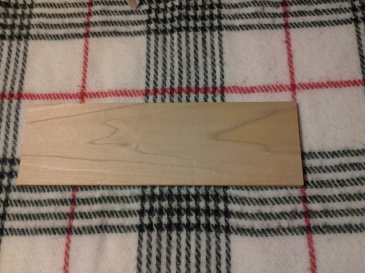

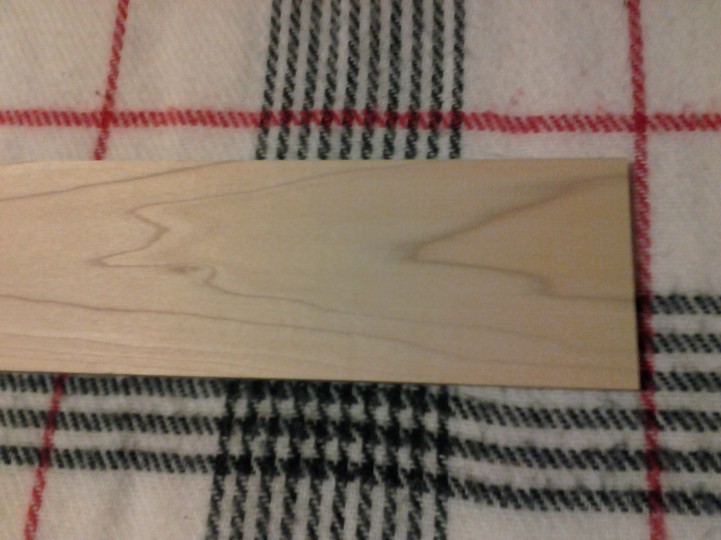

November 11, 201214 yr Author comment_21485 While we were heating up dinner tonight I put a 1/4" piece of poplar in the oven along with dinner. Oven was set at 400. I left the board in for about 25 min. I'm not sure if I needed a higher temp or longer time. The wavy grain did darken up a little. I don't know if a higher temp, longer time or ??? would help make more of a difference. Pictures really don't show too much. First is before and second is after "baking". Just because, I'll try again sometime when the ovens going and I can talk my wife into it, baking the wood, that is! Harry BrinkBulldog WoodworkingMontana Report
November 11, 201214 yr comment_21484 Talked to a couple people that do this some. They said 450 for 20 minutes or so. And once it starts to change it can happen fast. Not tested yet tho. Report
