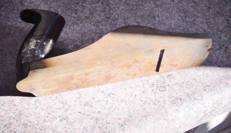

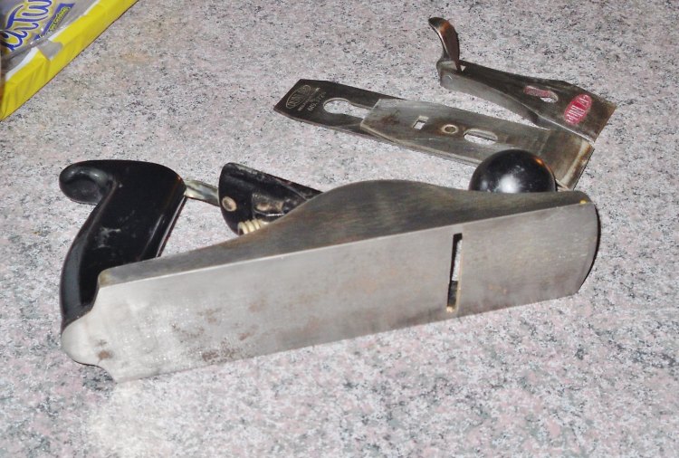

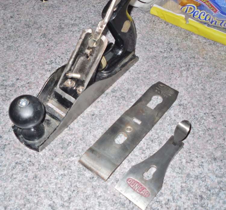

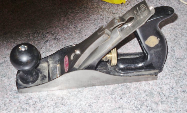

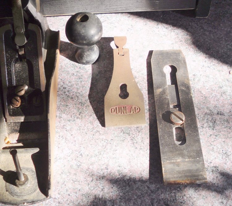

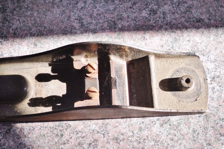

November 17, 201214 yr comment_21192  This little rusty plane arrived this afternoon in the mail.  All the way from Alexandria, LA.   A $6 plane +S&H.    Rusty??just a bit.   I had to replace the bolt for the front knob, someone had "beheaded" it.     Got out the 1/4"x 20 tap, and re-cut some threads in the hole.  Went to the local Lowes, and got a bolt, and a few washers.   Bolt is a #3 Phillips, but it will have to do. Got the beltsander set up, and de-rusted things that needed it.  The sole was kind of bad on this one..kind og pitted, too.   the lever cap needed a good cleaning, iron and cap iron needed work as well.  The rest of the bolts ( that hadn't lost their heads) were chucked into the drill, and polished up.  They kind of needed it...Fired up th H-F "Dremel" and got to cleaning things out.  Iron saw a stone as well. Time to put things back together??Looking any better??still a few pits left, but the sole is flat...Not sure if that is a Dunlap label, or just a price sticker.  Brass got shined up as well.  Handles are a black Bakelite.   Might just keep them, too.    That tote is very COMPFY!!   May touch up the red paint to highlight the Dunlap logo.   this is a #3 size plane.  Iron is a hair under 1-3/4" wide.  May just be a keeper?? Sign on pick up truck's back window..:' Save a Horse, ride a Cowboy' Report
November 17, 201214 yr comment_21195 I think its a keeper. I would keep it. The #3 size is my favorite smoother.Adam Welker Red Car Construction and Fine Woodworking Report
November 17, 201214 yr Author comment_21194  I just checked this #3 Dunlap against another #3 i have.    A Fulton with a West German blade.  The dunlap is almost an inch longer.   It is the same length as my Craftsman #4H.   All three were made by Sargent Tool Co., strange....Sign on pick up truck's back window..:' Save a Horse, ride a Cowboy' Report
November 17, 201214 yr comment_21193 Well worth the 3 hours, I'd say. Yep, she's a keeper.Gene'The true soldier fights not because he hates what is in front of him, but because he loves what is behind him.' G. K. Chesterton Report
