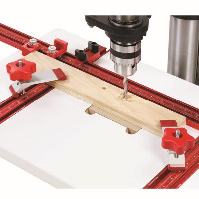

Looking at the one's Woodcraft has to offer (not saying to buy one from them, just for reference only) they have a nice table by Woodpecker that has a lowered fence for drilling right up next to it, and the hold downs are pretty low profile as well. I like this design knowing what I know now.

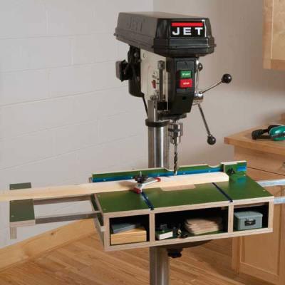

154278.jpgNow that being said, if I had it all to do over again, and I do, and I will, I am going to build my own. I just surfed on over to Woodcraft's plans and saw this one, and it so happens this is exactly what I had in mind for my next one, with storage below.
152824D.jpgI really like the extensions on this one John, and like I said that storage is what I am after as well.
You can even see they too have a tall fence which I just don't get, you don't need it, but they did go as far as cutting out where the chuck ascends into the work piece. You could modify this plan to accommodate a lower fence or cut out as they did.

I like the shop made alternatives. Especially, with storage, I would prefer drawers, though. Things get lost in the back of my cubbies. If you want the capabilities of the Tee Track in the fence, I'd guess the fence would need to be fairly high so the stop would have a bearing surface above the track. The cut out really wouldn't be a bid deal for the added capabilities of a taller fence...JMHO.
One thing to keep in mind if you have a crank is to allow room to use it. I had to cut out a slot in the table for my crank. Since my table extends beyond the crank, the slot doesn't affect the use of the table. Because you'll likely need to cut that slot, you might consider making the storage box less deep so that the table extends beyond the back of the box.

I like that plan with the storage. I also agree whole heartily about the height of the fence hindering your drilling. That is one of the issues that I have with mine.

That is the kind of information I was looking for. I liked the look of the woodpecker that you were showing above John. I also looked at the plans to build the other one. Not that I am cheap and I know I will get what I pay for but the kit for the build your one was over 200.00. The woodpecker was 140.00. Now with that said I do like the idea of the storage.

Surely, one like that, or better, could be built for less than 200 smackaroos. Finding the phenolic ply would be not too easy for me, though.
