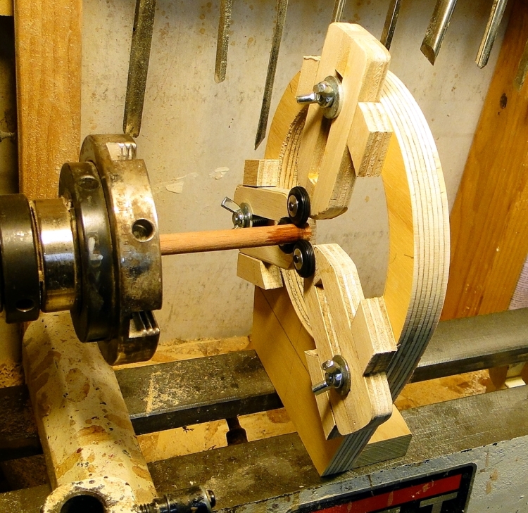

There have been several times I wish I had a center steady for my Jet mini. One was when I made a knitting needle. Jet don't sell one and I couldn't find one. So I looked on the web and got some ideas. I then proceeded to make my own. The prototype worked so good that I need go no further.
The biggest problem I had was finding some wheels. Most small wheels are made of plastic and have no bearings. I located some model airplane wheels at a hobby shop that had aluminum centers and they will probably last me a very long time.
 I have it set up here in the photo for demonstrations and picture purposes only. I have a project in mind where I will give it the full checkout. I like it.ning-dsc05595-20776-1.jpg?width=750

Nice looking center steady Ron. I've got plans for one but just haven't gotten down to making one. I like yours, very straight forward construction.
Most of the shop made ones I've seen use inline skate wheels. The bearings are made to withstand heavy loading and faster RPMs. Sometimes you can get a pair of used ones at the thrift store. Online you can get wheels with bearings in a package of 8 for $30.00, some retailers will sell them individually. Some bike shops sell the wheels as well.

Man that is a neat piece of engineering Ron, great job on the build, the fit and finish look superb.
These wheels are slightly bigger than a nickle, which narrows down the choices. I have seen some small race cars that have hard rubber wheels with bearings. I will keep my eye out for such a car at garage sales. The hobby shop I went to had a large assortment, but the ones I got were the ONLY ones that small and they were less than $3 each.

This is at the top of my "Next Jig To Make" list. I really like the way you braces the wheel holders.  Was thinking about using roller blade wheels but holding small diameter turnings may be a problem for them.

I used my jig today  to support a piece on the tail stock end when I cut it off. It went very smoothly and I was able to cut, sand and finish the end. The only problem was that the rubber tires made a black mark that I had to sand off and refinish.
Doing that was no big deal, but I still am looking for better wheels. If I were to build another for my mini, I wouldn't make it a strong with large pieces. I realize now that it wasn't necessary for a mini, but a larger lathe would require more strength and bigger is better. Overall I am pleased with it and intend to use it a lot.
