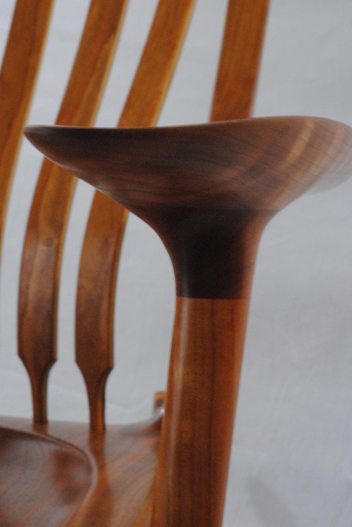

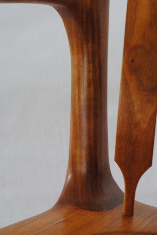

Personally, I clamp the living bejeezits out of every thing. I do not like glue lines at all. Building my rockers I put as much clamping pressure on everything I do. Fine clear lines are a must with zero glue lines. No issues thus far!
There has to be a zero glue line in these joints, I don't know of any other way to accomplish that other then putting the almighty force into the clamping.
Like you I am not fond of glue lined but you don't have to clamp the "bejeezits' out of the wood. glue lines result because for one of two reasons. The primary reason is that the joint was not made correctly and the second is that usually the joint was not clean when the glue was applied. A third reason is that there was not enough pressure on the clamp to begin with. Assuming that none of these reasons apply to your glue lines, then there is a little "trick" that can be used. When making the joint, you slightly cut/scrape,sand the shoulder so that there is a "burr" on the edge - similar to what you put on a scraper.
