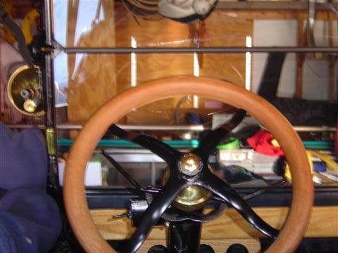

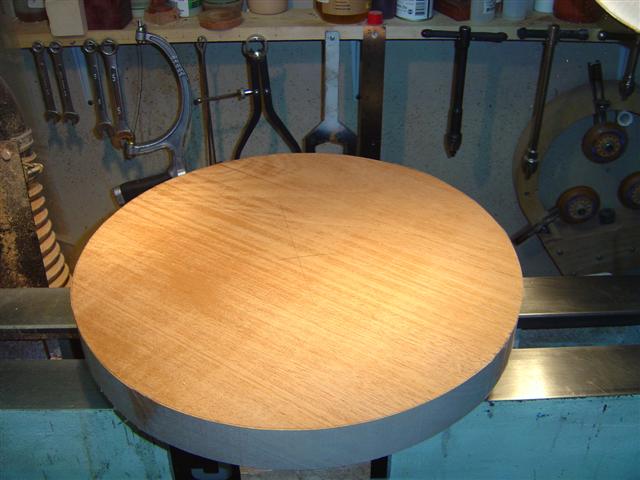

My old wheel was painted black and when I stripped the paint I found a lot of filler. I repainted it black and began looking for a piece of Mahogany big enough. A fellow turner locally came up with a piece of Honduran Magohany 24"x24"x2". A few hours on the lathe and I have a beautiful new natural wood finiah wheel for my T.

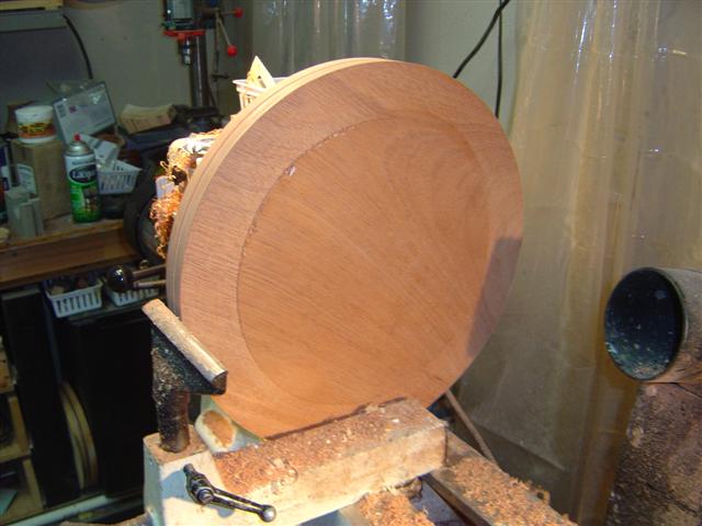

Now the million dollar question, how did you do this on the lathe?
ning-newsteeringwheel2small-20592-87.jpgning-newsteeringwheel3small-20592-88.jpgning-theladyinmodeltladysmall-20592-15.jJohn, After band sawing the piece I turned it on the lathe and you can see in the pic on the lathe that I parted off a ring that I turned 90 degrees and glued the it together. That was to eliminate the possibility of the wheel breaking at the end grain.. I then turned one side of the ring using a plywood template of the old wheel to get the right profile. I turned a tenon on the outside (the piece was mounted on a faceplate) so I could turn it around and turn the other side. I drilled a small hole through the piece to make sure I had the inside of the wheel aligned and give me a gauge for parting off. After sanding and sealing with two coats of laq. sealer mixed 50/50 with thinner. After parting off I hand sanded the inside and mounted the spider. I have removed the paint from the spokes on the wheels and finished them natural.
