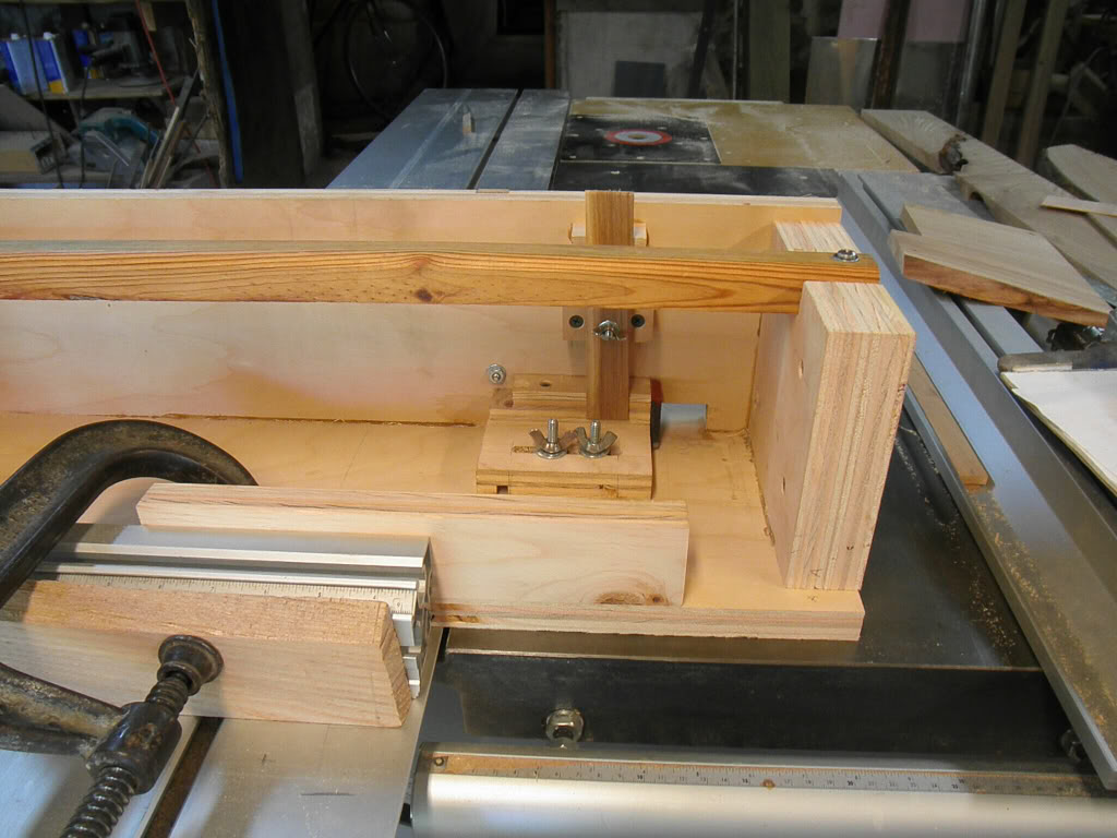

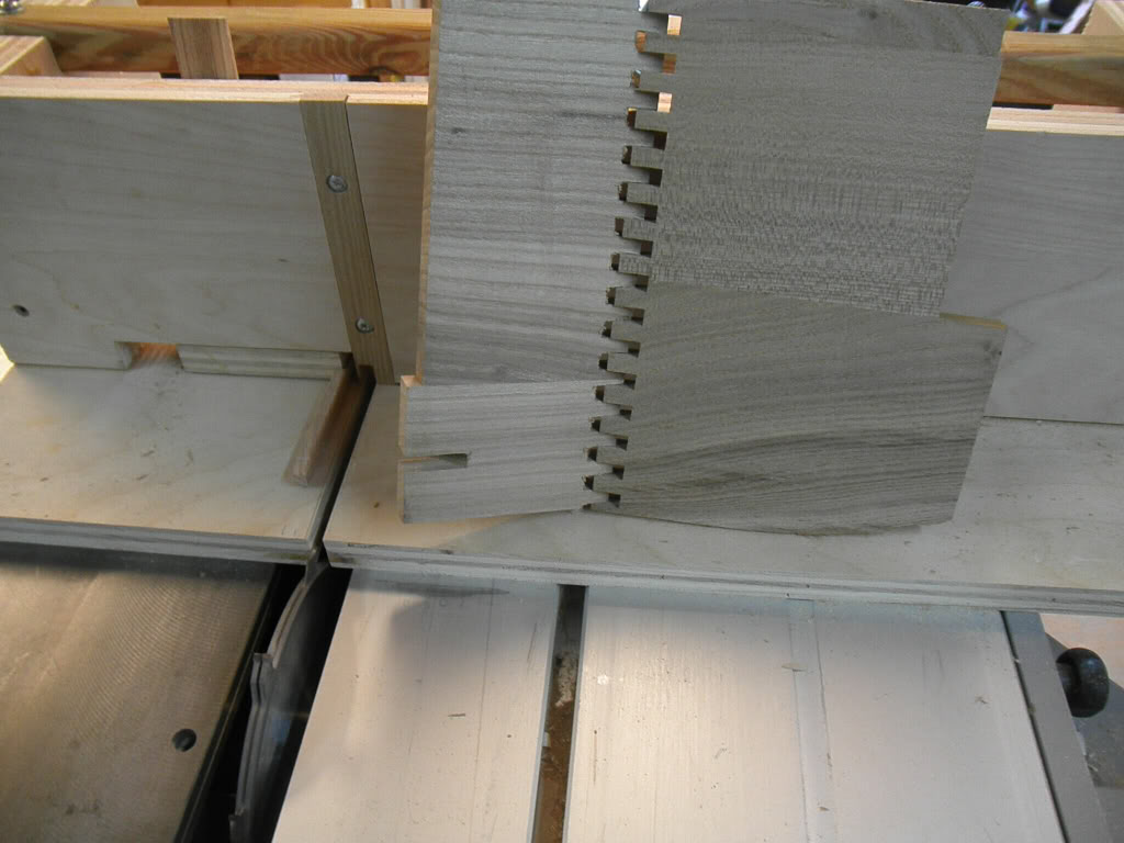

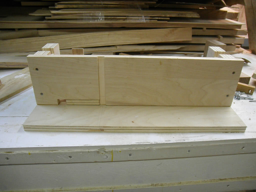

The simplest is also the easiest. A board with a little tongue projecting out   to which you fasten two cleats to run in your table saw slots.  You toss it when done.  Make a new one when you want.

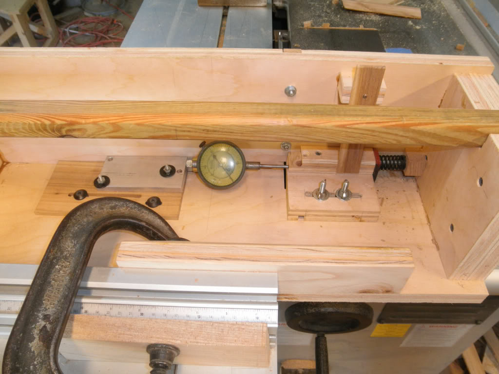

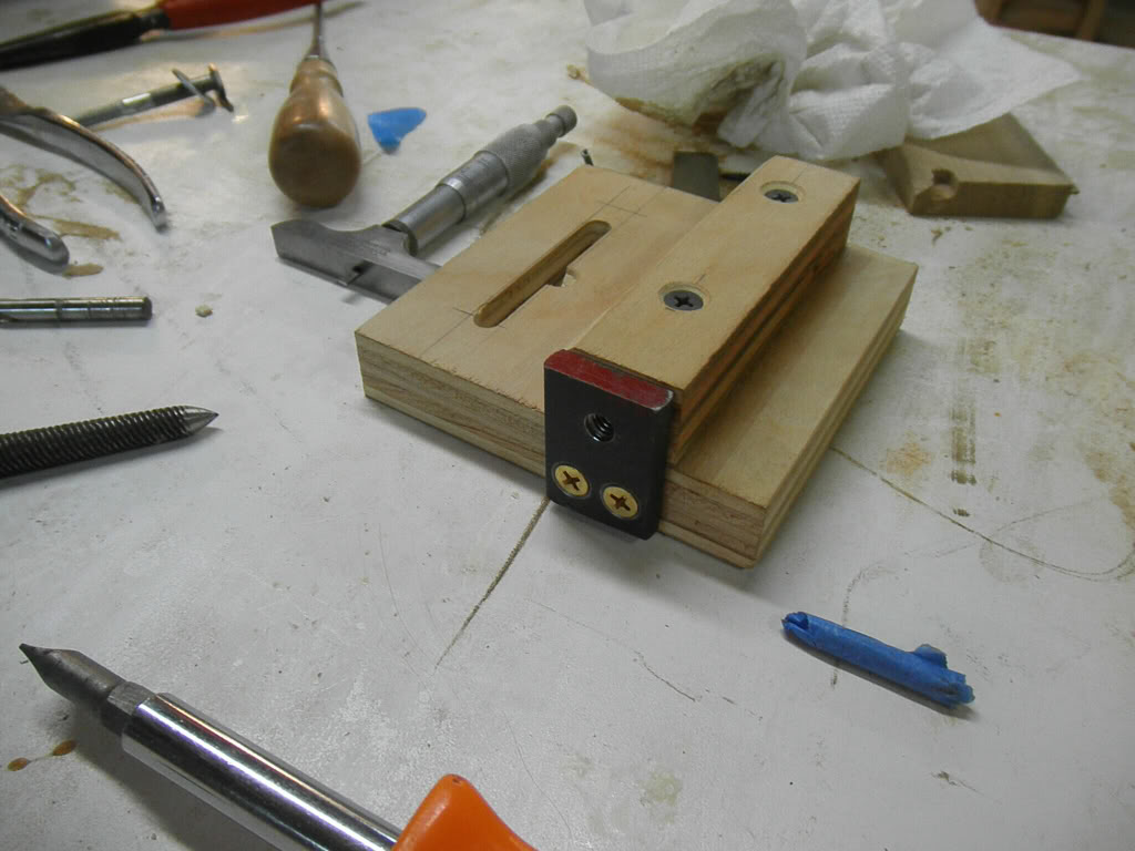

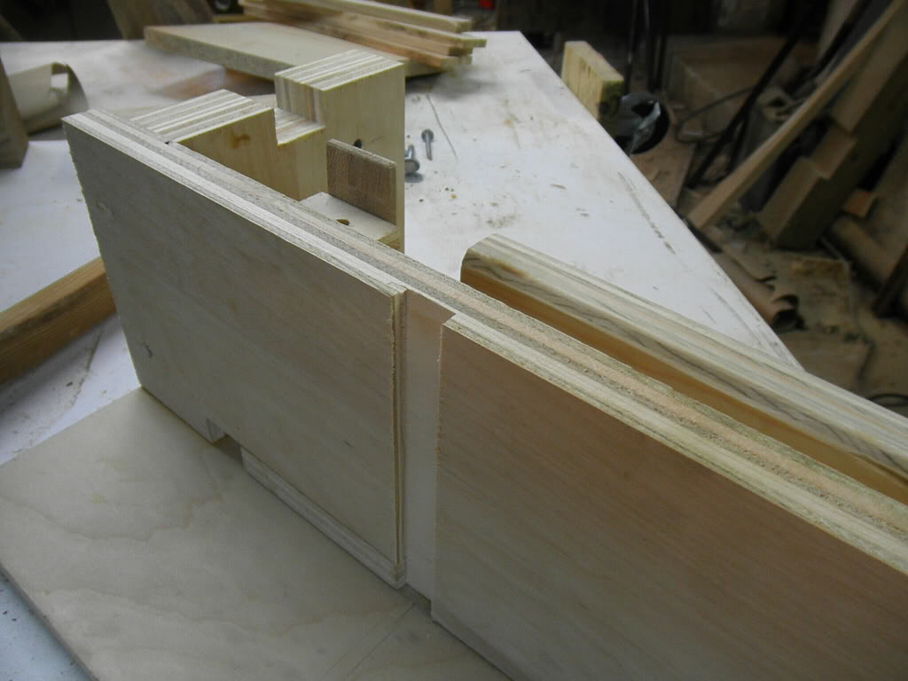

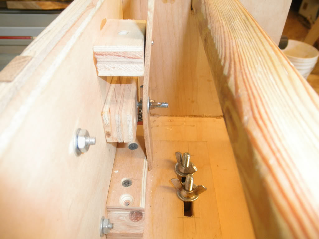

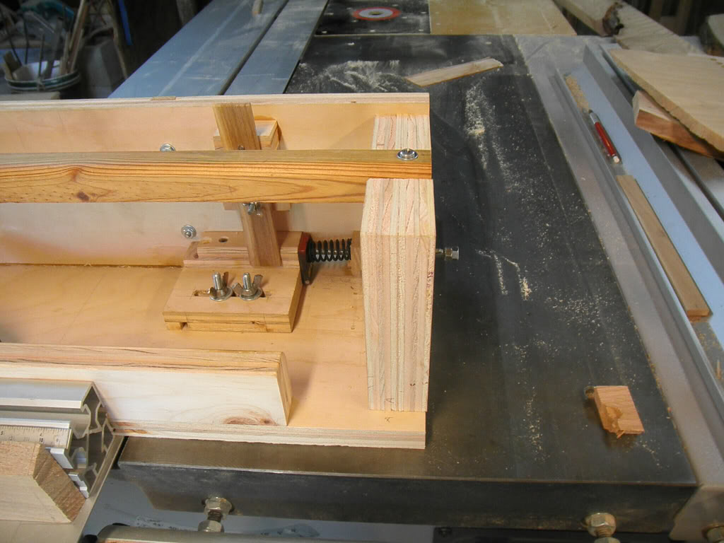

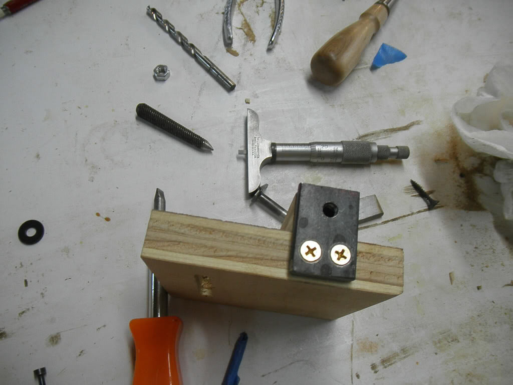

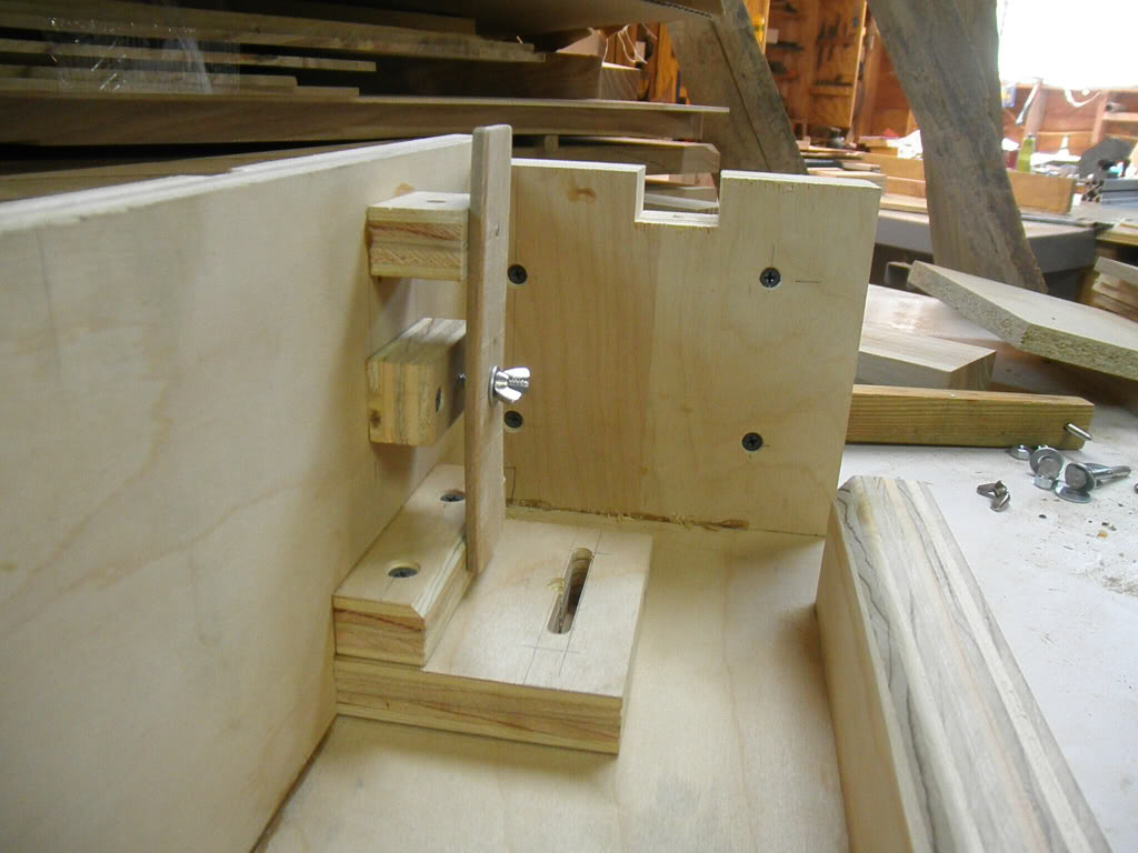

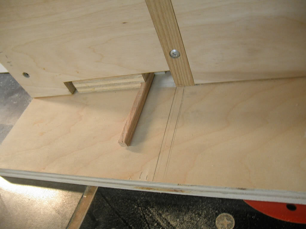

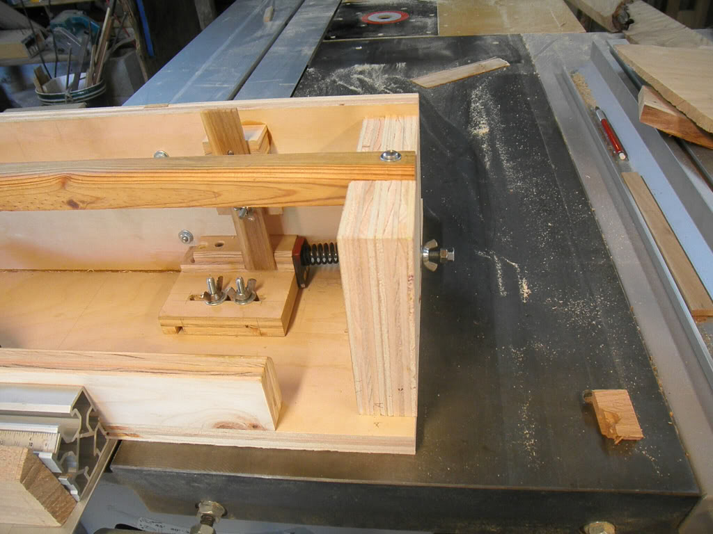

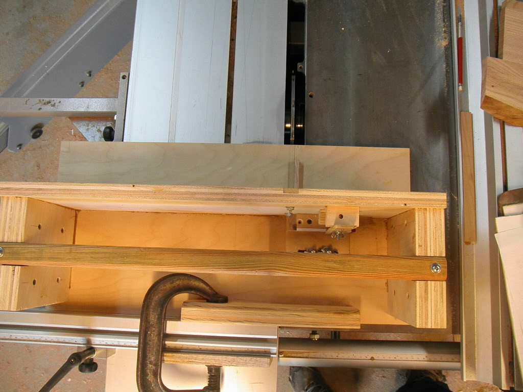

Mine is a tad more complicated.  It's got a removable block to which the   guide finger is mounted which I can replace with fingers of different thickness and height.  It's got a removable and replace-able sacrificial backing plate to prevent blow out.  I can adjust the position of the guide finger infinitely within the range of movement and there is a steel coil spring to prevent back lash and another  spring from wood to keep it squared to the face.
001-ThefinishedJig.jpg002-front.jpg003-Front.jpg004-keyslide.jpg018-Overdoingit.jpg017--KeySlideSpring.jpg016-KeySlideinplace.jpg015-KeySlideinplace.jpg013-KeySlideinplace.jpg012-KeySlideinplace.jpg
And it has removable and replaceable  fingers

For some reason, Your jig pictures didn't show up when I first saw your reply. That's quite a nice jig, Fred!

I think that's Clint's jig. The one I made were the more mundane one-use type. Anyway, that miter runner on the I-box is 3/8" deep (thick) and .74" wide. The Incra miter bars have an expandable nylon washer that takes out any slop in the miter track.
