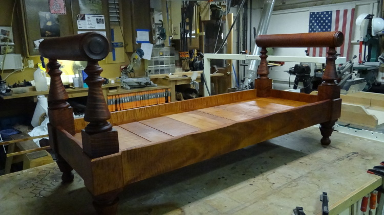

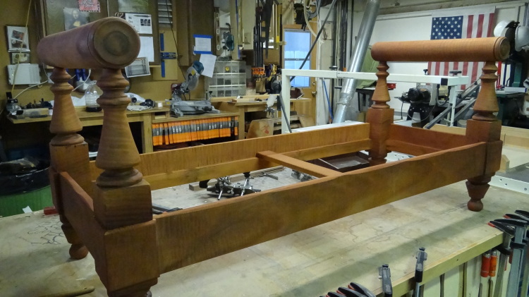

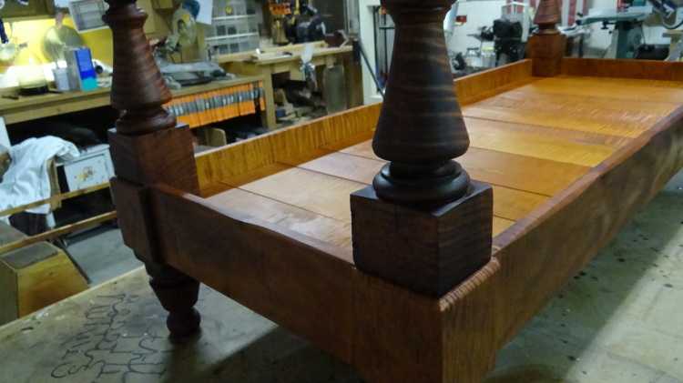

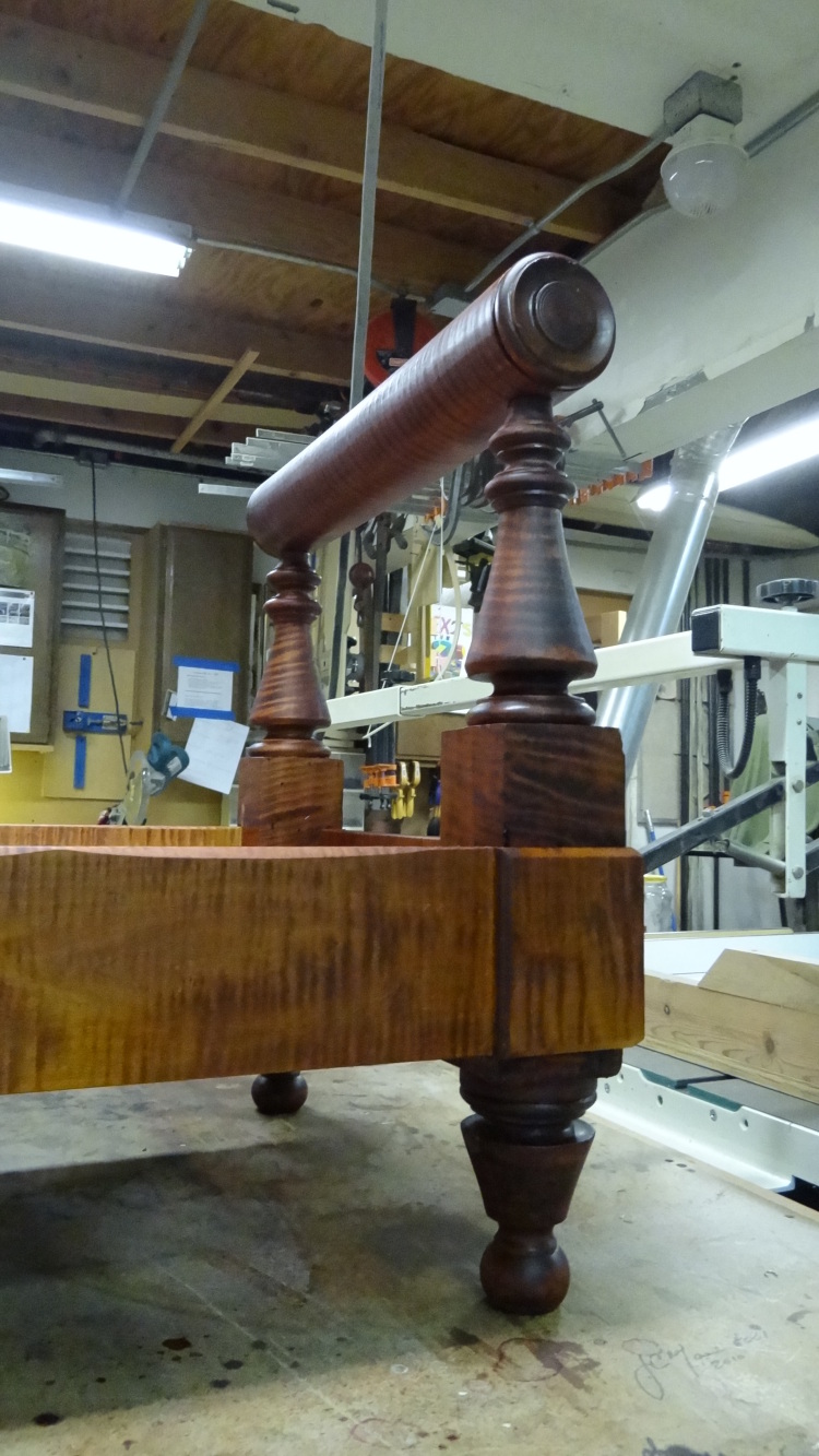

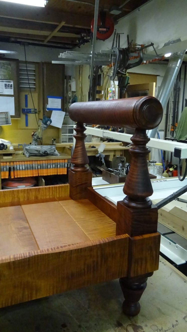

December 8, 201213 yr comment_20191 Some more pics of our progress. I was able to stain the settee this past Thursday, and last night I got a coat of BLO on the settee. I am happy with the color. In the photo the older vertical turnings and arms appear to be darker, but in reality, it is a great match, I think the flash just brought out the darker underlying patina of the 200 plus year old posts and arms. To see the running progress of this project please click on the following links: Curly Maple Settee Part 1 Curly Maple Settee Part 2 Curly Maple Settee Part 3 Curly Maple Settee Part 4 We used Homestead Transfast Early American Maple Dye It's amazing how horrible this dye can look upon application, yet after it dries it all evens out. Below is a contrasting shot of how the grain and stain comes alive after an application of oil. In the shot above, that vertical light line running down the post is the over head lighting, not a blemish. Below shots the oil is fully applied and allowed to soak for 20 minutes and wiped off, back to a slightly drab look, until we get our first coat of varnish applied. Thanks for following along folks! John MorrisThe Patriot WoodworkerProud Supporter of Homes For Our Troops and Wounded Warriors Project Report
