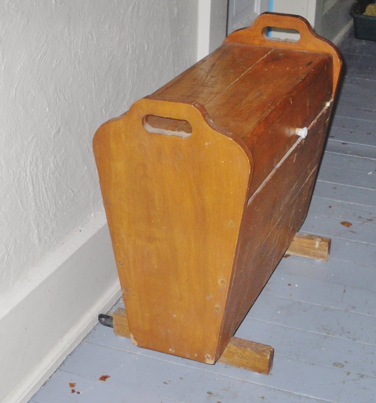

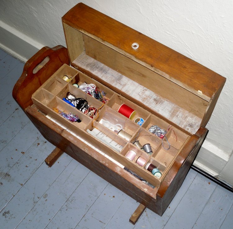

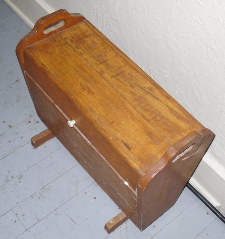

December 22, 201213 yr comment_19454  Back in the early 80s, the "Better Half" decided that I should make a sewing box.    So, I gather a few scraps of Oak, a few chunks of 3/4" plywood, and some other "junk" and set about to build it.  She also wanted a tray inside for sewing supplies, so some 1/4" Luann was added to the pile of scraps. Oak scraps for feet. The hand holes were made by squishing a roll of masking tape down until a nice shape for my hand to fit through appeared.    Drawn out on the plywood sides, and sabresawn out.  Plugged the screw holes, and used an old Stanley #110 to level the plugs out. A little plastic knob.  Two Oak boards from a pallet for the top, two more for the sides.   Not really a glue joint either...as the ends ( hidden) do all the work. Just some 1/4" luann, again.   Screws are into each oak board.  Like the tray?    A real PITA to make, lots of slots to cut.  Then try to get them ALL to fit into a "box" then add a bottom.  Tray sits on a pair of oak cleats, screwed in place.  Can't remember the stain flavour, might have been a "Golden Oak".   The "Better Half" was happy!    That is all that counts.   Getting close to 30 years old, and holding up.....decently.... Sign on pick up truck's back window..:' Save a Horse, ride a Cowboy' Report

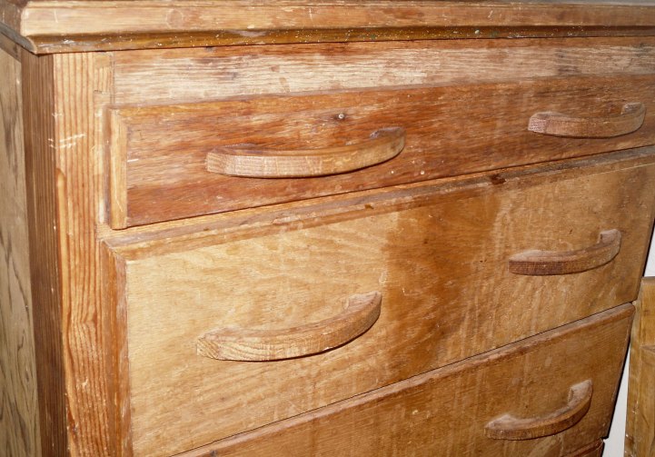

December 22, 201213 yr Author comment_19456  Seems I stil had some plywood left over.   Needed a small, four drawer dresser, just enough for a small TV to set on.   It is starting to show it's age ( so am I ) but still holding together..I think it has 2x4s for corner posts, some 3/8" thick luann ply for the sides.   Drawer fronts are screwed to drawer boxes.  Drawers are 3/4" thick Oak plywood.  Handles were bandsawn, using that masking tape "jig" and then adding the outside curves.  Plywood fronts are wrapped with solid wood.  Just a weekend project to clean out the scrap bin.. Sign on pick up truck's back window..:' Save a Horse, ride a Cowboy' Report
