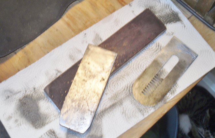

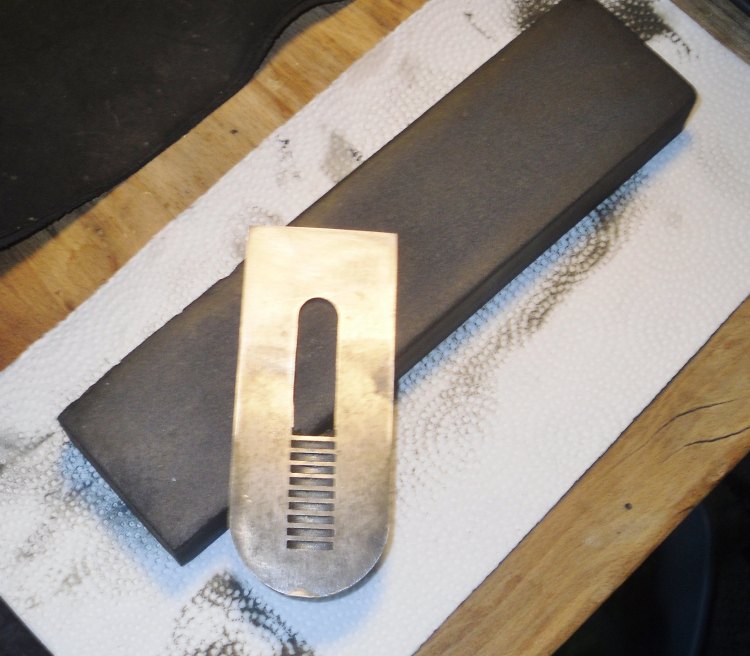

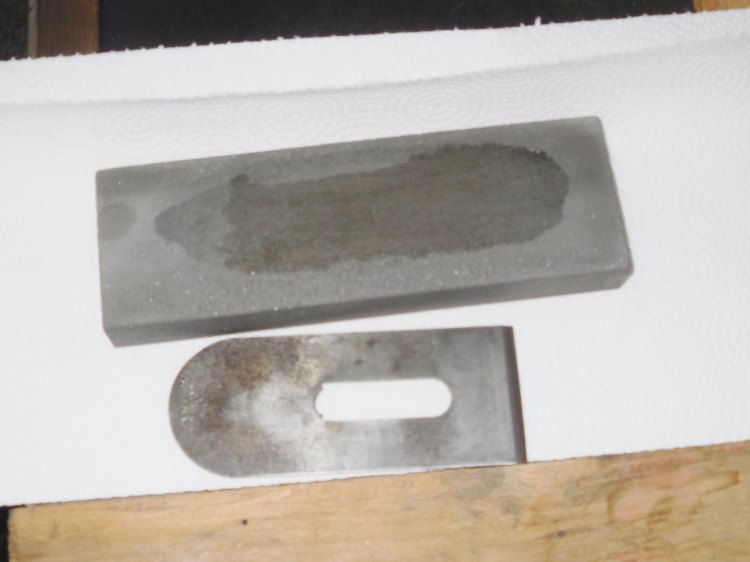

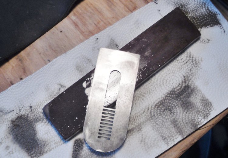

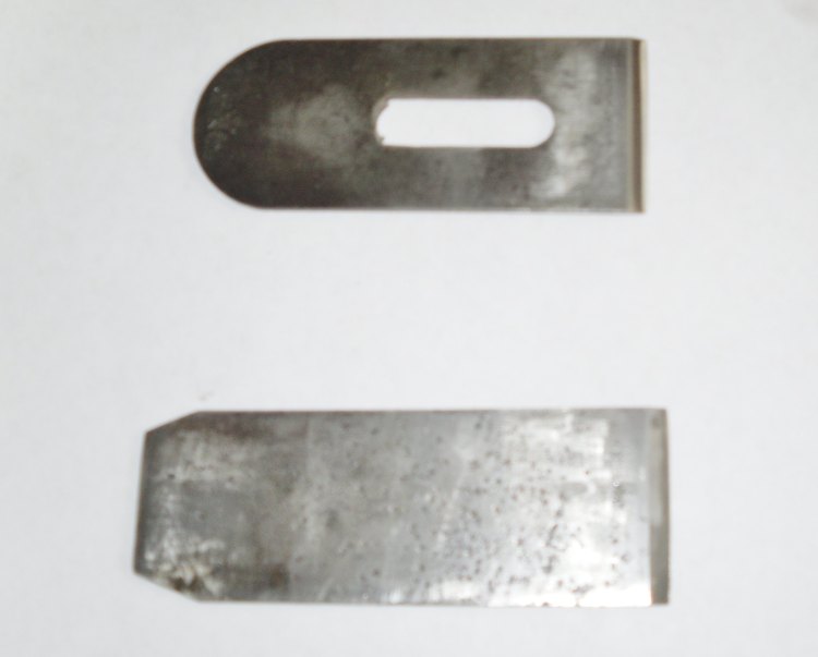

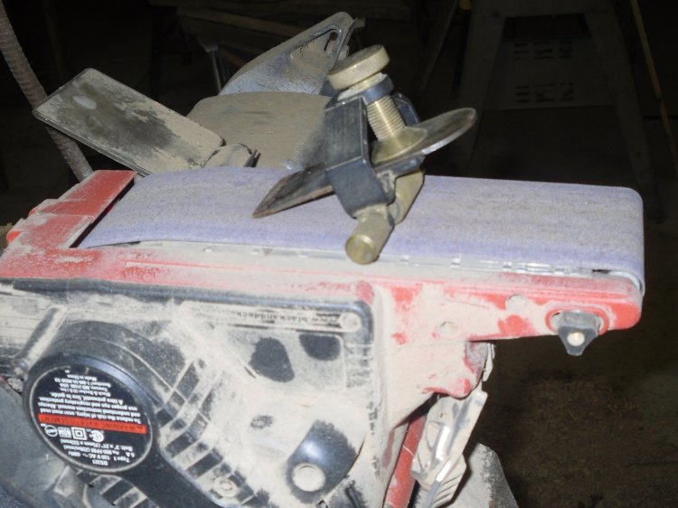

 Started out down in the Dungeon Shop.    I had a pair of block plane irons that needed a bit of work. So, first off, a ride on the belt sander..ning-sdc12313-19064-66.jpg?width=750then back up to my computer desk and a few oil stones.    The sander was just to flatten the backs, and at least get a good start on a 25 degree bevel.  ning-sdc14017-19064-77.jpg?width=750here is the backs, andning-sdc14018-19064-60.jpg?width=750the bevels.    First up, a cheap Buck Brothers oil stone i got last year at Home Depot ( $3-4 maybe)ning-sdc14019-19064-17.jpg?width=750A load of oil.   I used 3-in-1 oil.   I ran both irons through both sides of this oil stones.  I even touched up the area right behind the bevel.   Next, another oil stone...ning-sdc14020-19064-1.jpg?width=750The iron shows the results of the first stones.   This next one I have had for a few decades, have no idea where I even got it.   The coarse grit side on this stone is finer than the "Fine" grit on the BB stone.   I ran both irons over both sides of this larger stone.  I use a fingertip right at the center of the edge. Part on the edge, part on the stone.   I check for any gaps that way,  fingertip gets a bit oily though.   I also wipe down the irons after each step.  Ok, one more stone to go...ning-sdc14021-19064-26.jpg?width=750If you look closely, you will see a lighter purple showing up.  That is what this stone look like dry.   When nice and oily, it is a deep purple colour ( a stone named after a rock band??)  Have no idea what grit this is, but it is a finer grit than any of the others.   Again, iron shows the results of the last stone used, and the results of this stone?ning-sdc14022-19064-81.jpg?width=750Even that pitted old Sargent iron looks better.  So much better, I had to try it out on some of that nasty, contrary "Oak" ( Hickory??) down in the dungeon.   So, installed the iron back in its "home" adjust with a special hammer...ning-sdc14023-19064-83.jpg?width=750Gentlemen, we have .....Shavings!    The plane is a Sargent clone of a Stanley #130.    The hammer?  Just a mutt.   After all this sharpening work, time for a ning-sdc14010-19064-65.jpg?width=750NYTOL  ZZZZZZzzzzzzzz

 Well, nap is over.    I might try some bench plane irons later.    I have about four more block plane irons to re-fresh.  Doesn't take long for each little iron, IF they are flat, and the bevel is started right.   By the time I get to the last stone, it is about 2 minutes per side, plus a follow up per side.    I follow up each step, just to keep the stones from getting "dished" .    By follow up, I mean a few side to side, full width of the stone, with the back of the iron.

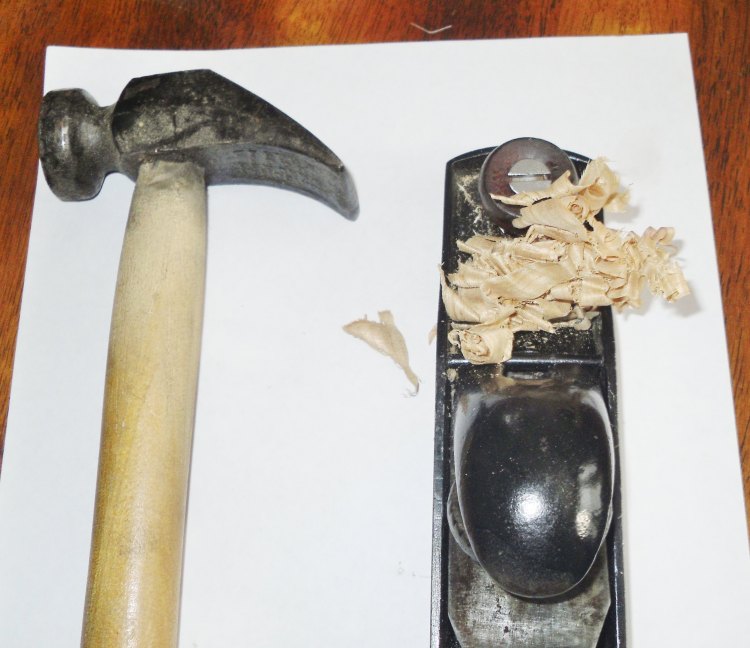

On that #130 clone:   Before I could set the iron in place, I ran the base across the belt sander to flatten the sole, and realign the sides to the sole @ 90 degrees.    I also sent the cap iron to the sander.   Seems it had a "hollow" in the middle of where it met the iron.    That MIGHT make things chatter a bit.     Got rid of the hollow and no more chatter marks.   Amazing.

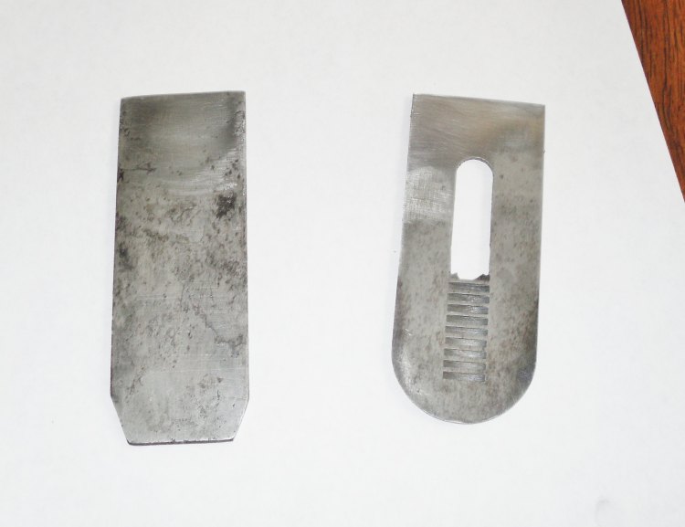

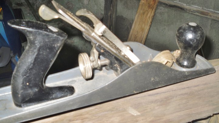

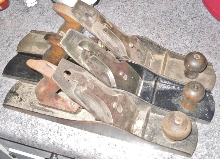

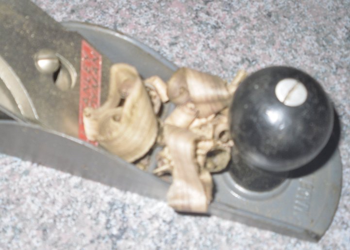

Got out the next iron to be sharpened up.  A stanley #H1205 Handyman iron ( says so, right on the iron)  for a Handyman #5 Jack plane.     Skipped the first two grits ( the Buck brothers stone) and got busy with the last two stones.    back shines like a mirror now, and the iron doesn't do too badly in the old Oak/Hickory(??) down in the Dungeon....ning-sdc14029-19065-76.jpg?width=721Striped shavings???  A look at this old Jack plane, and the block of wood...ning-sdc14028-19065-67.jpg?width=721 Next up?  Well, I am going to "Supersize" things a bit...ning-sdc14030-19065-32.jpg?width=721 A #5A ( 5-1/2 size), a Savage #6, and a Union/DE #6c.    Narrowest irons are 2-1/4" wide.
