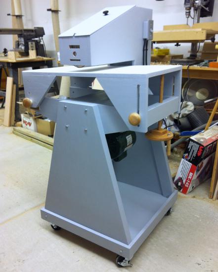

January 6, 201313 yr comment_18830 I know you guys think I must have a "man crush" on Matthias Wandel but he's come up with another example of a user built machine. Wish I had seen this before I made my sander. http://woodgears.ca/sander/open_frame.html Lew Kauffman-Wood Turners Forum HostTime traveler. Purveyor of the world's finest custom rolling pins! Report

January 8, 201313 yr comment_18836 That is a great looking sander. I like the idea of the bed moving up/down instead of the sander component. Easier to make sure you are exactly parallel which I cannot adjust on my Jet 16-32. It drops down at the outside end. How are you attaching the "sandpaper"? Phil Report
January 8, 201313 yr Author comment_18835 Phil,Actually, I did not build this one- but wish I had! I like the open end design. I think the author used Hook-and-Loop but I don't know what method he used to secure the end tips. It isn't really clear in the article. Phil Rasmussen said:That is a great looking sander. I like the idea of the bed moving up/down instead of the sander component. Easier to make sure you are exactly parallel which I cannot adjust on my Jet 16-32. It drops down at the outside end. How are you attaching the "sandpaper"? Phil Report
January 8, 201313 yr comment_18833 ahhh yes cute little Matthias.One wonders whether he is all alone in the world save for the internet and his video camera.Is there a missus Matthias and a collection of little tiny Matthiai running around under foot?Yes Lewis he uses hook and loop. That particular method is nice because it goes on and comes off easily. It's less than perfect though. As the drum spins the roll literally expands as the centripetal force throws the hook & loop to their outer grab limits. This creates a nice cushion which helps reduce the need for lots of horsepower but also allows the abrasive to deflect up and around small hard spots in the wood being sanded, like knots and such. I suppose repeated passes deals with this more or less.I ran a monster sander the likes of which spoiled me for life. It was almost 6 feet wide and had a mechanical conveyor belt made of steel with a GoZillion little pads of rubber upon which the work sat and three sanding rollers with hold down rollers on either side of the sanding rollers. You'd load the rollers with three different grits and the work would come out just perfect. Report

January 12, 201313 yr comment_18831 Along the line of shop built sanders here is one that takes the cake. It's a sander AND a 20" planer and yes children it is shop built: http://www.woodsolutions.com/planer-sander.htm This guy http://woodgears.ca/reader/walters/drum_sander.html Tried to use a Wide Belt sanding belt as a feed conveyor. Those things have to be under enormous tension and stretched a little to track true.   Plus he wasn't using shafts in his rig that were any where near thick enough to do the job. Those little things deflected like gangbusters under any appreciable load.  McMaster Carr has conveyor feed belts that you can put together with hammer lacing (which falls below the surface of the belt so it won't interfere with your work). Just go to the McMaster Carr site ( http://www.mcmaster.com )and input in the search box: CONVEYOR BELT and you'll get a page with everything you might need for making a conveyor feed system. However there is one thing that a straight line drum sander can't finish well: Face frames. They have members assembled at right angles so your straight line non-oscillating sander will always make a mess of the right angle members. Of course the thing will do a fine job making the parts flush so you can finish-sand by hand and be OK. Report
