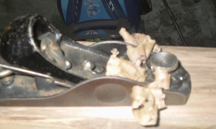

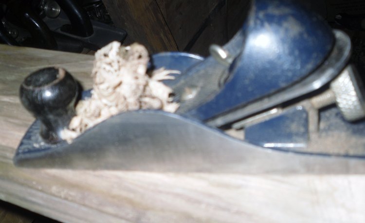

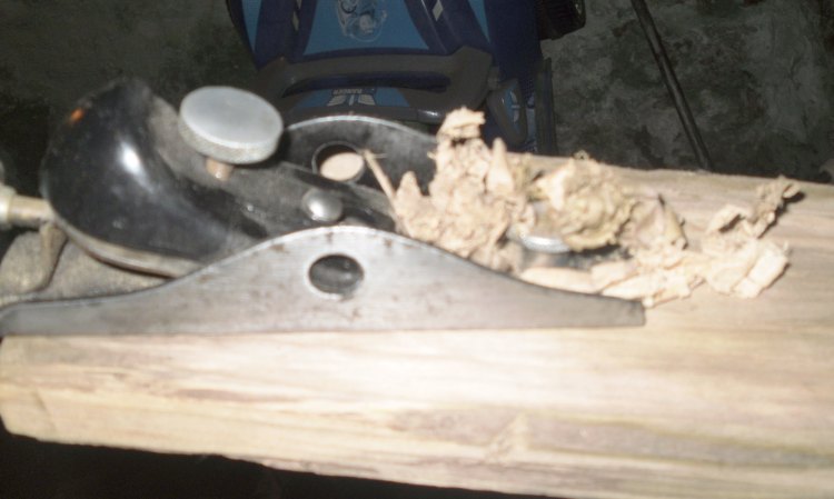

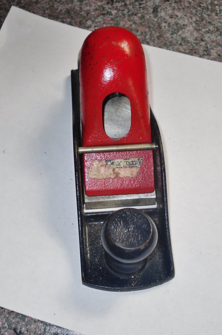

 Took about half the day to get me moving around enough, to go down to the Dungeon Shop.    I had five block planes to check out, to see which I wanted to sell.   Three of them passed,ning-sdc14109-18611-54.jpg?width=750 a Blue Stanley #220  seemed to work ok.  ning-sdc14110-18611-48.jpg?width=750A shelton made 118 clone (all steel) also passed the test.   ning-sdc14111-18611-90.jpg?width=750The Craftsman/ Sargent 306 also passed the test.   The losers?   A sargent made 130 clone ( hand killer!  leaves a lasting impression on your hand) and a Handyman 120 clone ( worked  not too badly, just hate 120 style planes))

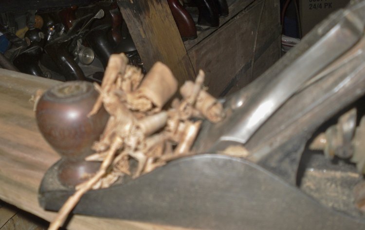

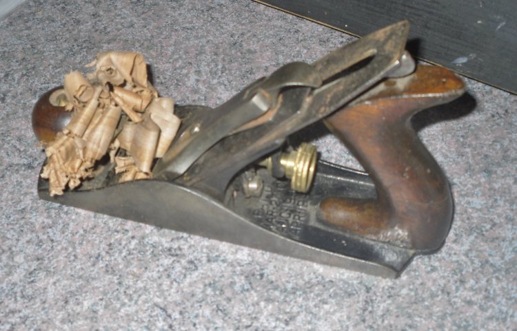

Tried out a #33  Scrub plane..ning-sdc14106-18611-4.jpg?width=750Just to rough up the test track a bit.   had to back off the iron a bit, it was trying to take TOO BIG of a bite.   This is with just a little bit showing.    Next a few smoothers...ning-sdc14113-18611-81.jpg?width=750A Union #3, at about 105 years old, still working.  Next, something a might newer...ning-sdc14108-18611-76.jpg?width=750A Handyman #1204.   Same as a Stanley #4 in size.   About mid 50s, or so... Speaking of Stanley #4s...ning-sdc14115-18611-24.jpg?width=750How about a Type 11?   Brought it upstairs for a better light.   This was once a pile of rusty junk.

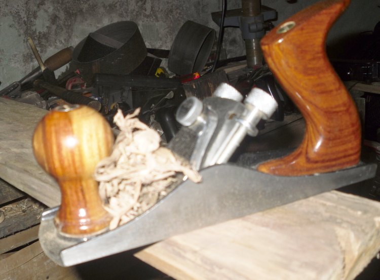

 That type 11 #4c Stanley  was part of a $5 Challenge.    I was sent a rusted up pile of crud, with a crack knob, and no tote.   This is what became of it.

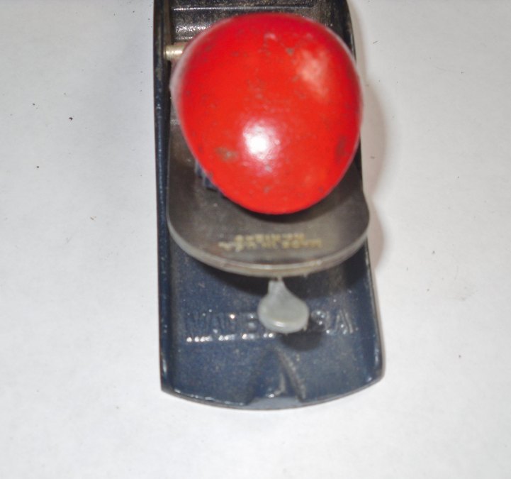

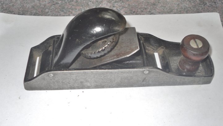

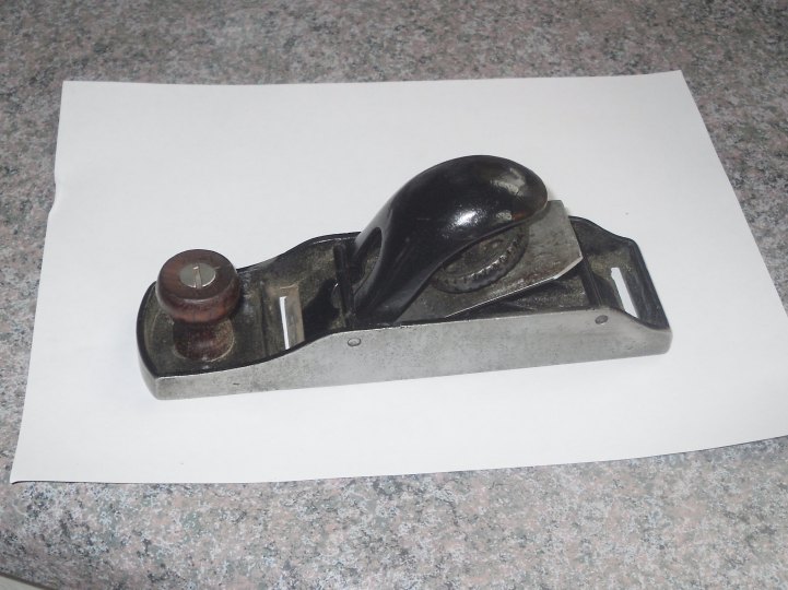

Anyhoo, here is a look at the two planes that didn't make the "cut" yesterday..ning-sdc14116-18615-45.jpg?width=721Looks like A Stanley #130?   But made by Sargent.     Not a comfy plane to push around, it WILL dig into your hand.   It will switch around, though..ning-sdc14123-18615-52.jpg?width=721Not very fun that way either.   Now on Ebay.  Next "loser"..ning-sdc14124-18615-2.jpg?width=721This one IS a Stanley, a Handyman #H1249 block plane.   It does cut, but it tends to chatter, too.    The main reason I didn't like this plane?ning-sdc14126-18615-35.jpg?width=721That little lever.   It adjusts the depth of the cut, push it down, blade retracts, push the plane along-hands pushes the lever down.  Then you just skate along.    I hate a 120 style plane.    Every  one I have had gets sold.   This one is now on Ebay.

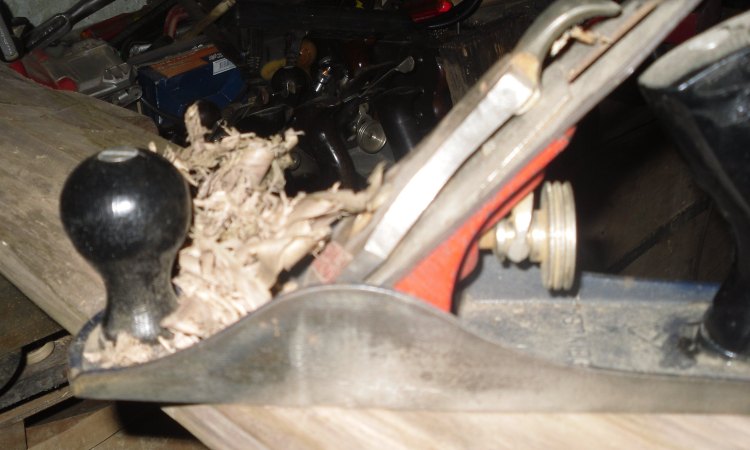

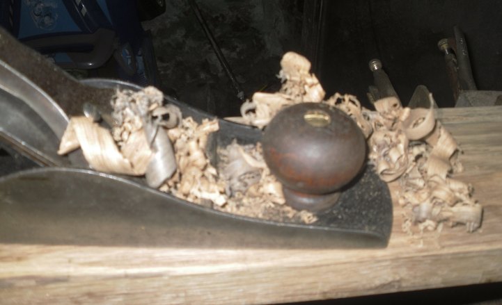

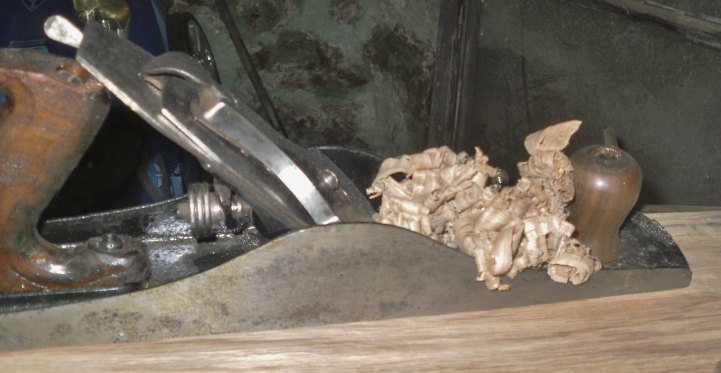

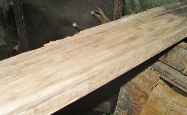

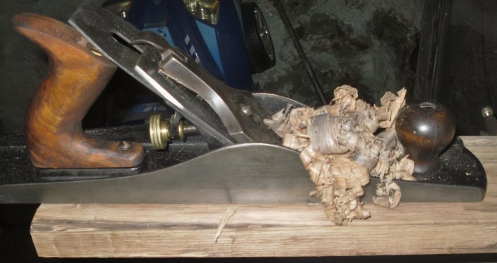

Finally @ 1700 zulu, made it down to the Dungeon!   Set up a new test track  of gnarly old oak 4/4 x6x48".ning-sdc14131-18614-35.jpg?width=721I adjusted the three larger planes to act like smooth planes, just to test IF they could do that job..   First up, a 5-1/2 sized Union #5A...ning-sdc14132-18614-7.jpg?width=721Not too bad, for going AGAINST the grain (ooops) Set that plane aside, and got a rebuilt from a wrecked DE#6c small jointer plane.   I think it MIGHT just do this type of work,,,ning-sdc14133-18614-12.jpg?width=721Shavings even look thinner.  Still going against the grain, even!  Finally, another #6, this one has a narrower iron ( 2-1/4") and it is stamped SAVAGE on the iron ( made by UNION, though)....ning-sdc14134-18614-57.jpg?width=721this is with the grain, and is as fine as it can get.    Hmmm, I think this one will stay a jointer plane.
