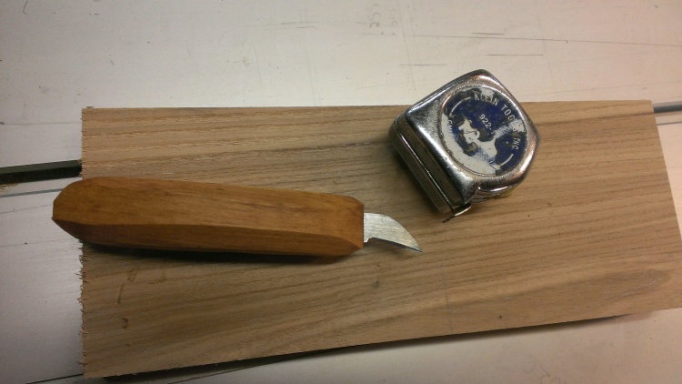

I want to carve some letters in  three pieces of siberian elm.
So I looked around and  watched some chip carving videos and though that that might be a good approach but I think maybe it's not.
I made a nice little knife
ning-chipknifefinished-18533-62.jpg?widtIt is a bit tough to sharpen because it is  made from M2 and hardened to better than 62 RC but once sharp it's quite edgy.  However when I  drop it on the elm  using the three position grip ( thumb knuckle and blade)  push it in the wood  it doesn't penetrate as far as anything I've seen on the You Tubes, and then  when I set about to pull it through any sort of cut the blade stutters  off of the grain boundaries.
Which leads me to wonder if chip carving is really only appropriate for certain species of wood like boxwood and a couple others with very even grain.  Siberian Elm has very dramatic grain. It's not a very hard wood  being sort of like Cherry, but it's dramatic.
Is this correct, that I have the wrong technique for this wood??
If so, maybe I should turn to carving gouges?
The font I want  is times new roman in 60 point size, just like you will get off any word processor.
 Any ideas?

 So I should be looking for some gouges.  I thought so after  failing so miserably right out of the gate with a knife..
