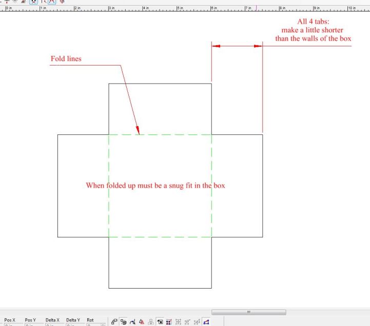

You can use a single sheet of cardboard too  and the Rockler  self adhesive velvet would work nicely with it  cut  the cardboard like this:
ning-boxlining-18408-3.jpg?width=721
