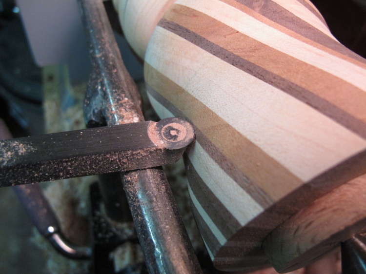

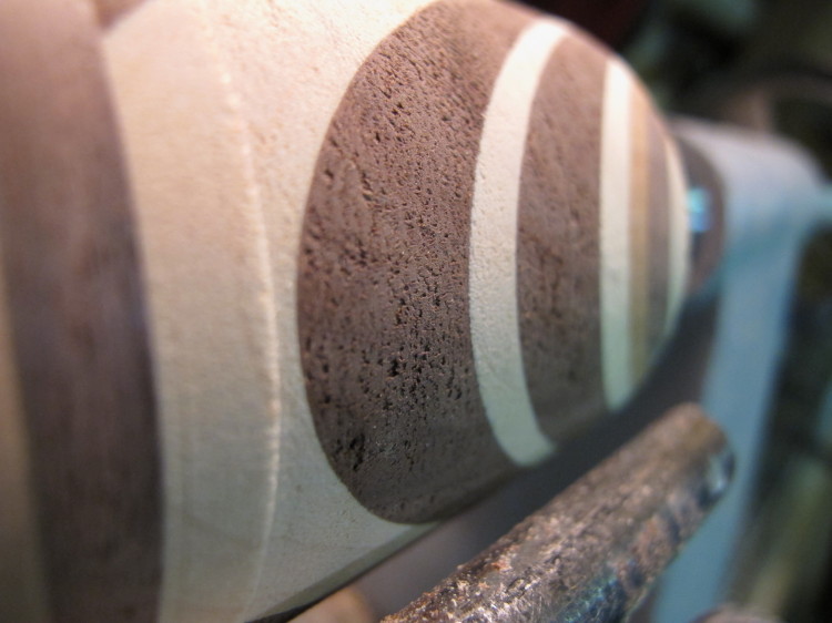

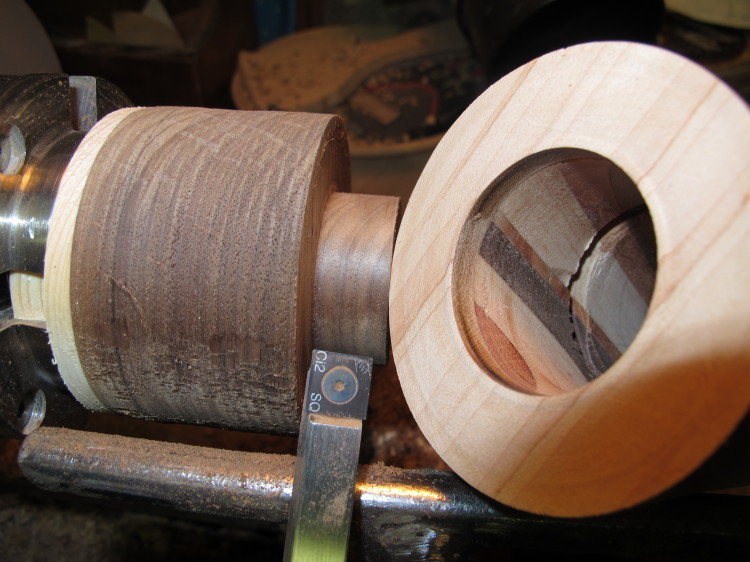

The Easy Wood Rougher (with the square cutter) made fast work of bring the rounded blank into a smooth cylinder. When starting, I used the tool directly from the package. It was sharp but it did leave a slightly rough surface. I noticed the cutter edge appeared it had been the only one used. Turning the cutter to expose a fresh edge made a marked difference in the smoothness of the cut. I cut the grinder top tenon with the Rougher, also.
Used Edge-
ning-img-1671-18123-56.jpg?width=750
Fresh Edge-
ning-img-1673-18123-35.jpg?width=750
Tenon Cut-
ning-img-1664-18123-2.jpg?width=750
 Switching to the 2†roughing cutter allowed much easier shaping of the grinder. I liked the way the cutter moved over the blank with very little tendency to create a line at the edge of the cutter. The 2†cutter- even the 4†cutter (not tested) - would be my choice for roughing and moderate shaping.

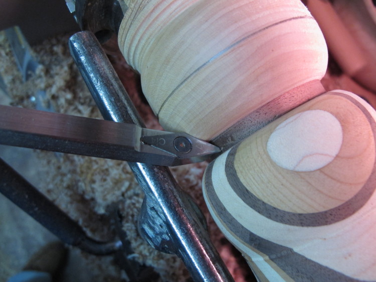

The Mini Finisher created the cove cut. It made a very smooth, clean cut. I first started the cove at a relatively low spindle speed. Mike Dillen experienced some ridging and so did I. Increasing the speed to moderately fast, eliminated this problem. I guess the “trick†is to keep the lathe speed high, when using this particular tool.

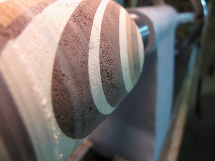

The Mini Detailer cut the convex portions of the grinder. Of the three tools, I liked this tool the best. It is very versatile and easily controlled. It can act as a parting tool or shaping tool. In my opinion, if anything could improve this tool, it would be creating a cutter that has a “square point†on one end and the “round point†on the other.
ning-img-1674-18123-48.jpg?width=750
