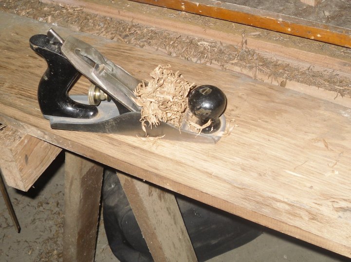

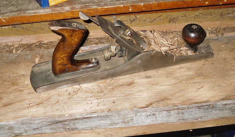

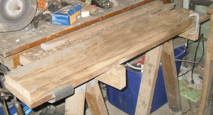

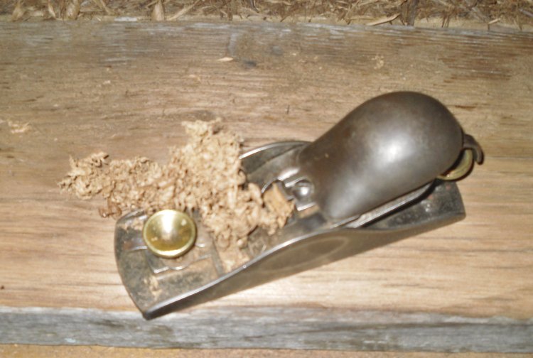

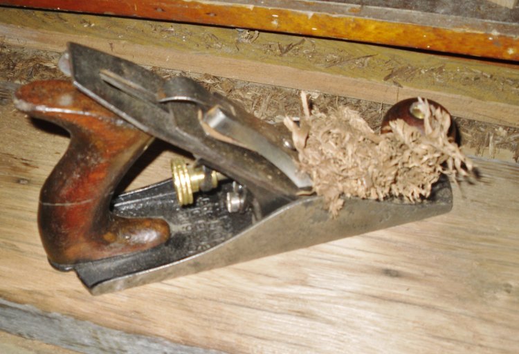

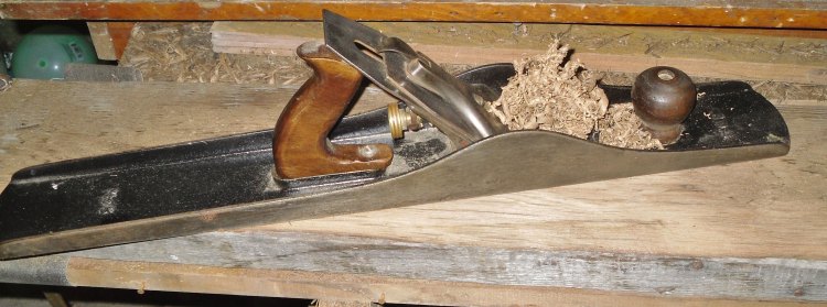

Got after the high spots by scrub plane.   First was a clean off with the little scrub plane.ning-sdc14106-18081-71.jpg?width=750This is an apron board for the table to be.  The plane is a #33 Windsor from harbor freight.   I just reground the iron to a 3" radius.   Plane is used just like you see here.    I got the worse of the dirt, grit, and other weather related junk off the plank this way.     Next was a Jack Plane, also with a cambered iron.    Not just any jack, mind you, a PARPLUS #5 with a pressed steel "toad", er, Frog.ning-sdc14181-18081-33.jpg?width=750This time, the plane was going along at the diagonal to the grain.   Hmm, that don't look like Pine?  Ok, after going along and getting the hump in the middle down to the level of the rest of the board, I moved on to a longer plane.   It was used earlier as a jointer, now it is a "Trying Plane" by angling across the grain until I got decent shavings all the way across.   For being over 100 years old, it still works decently.ning-sdc14183-18081-18.jpg?width=750Just an old Stanley #8c.   With most of the face flattened down, and cleaned up, I thought I would try a smoother plane.   Just to see if there are any little bumps left. ning-sdc14184-18081-42.jpg?width=750Shove this old Stanley #4c, type 11 around until things felt nice and smooth.  Yes, that USED to be a crack in the handle.  Now all glued back up, and working just fine.

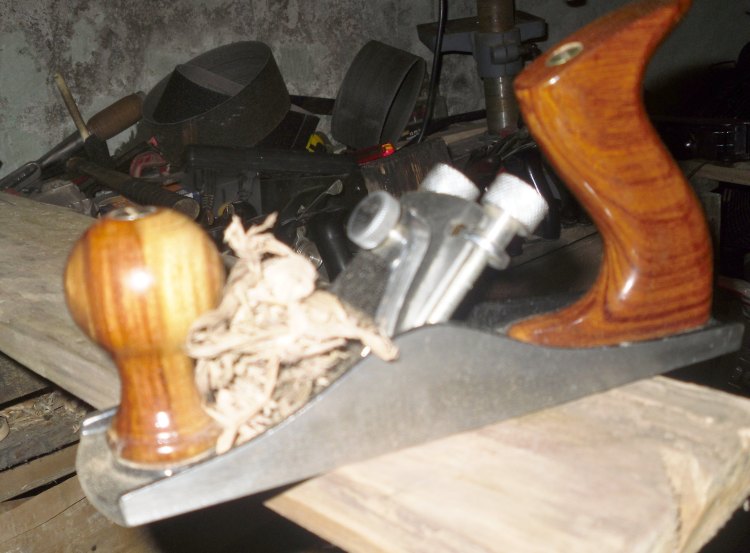

And, just because I canning-sdc14185-18081-60.jpg?width=750Tried out the little #18 Knuckle cap near the ends.  Still don't think that plank is Pine......

Thats a nice looking #8c Steve. Do you prefer the short knob over the tall knob?
I kind of like the tall but that is just because thats what I started out with.

 Short knob was the style that came with the Type 9 I have.    It's not too bad.    I have a mix of tall and low knobs in the "group" of planes.

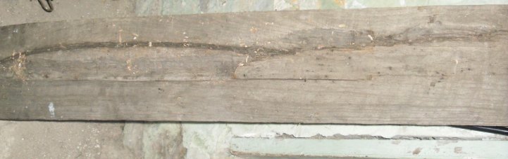

Wait until you see the other side of that plank.    It is very UGLY!   Going to take a lot of scrubbing on that side.
 Went after the other face of the plank today,  wasn't as bad as I thought.  I even used another smooth plane on the second face,, just to try it outning-sdc14188-18082-6.jpg?width=721Board is now surfaced three sides.  One edge, and two facesning-sdc14186-18082-19.jpg?width=721 Looks a lot better than the other half of the plank.   ning-sdc14187-18082-86.jpg?width=721 Looks more like firewood to me.   Next up, trying a circular saw to rip some leg blanks out.    They don't have to be "pretty", as I think I have a few planes to clean them up with.     Plan right now is to taper two sides of each leg.    Until next time...
