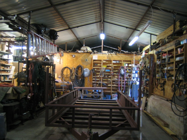

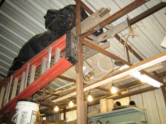

   I knew after all this extra extending would not get the motor home a place to park inside for the motor home clearance is 12'4" and the shop has 9 foot walls. I would get the extra clearance by cutting out the inside of the pipe trusses but first I would have to drill holes in the concrete installing new pipes under the end of each truss I would  have to cut out.  This was I would still have each end of each truss welded in to the ground through the concrete.IMG_8505.JPGIMG_8510.JPG
 This area was a trailer paint room last week.
Then after I got each pipe buried in the concrete and welded under each truss I could go ahead and using a cutting torch cut the inside of each truss that was in the way. The motor home just barely fits but I have walking room beside it and I still have working space on each side of the shop and still have a 30 x 20 insulated with heat and air plus the shop area for wifes stained glass  8x20 heated and air.
