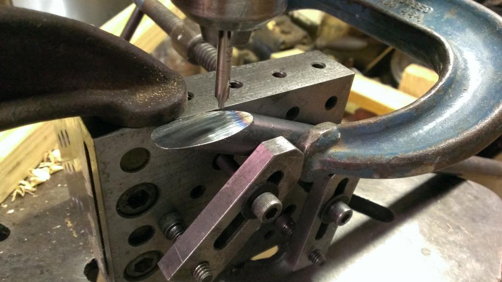

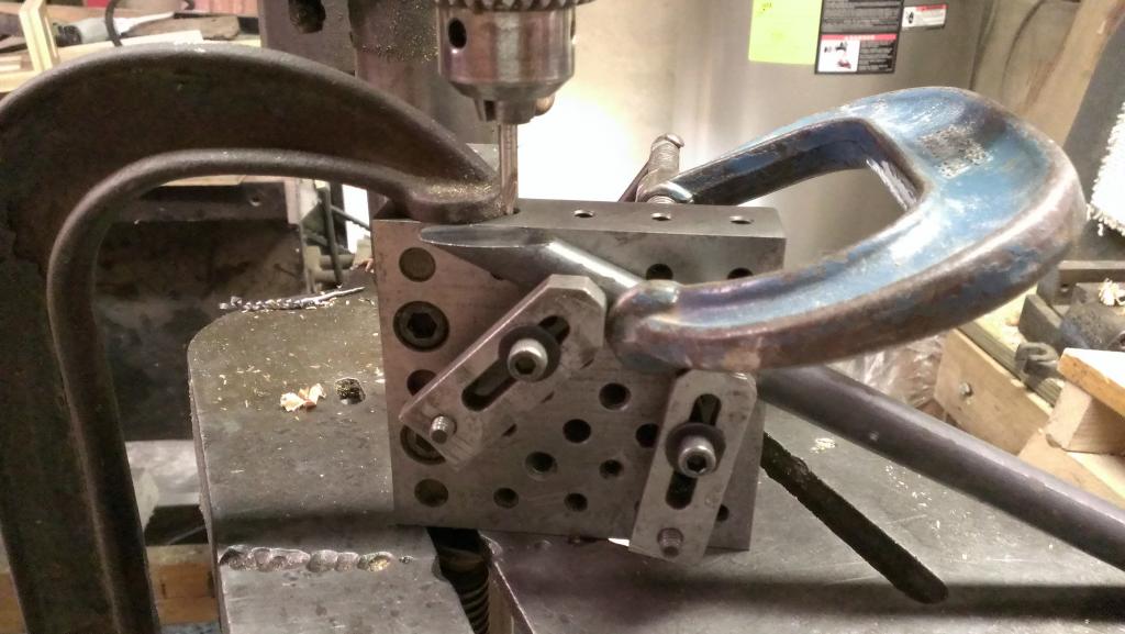

I wanted to try one of those fancy pants carbide insert negative angle scrapers
 But the  bloody stinking things are like a hunnert dollahs and I didn't want to throw a C note at an unknown.
So I got me an  $11  carbide insert and a hunk of 5/8 bar stock
I threw the bar stock on my Makita chop saw with an abrasive blade, clamped it at a rakish angle with a big C clamp and cut the negative rake. No, I haven't a clue what angle I used  - - It just looked right.
Then it was onto my right angle hardened steel block I made when I was a toolmaker by trade and onto the drill press for  drilling and tapping.
LEMETELLYA I hate A36 Steel for tapping fine small threads but that's what the borg sells so it's what I used.
IMAG0018_zps9dfb0784.jpgIMAG0020_zpsc8a50d3b.jpgIMAG0023_zps30c9ab09.jpgIMAG0025_zps0e0aac9d.jpg
No I made not one single one of those drill point divits on my DP table.  That was the prior owner/drooling-morons.
But I did get the DP cheaply.
But I digress.
Not I gotta make a handle.
If I don't like the angle I can re cut it.
What a lovely excuse to turn a handle.

HA HA HA HA   Well I didn't do any research on the angle.  I just Eyeballed it and  well we;ll see how it works out.
Truth be told the actual work took no longer than an hour.  The chop saw is fast fast fast. The drilling of a #29 through hole was fast and the tapping was the slowest taking maybe 5 minutes.
I started it in the drill press just to get it true and finished by hand.
In A-36 steel, like 316 SST, when tapping small fine threads  ya gotta go in like maybe  a tenth of a turn and then back it out to break the chip. and that's the drill over and over again till you are through or at depth.
So if I don't like the angle or want to try another: All I gotta do is repeat the process.

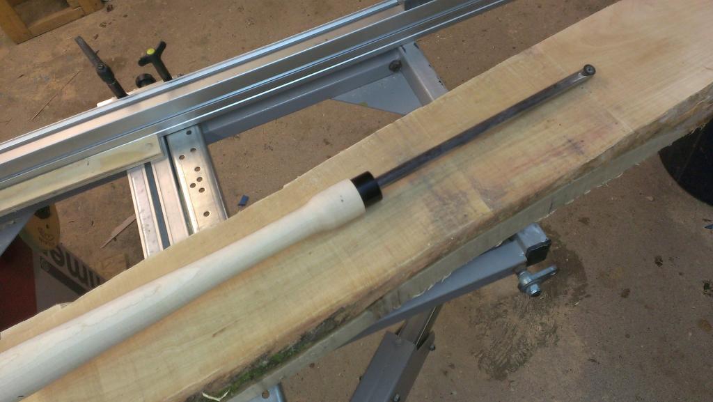

well I took lew's input seriously and  cut drilled and tapped the other end of the bar to 6-Degrees. Then mounted the cutter and gave it a whirl.
It scrapes really well and I can turn it on it's side and take a sharp slicing cut.   This is way far better than squandering a hunnert smackeroos on nothing more than a bar of steel with a cut end and a tapped hole.

The ferrule is 1.380" ID steel pipe wall thickness  a little more than 1/16".
