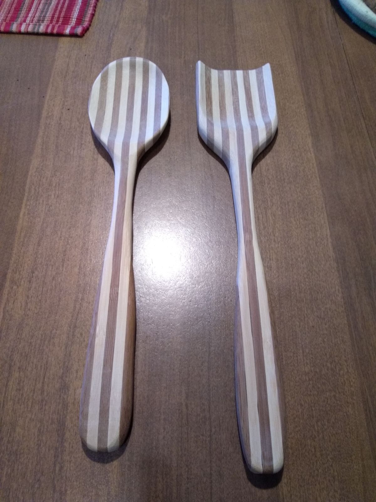

Made this second one since two this afternoon/1306190302_IMG_20220226_172531979twospoonsone.jpg.58dd9b5f1d602dc2449fe07dc2d01d84.jpg112483101_IMG_20220226_172443140twospoonstwo.jpg.ebb3b43c4f2c18197a184ac7c5318c32.jpg
 These are for maw to use and it would not be a good idea to sell them more until we see how they hold up.

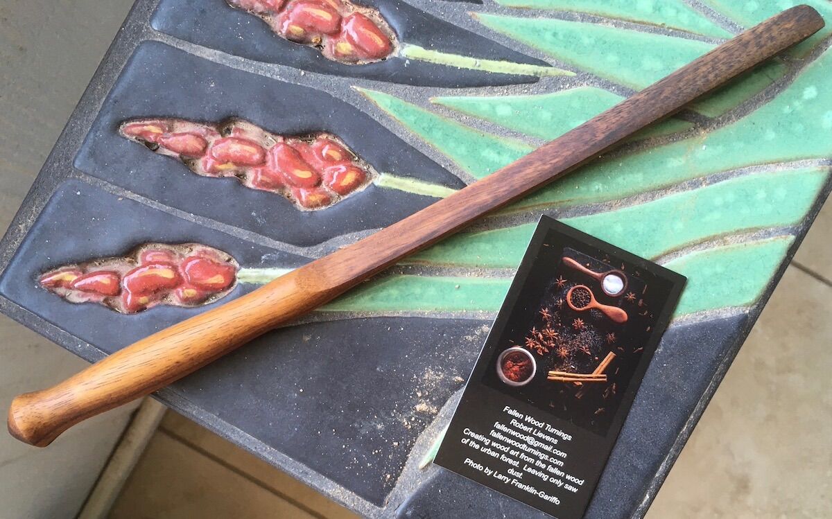

Last year I added to my spurtle collection. It's now up to one. Robert sells his varied pieces on Saturdays @ Uptown Farmer's Market  in Phoenix. It's made from the shoestring acacia tree, but he crafts in all types of wood.
spurtle - noun: a wooden stick for stirring porridge. ETYMOLOGY: Of uncertain origin, perhaps from Latin spatula, or from sprit (a pole to extend a sail on a ship)
