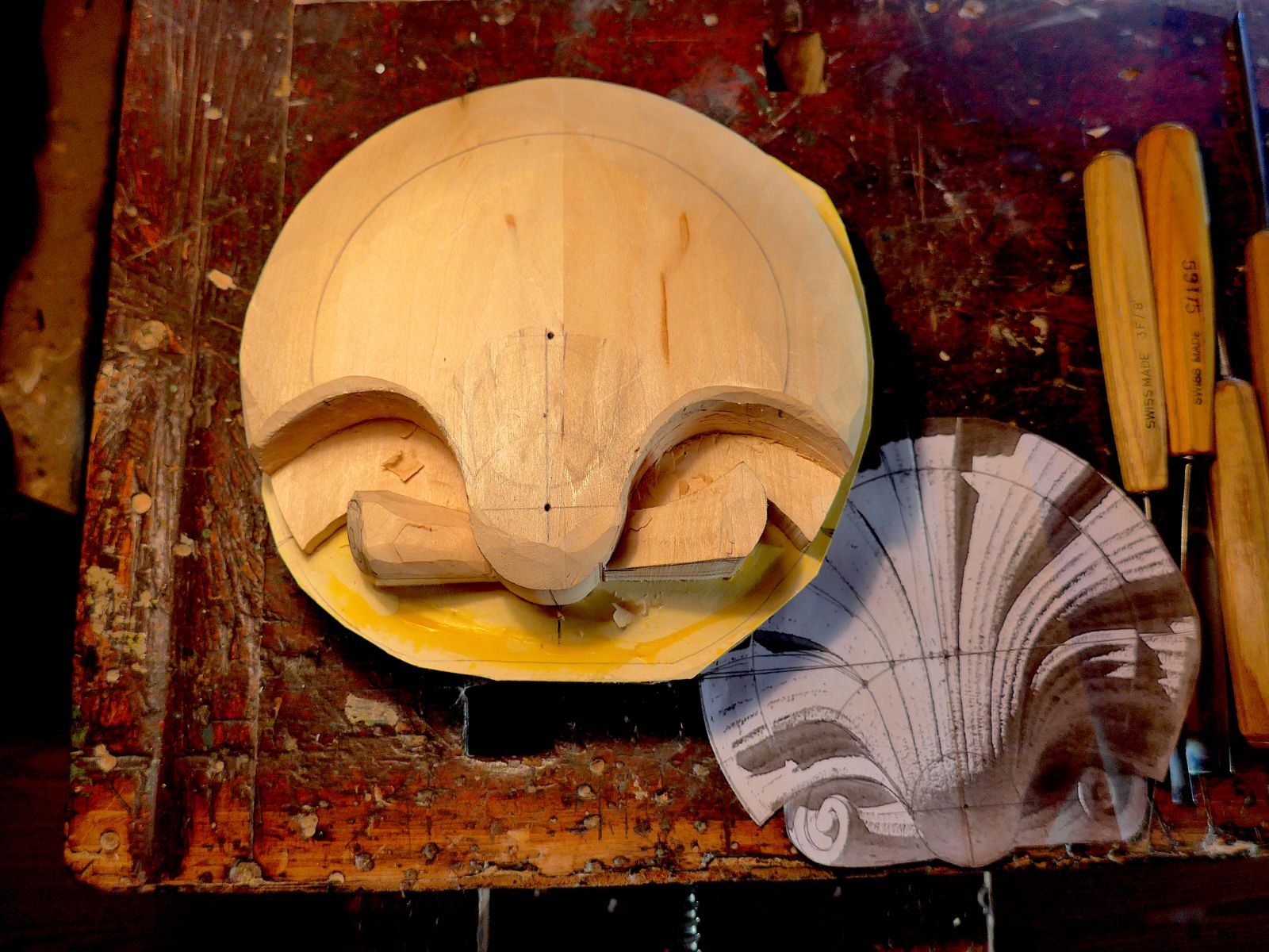

The basswood blank is cut out and ready to carve. Before I start to carve, I always try to lay out the shell on the blank to check out the proportion of everything. Carving from a photo has got it's limitations and many things have to be "guessed" at. For some reason, the drawing of the shell proved to be rather difficult but I gave it my best shot. Next step will be to lower the edges of the blank and then start to carve the top layer of volutes.

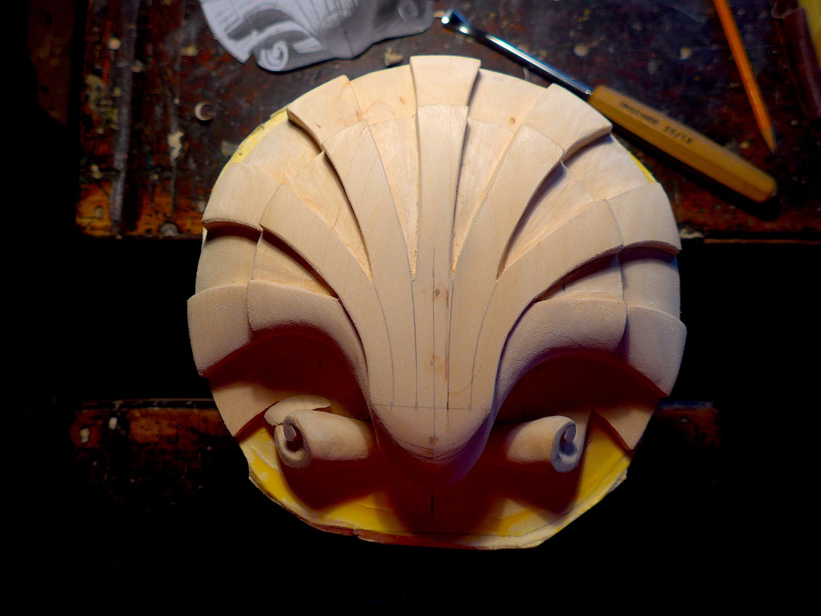

Cutting in the separations for the rays. The end cuts will be a challenge because of going against the grain and cutting up hill.
Looking good there Frederick! I see another masterpiece in the works, love it! What size chisels are you using for cutting in the rays? Sweep and size?
John, sizes are #2,3,5 in 15mm,35mm. Sometimes the #2-15mm will work for a #5-35mm. The smaller the chisel, the easier/safer it is to use.

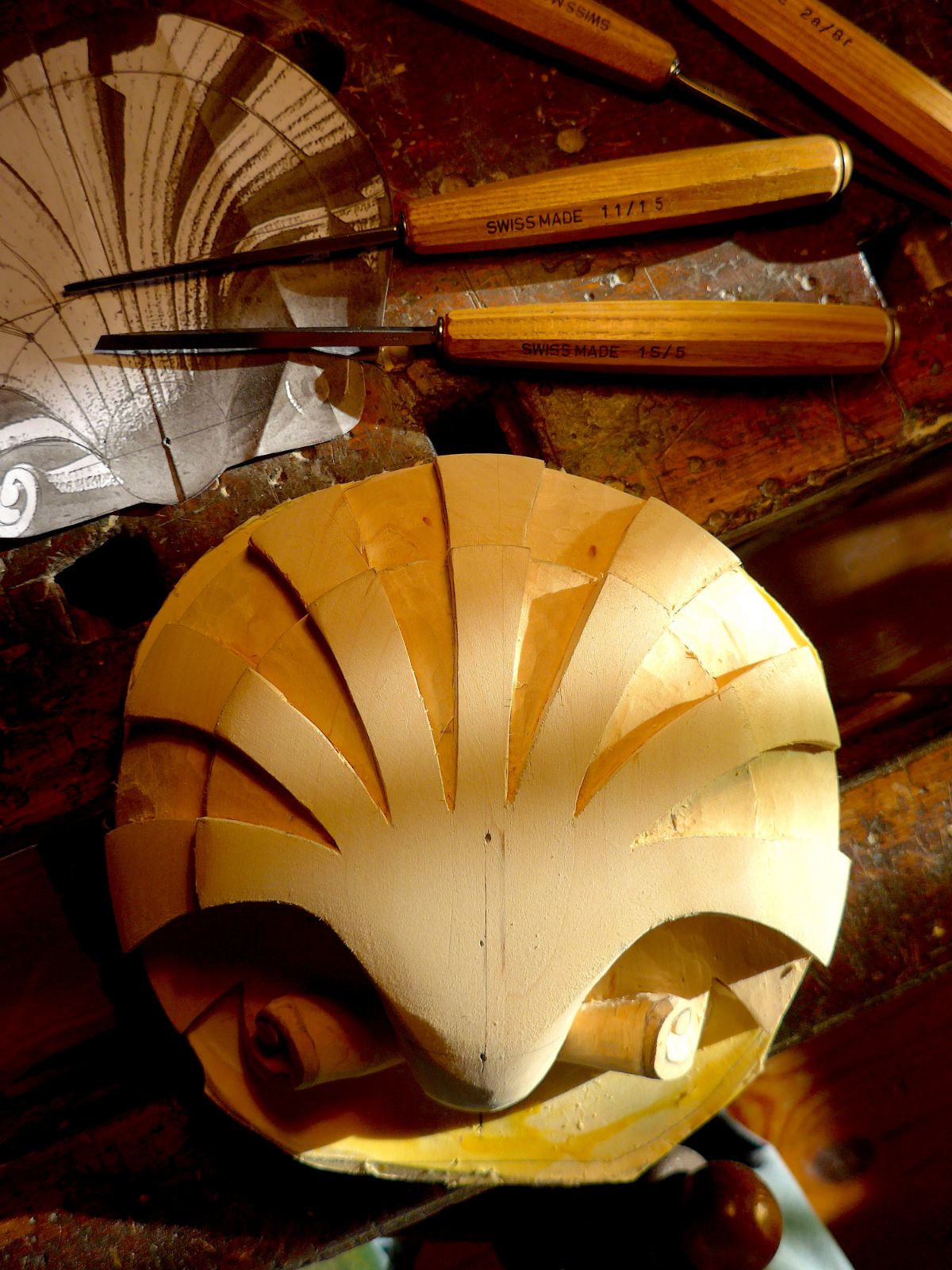

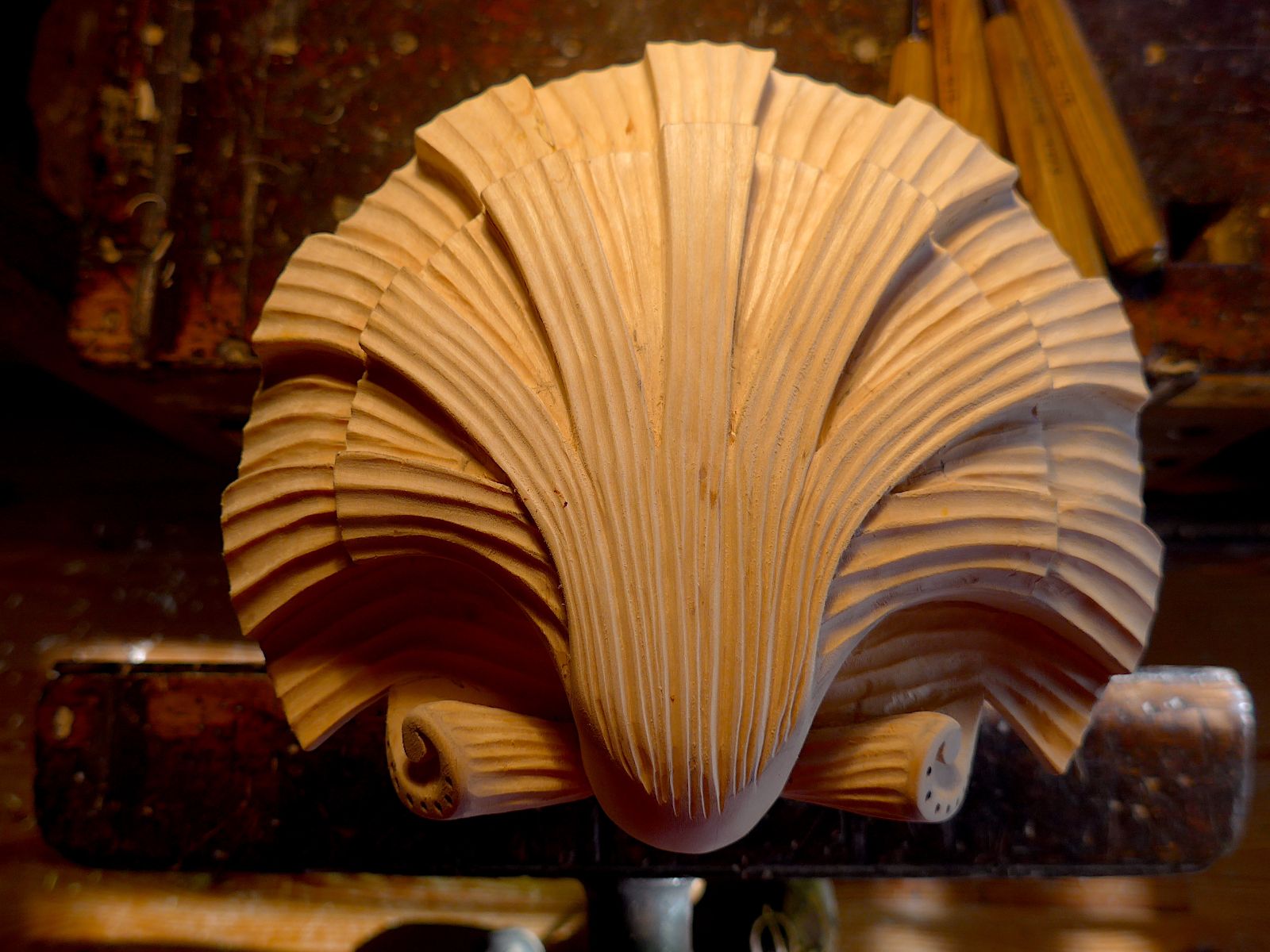

Getting ready to cut some flutes. This will be difficult because of reversing grain direction and cutting uphill and against the grain. Tools need to be extra sharp and the 'correct" sweep selected. I'm also working on getting the plaques ready to turn.L1010852.JPG.1d9a125487ba6d8c967e8f02188bfaf1.JPG

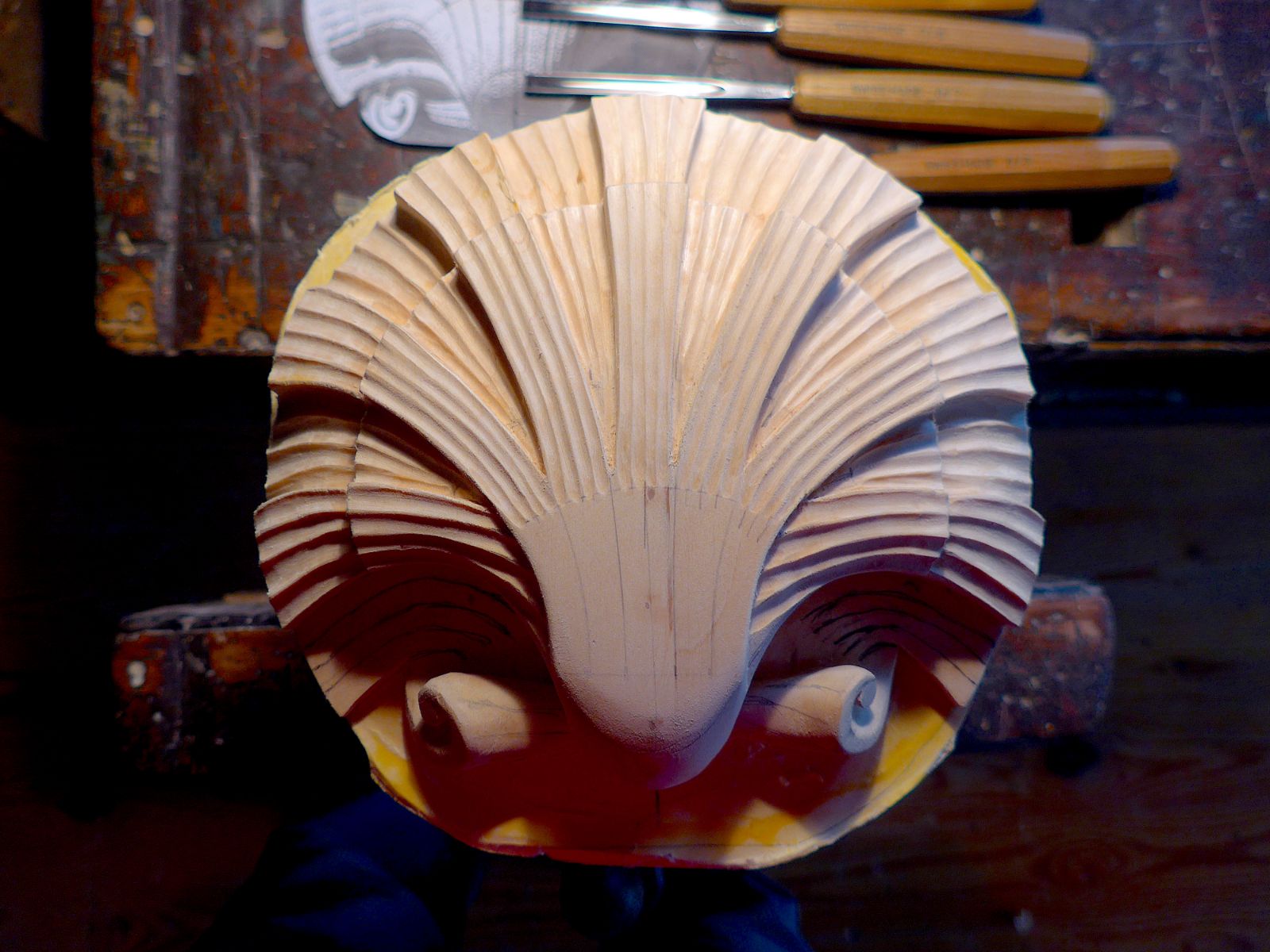

The fluting is coming along! You have to have absolute control over the razor sharp tools and I found that the "curl' of wood, coming off of the gouge, would obscure my layout lines, and then I would have to stop and clear them to proceed cutting. I'm transferring my shell to a smaller carving block in order to do the hinge area around the bottom. It's downhill for the carving now(I hope)!

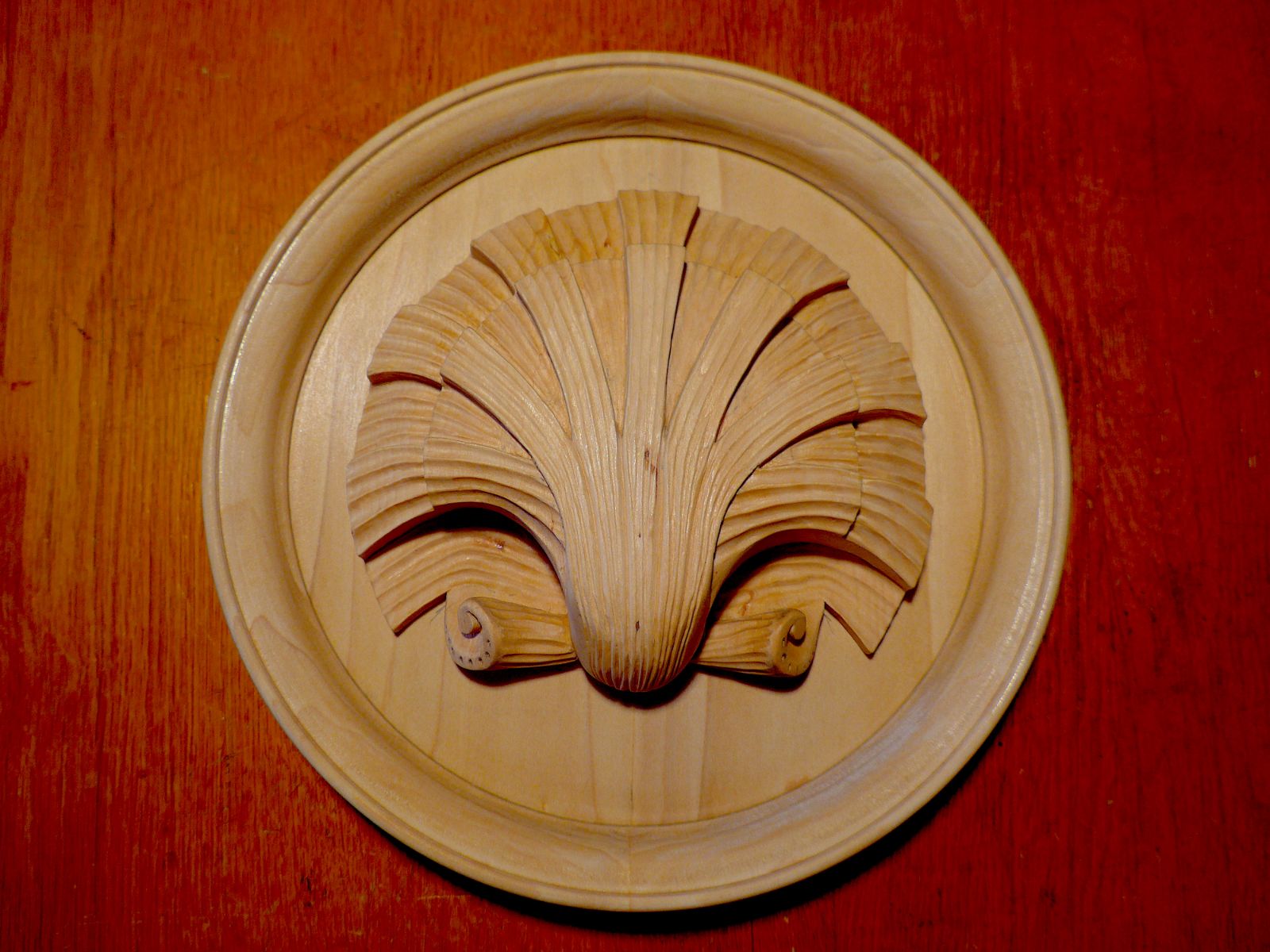

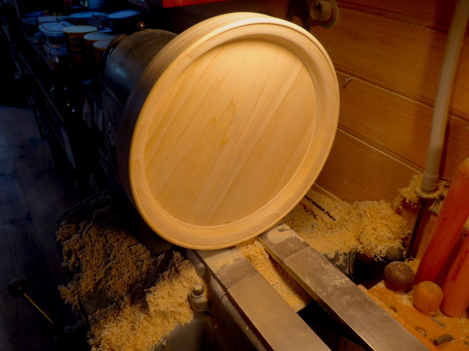

Carving done, except for the minor touch-ups. It's amazing what you'll see in a photograph vs. what the eye can see. I got tired of "chasing" whiskers and did the preparations for the 12" plaque. I'll get this turned/finished tomorrow and then take everything downstairs for the prep/paint/gilding work.

Plaque is turned, first coat of shellac/sanding done. Now, for the second coat/sanding, then onto the finishing process.
Ready for paint/gesso/gold leaf.

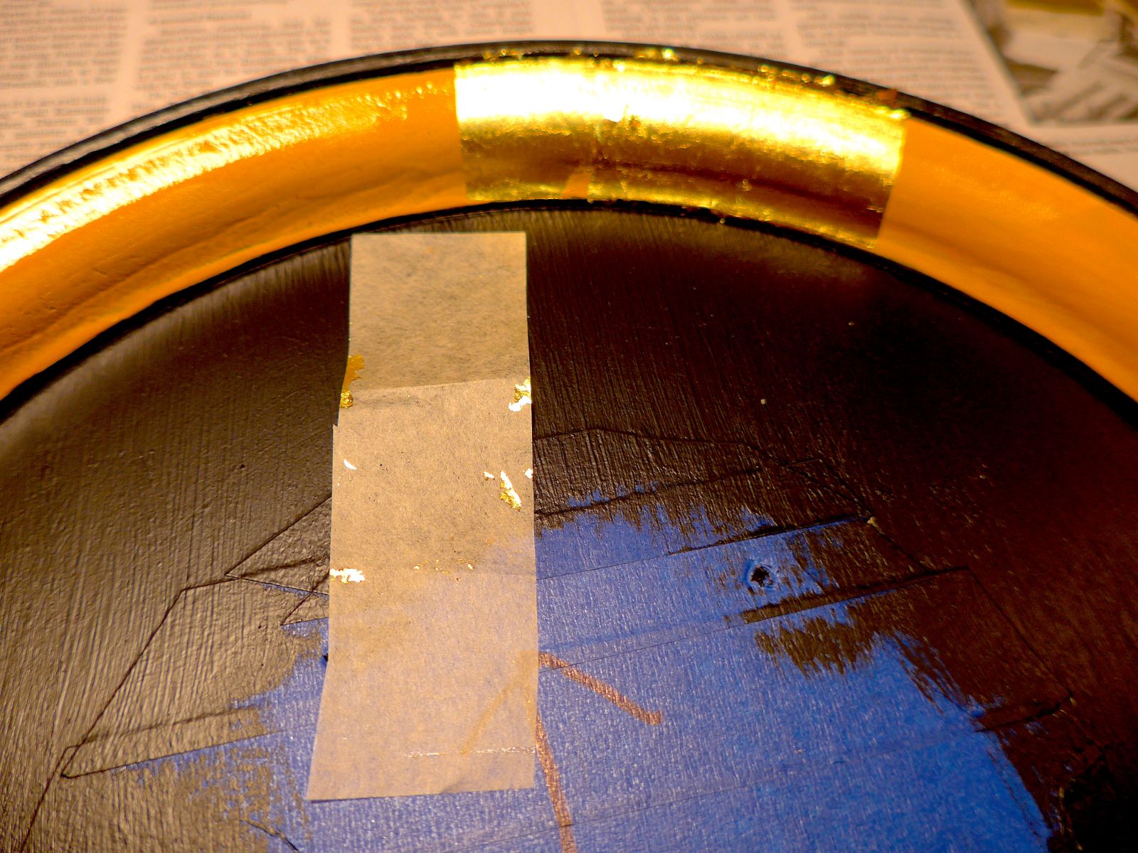

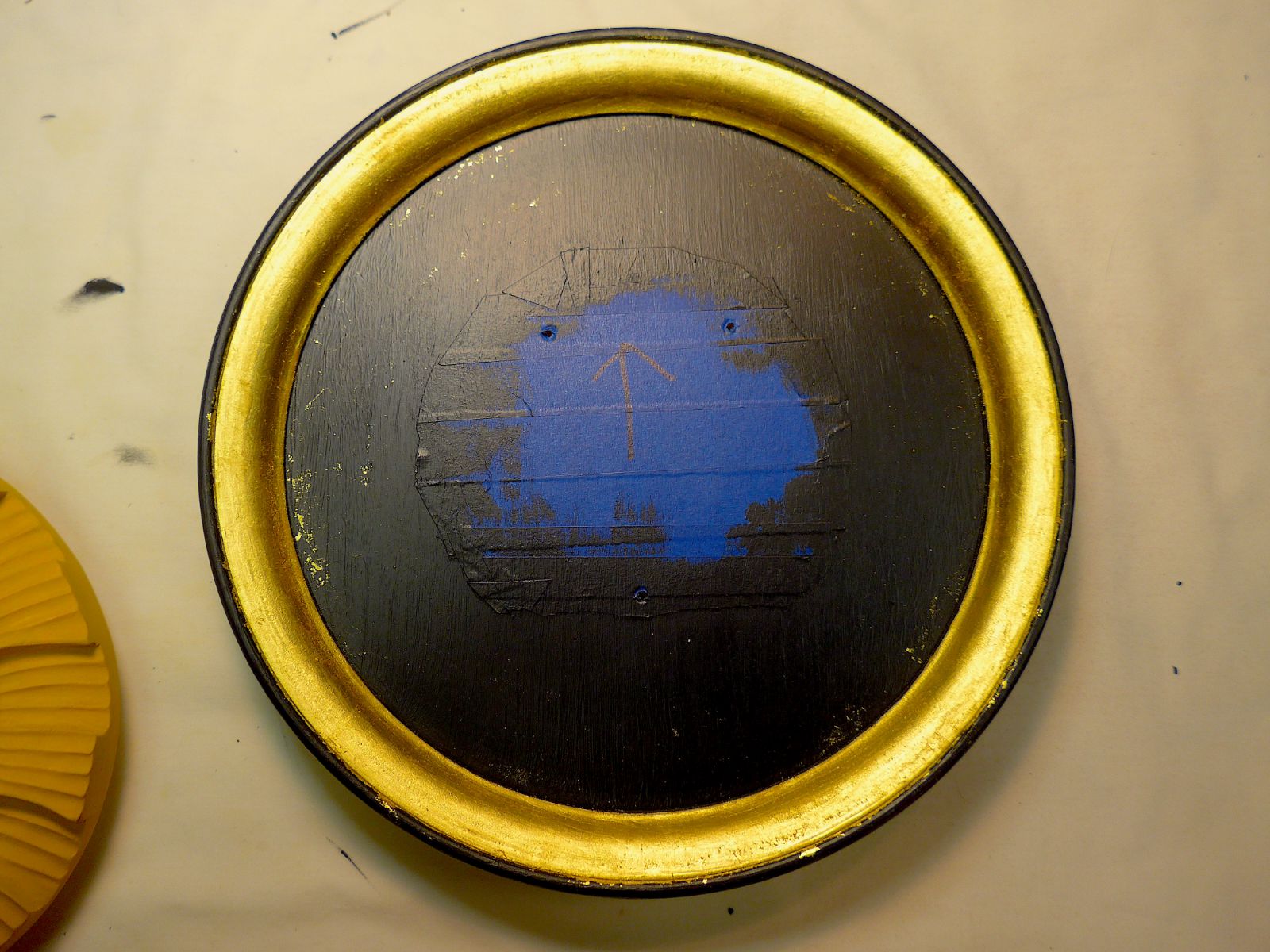

Here's the finished leafing around the perimeter of the plaque. Any gold crumbs should be able to be brushed away. I'll paint over, with the black paint, any of those that are stuck to the  wood.
