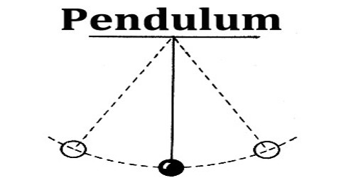

HandyDan Posted December 23, 2019 Report Share Posted December 23, 2019 I was thinking about the router as a pendulum but that would limit the depth to circumference ratio. Quote Link to comment Share on other sites More sharing options...
BillyJack Posted December 23, 2019 Author Report Share Posted December 23, 2019 7 minutes ago, HandyDan said: I was thinking about the router as a pendulum but that would limit the depth to circumference ratio. It is... at this point he router can only make a certain size rout. A larger rotating base and a longer base will make a larger bowl. 3-4 inch radius is all I'm after. Otherwise a penilum as suggested in the picture above would be needed... Quote Link to comment Share on other sites More sharing options...
HandyDan Posted December 23, 2019 Report Share Posted December 23, 2019 2 hours ago, BillyJack said: It is... at this point he router can only make a certain size rout. A larger rotating base and a longer base will make a larger bowl. 3-4 inch radius is all I'm after. Otherwise a penilum as suggested in the picture above would be needed... I was thinking more like the router hanging from a rope. Quote Link to comment Share on other sites More sharing options...
