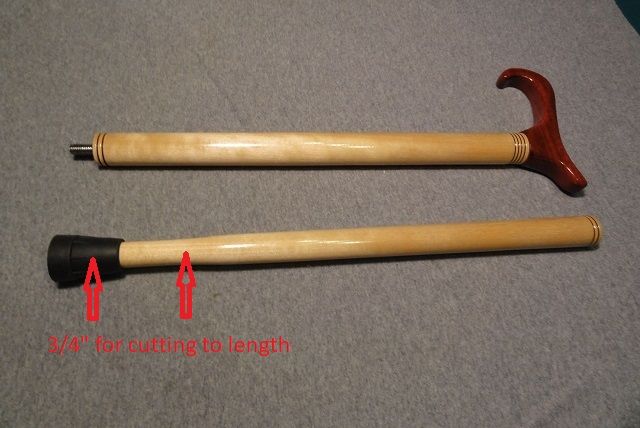

June 13, 20197 yr Popular Post comment_193379 Got the cane I've been working on done this week. This is the first one I made in two pieces. I started out with two brass bushings. Threaded them to a 3/8" coarse thread. Turned them down to 5/8" and turned notches into the outside so the epoxy had something extra to grab onto. Took a couple 3/8" bolts and drilled a chamfer in the heads to give them a true center point to ride the live center. Did this to make sure they met well when screwed together later. Took a 36" x 1 1/4" birch dowel and cut it in half. Found the centers and drilled a 5/8" hole in one end of each piece and epoxied the bushings in. Drilled the holes using the lathe. Mounted them in the lathe and turned them to a gentle taper and smoothed them out. Even at 18" long they want to chatter. I find a two wheel steady is all that is needed for this. I made it to fit the banjo from another lathe and is easily adjusted for height and closeness. Looked online at Google images for cane handles and decided on which one I liked. Drew it out on a piece of Purpleheart cut it out on the band saw and used the spindle sander to shape it from there. Lots of hand sanding after that but worth it. While turning the shafts I added some small beads under the handle and again at the joint to conceal it. Burned lines between the beads too. I used the lathe as a sculpting vise for the handle. Here is some pictures of that. Report

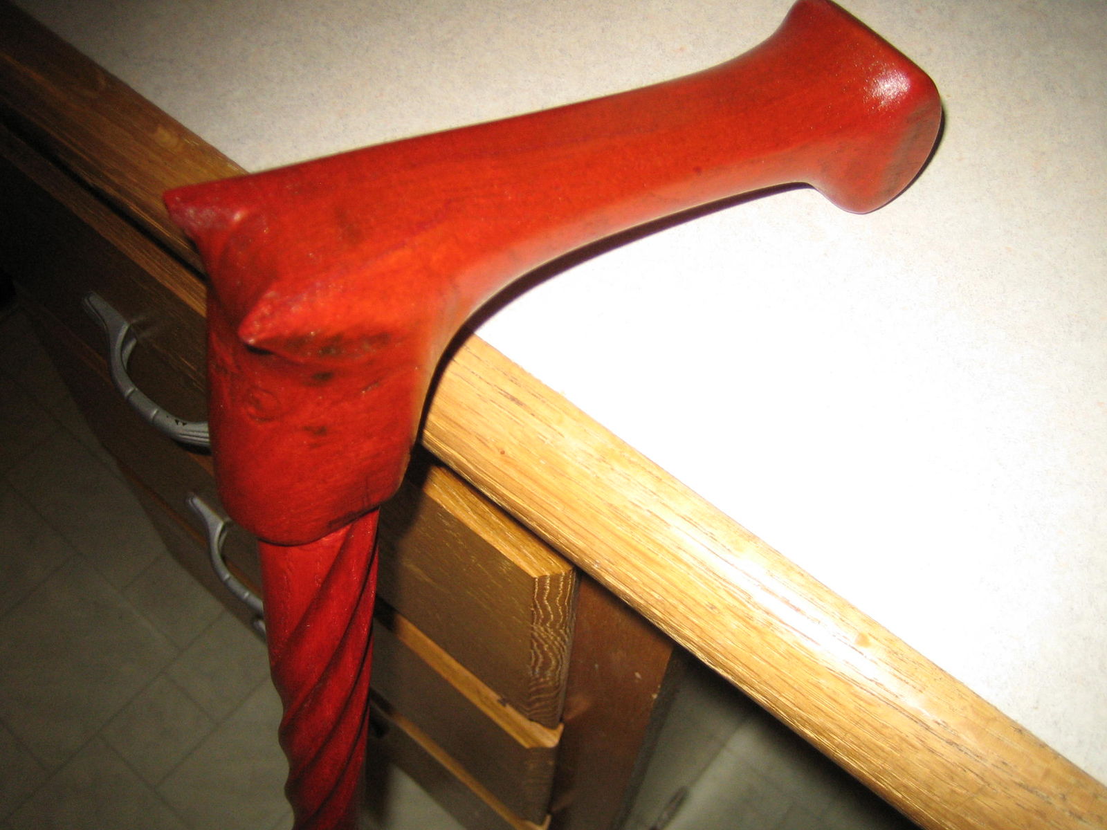

June 14, 20197 yr comment_193402 Mighty fine work there young man...It beats the first cane I started building on and the first attempt I started carving about 3 years ago...I thought I was carving a likeness of a young heifer and since there are a lots of cowboys around here I thought it would sell fast at the yearly craft fair we use to go to every year...Anyway the first guy who looked it over said that's a good likeness of a scotty dog.. After he left I took it back out to the pickup and slid it under the seat and I just found it as I was doing a not too often wash job which the last one was about three years ago just three or four days ago. It hardly ever gets moved out of the garage.. Hey, what happened to that great app or what ever for I went to eat and clicked off of this comp. and when I came back to finish it before I posted it,,,, it was gone...and I had to do this whole post again. Curses!! Edited June 14, 20197 yr by Smallpatch Report

June 14, 20197 yr Author comment_193438 13 hours ago, Ron Altier said: I made a couple and made them long so I could cut to length I thought of that too. With her standing I measured from the floor to the palm of her hand with her hand in a position of holding the cane. I then added two inches to that length and left room at the bottom of the cane to cut off if necessary. Report
