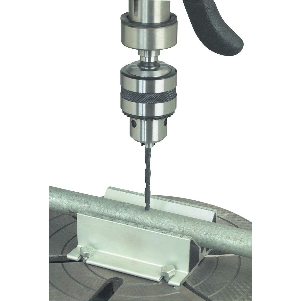

February 16, 20197 yr comment_178678 I made this for doing what you are talking about but I use it for drilling holes in metal or plastic pipe. Or from HF a smaller version https://www.harborfreight.com/self-centering-drill-press-jig-92046.html Report
February 16, 20197 yr comment_178691 What is your current technique and drill bit material? What are the issues that lead you to the conclusion that you can do better? For long straight holes I; 1. use a jig; the above jig or one like it, clamped to the drill press table (table turned to vertical), cylinder clamped to the jig. 2. use the shortest, long drill bit you can find. Size the length of drill bit to the project, don't use an 18" long bit to drill an 8 " deep hole. 3. use the best alloy, I've found the cobalt drill bits are the stiffest, as an added benefit they had a high heat tolerance. 4. use the right speed; my chart says 3000 for softwood, 1500 for hardwood (twist drill bits) chart also states to reduce speed on end grain, so I would cut the speed about 10%. If you have to raise the drill press table to drill deeper holes (multiple times), clamp the bar that the table rides on (notched bar on the side of the column), this is to prevent the table from shifting side to side while lifting the table for another pass. One clamp low, another clamp just below the table mount. Report

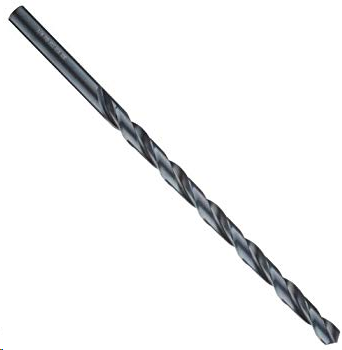

February 17, 20197 yr comment_178761 There is a lot of twist bits on the internet that are 12" long. Just look for "Extra long twist bits". https://www.amazon.com/Neiko-10260B-Heavy-Duty-Steel-Drill/dp/B006E5PYJC/ref=sr_1_7?ie=UTF8&qid=1550370943&sr=8-7&keywords=extra+long+drill+bits+for+steel Report
