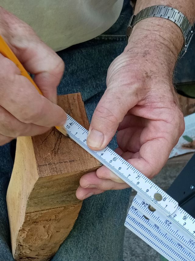

And, if you don't have one of the little center finders, this old tried and true method will suffice.

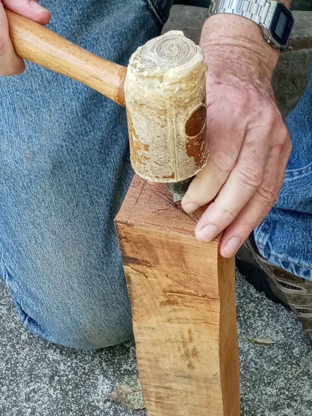

Please folks, don't drive this drive spur into your wood. Making a dimple for your drill is ok and you want the whole to accept the complete point so that the spurs engage the wood.
