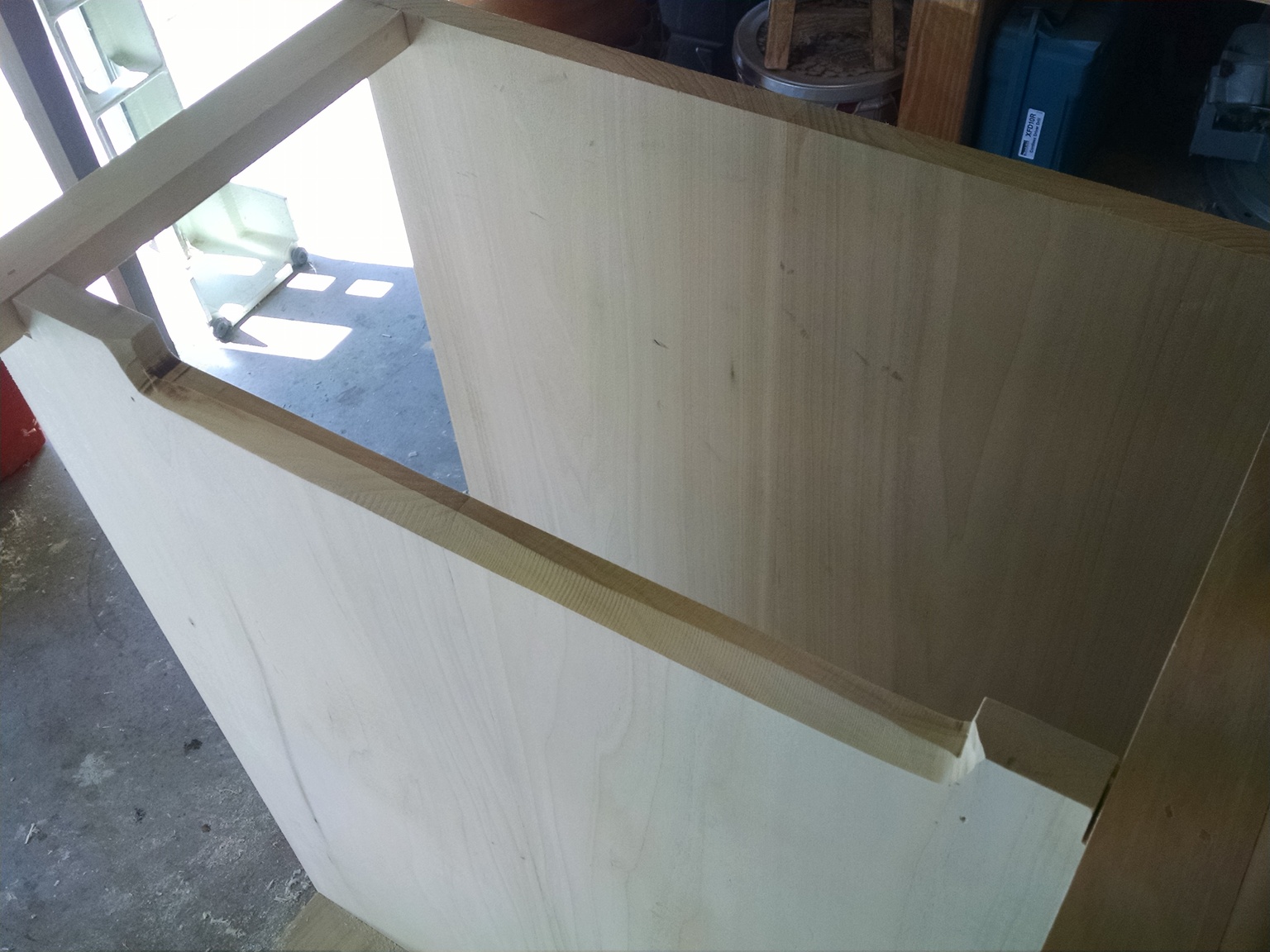

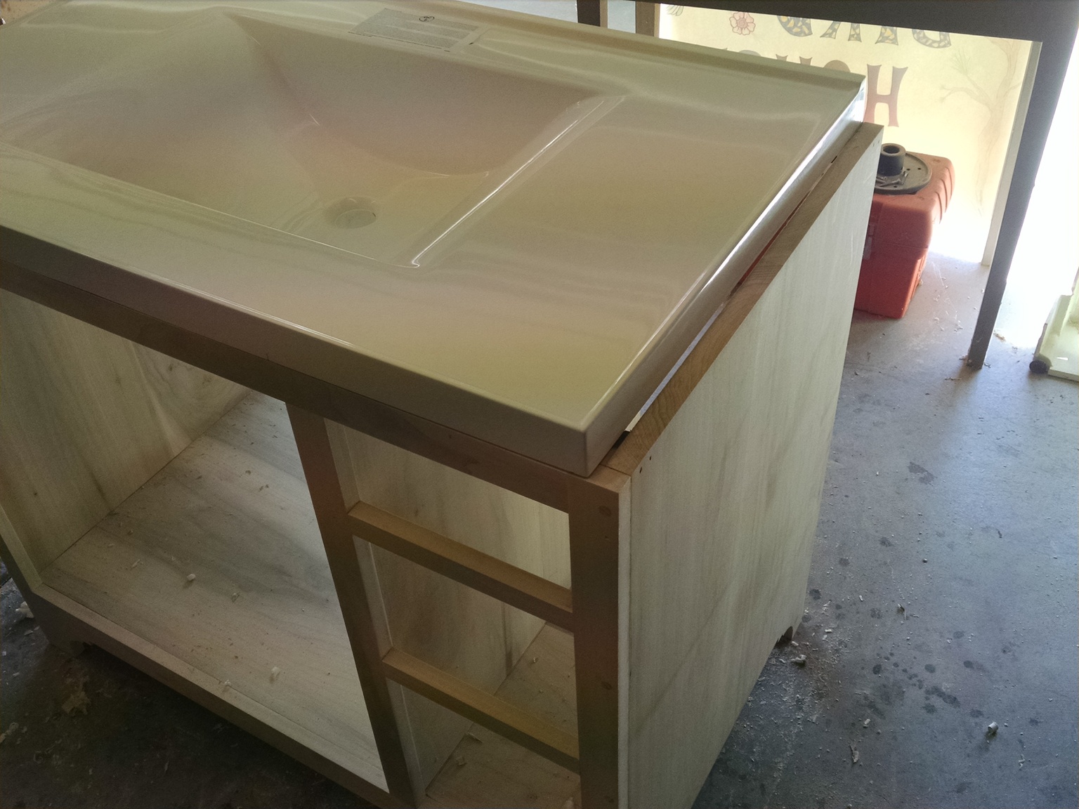

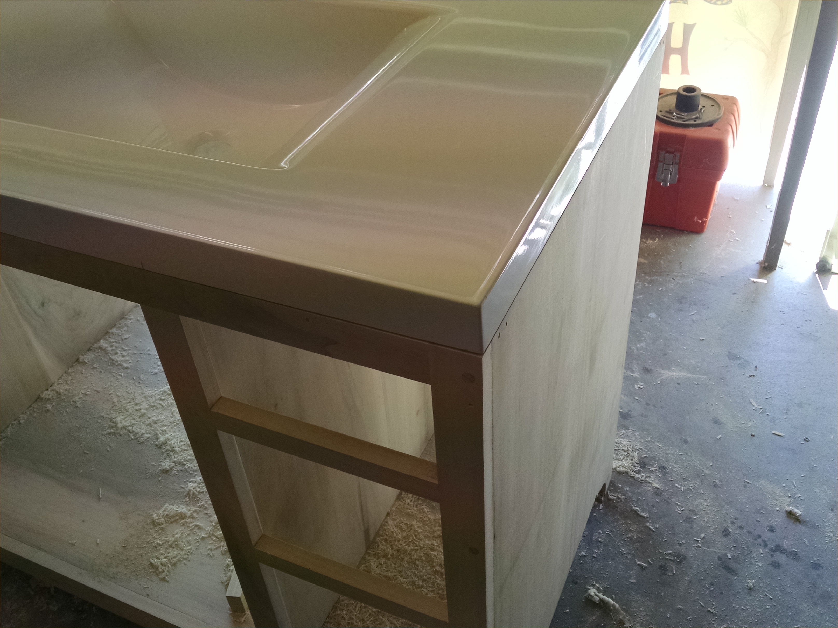

Woops! Just ran into a little problem. I thought I had this figured out, I guess not!!!:lol:
Sink bowl hitting divider.

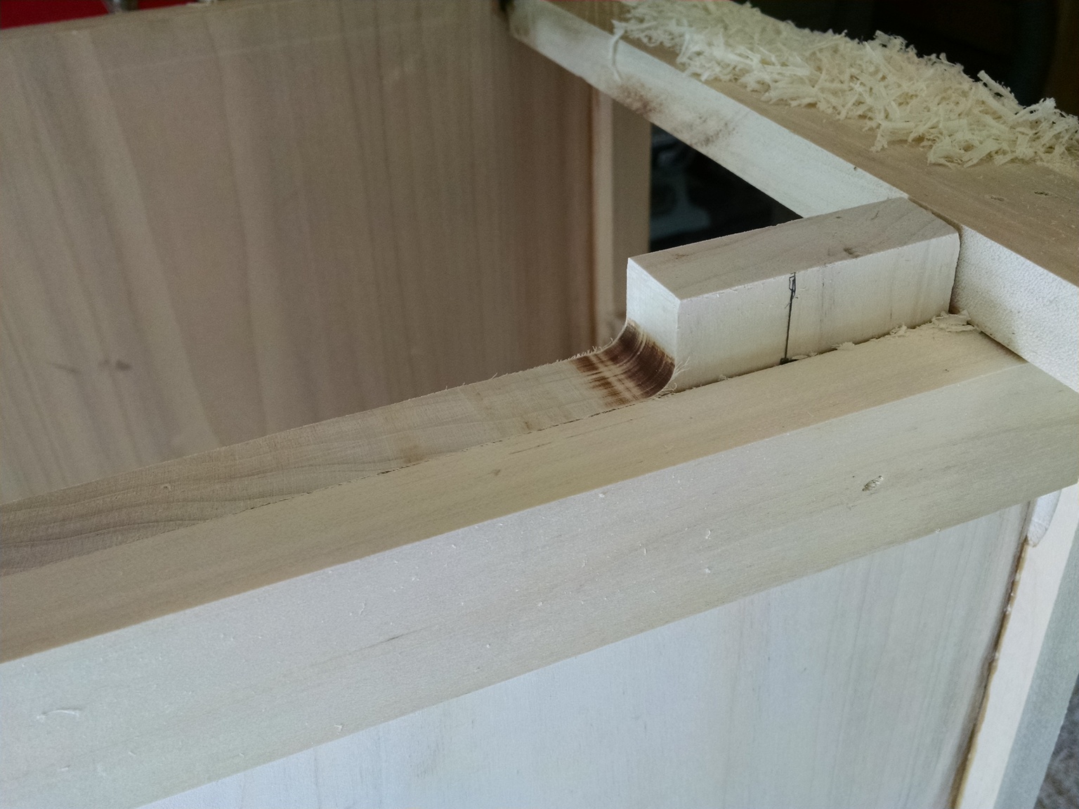

Looks like a little cutting is in order.

And a narrower drawer...or maybe a shorter side.
BTDT. Client gave me the sink top specs, then she bought a different one. Change order!
Share this post
Link to post
Share on other sites

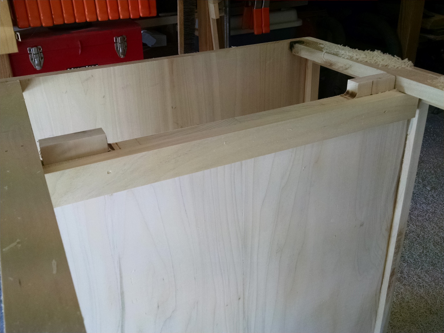

Looks like there might enough meat there to cut out a profile for the sink bowl and it will miss the drawer side. No one will see that design mod.

No mods needed for drawers like Lew stated.

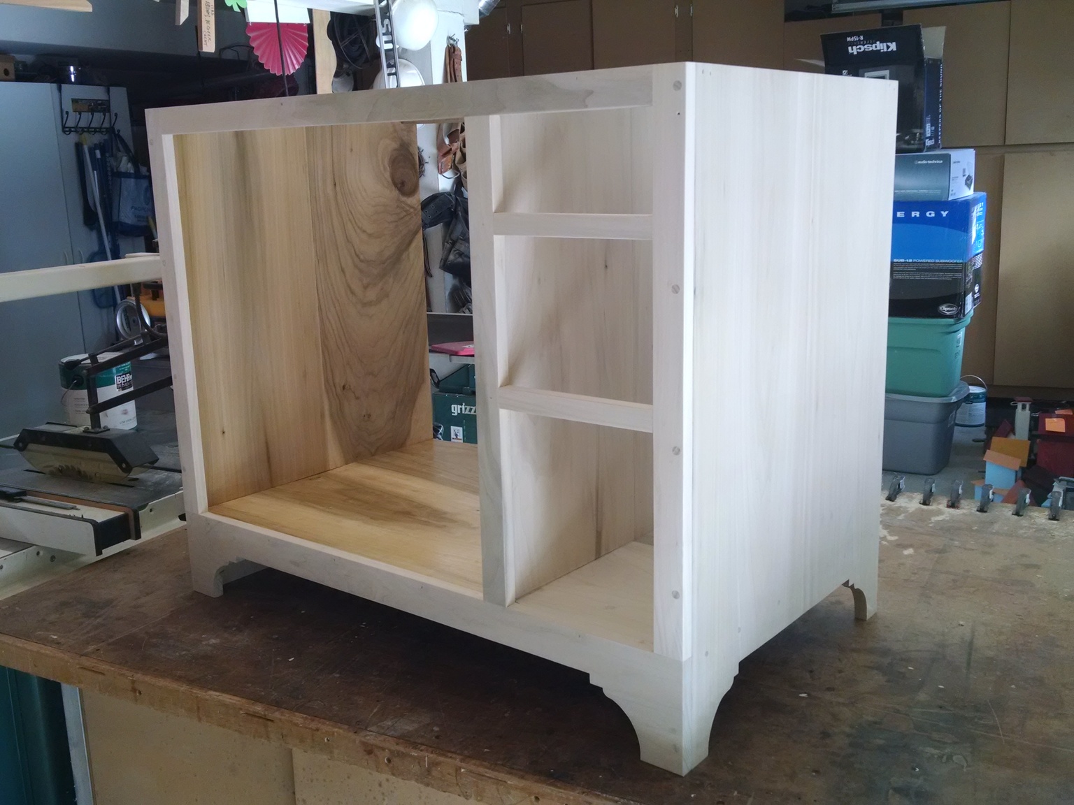

First coat of finish for the inside.

1 hour ago, John Morris said:

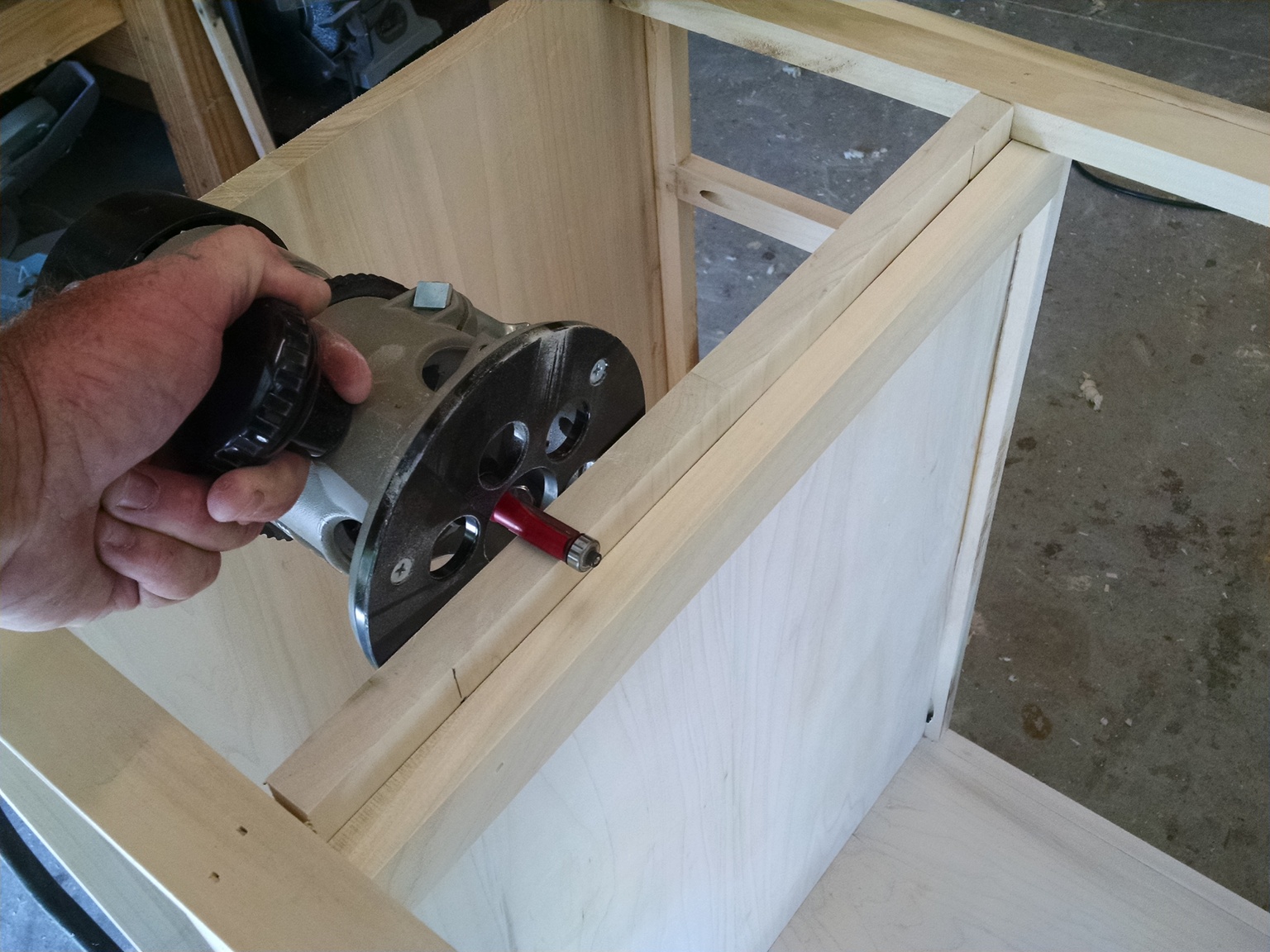

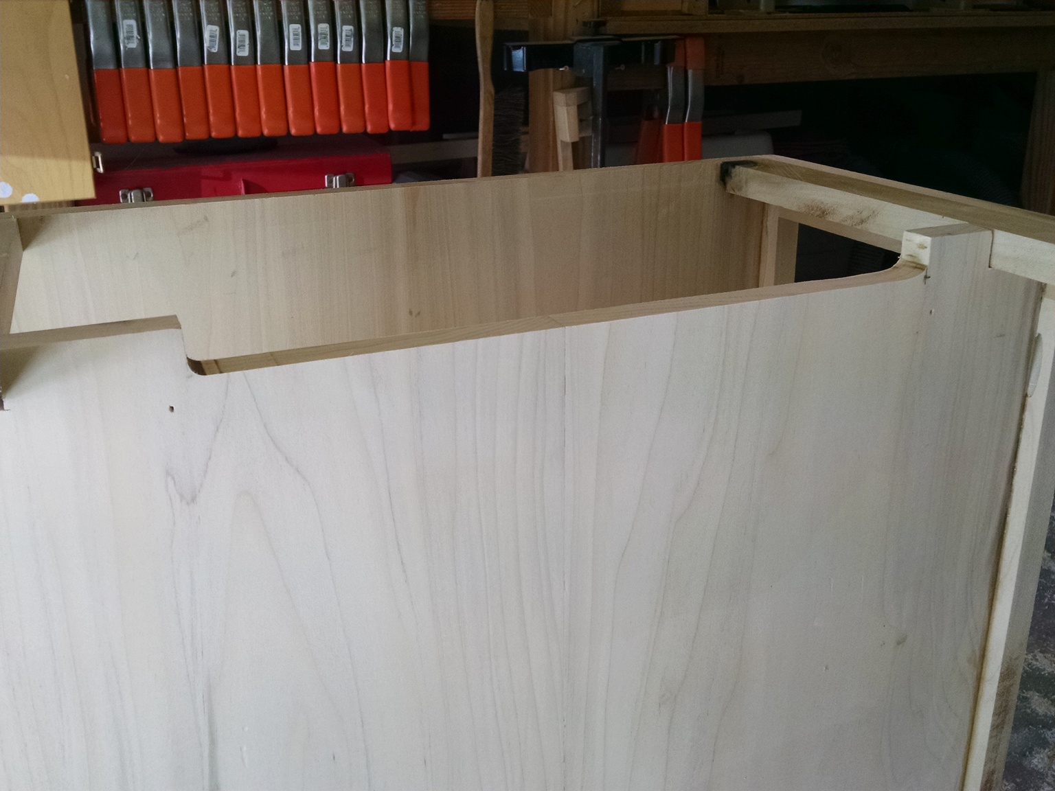

So I got the grinder and cut a chamfer into it and that gave me just enough.
Well like an old carpenter used to tell me, "ya' ain't gonna' see that from the middle of the road!" ;) I gotta' say it looks pretty darn nice from where I sit! :)
Wouldn't have had to do that on a big box vanity because it (a) probably wouldn't have had a divider to begin with or if it did probably would have only been 1/4" covered chip board. Yours will far outlast the appraiser...maybe a couple of appraisers.:D

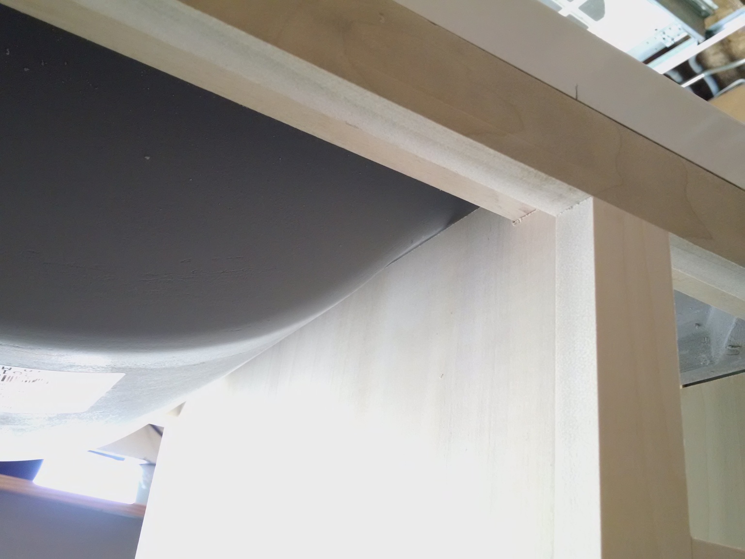

Great Work! Also, nice adjustment to the curve the sink top threw you.

12 minutes ago, Gene Howe said:
Paint tomorrow...how many coats plus the primer???  Drying time...hook it up, fix the leaks....when did you say the appraiser was coming?
One primer one coat I am thinking Gene. If it needs more I can paint in place. Leaks! Surely you jest!:lol:
Appraiser is coming Tuesday. :o
Not pictured, I just installed the Blum Tandems before I closed up shop, I wanted to get those in before the sink goes over the top, I'll install the vanity without doors and drawers, as long as it's functional we are good to go.

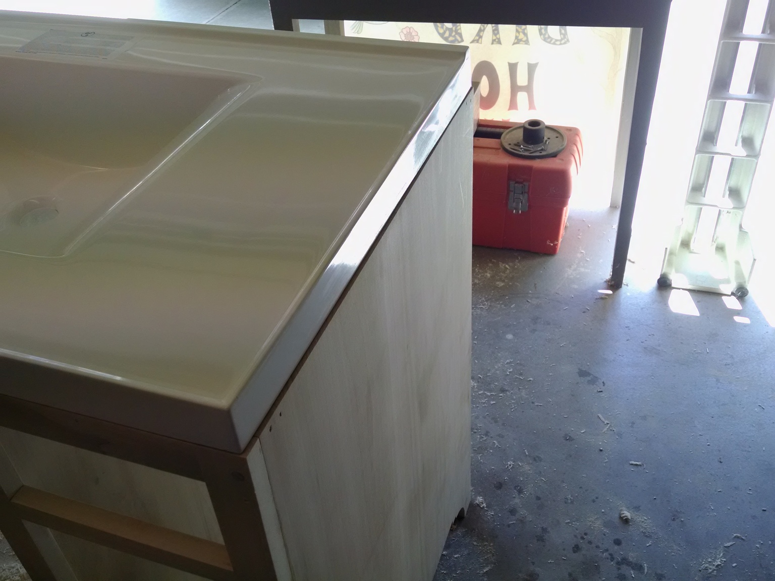

Done and installed. Long day!
Still have doors and drawers to make, but the vanity is bolted to the wall and the sink is in with running water.
The appraisal needed an operational vanity, they got one.
