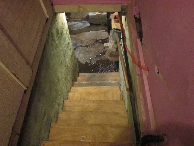

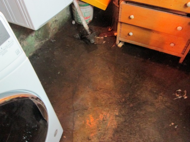

Shop will be closed for the rest of the day.....there is a "pond" between my house, and the neighbor's house....wasn't there a while ago.   BIG Gulley-washer rolling through, went to check on the shop..
Well, THAT isn't a good sign....Checked the floor drain..not working ..
Had over an inch of water here. I pulled the drain pipe from the washer out...sounded like a whirlpool.   The floor in the basement slopes towards this corner.  Pipe wasn't letting the water past fast enough....and more is coming in, too..
Yes, those are ripples as the water goes by.....think I'll just close shop for today....

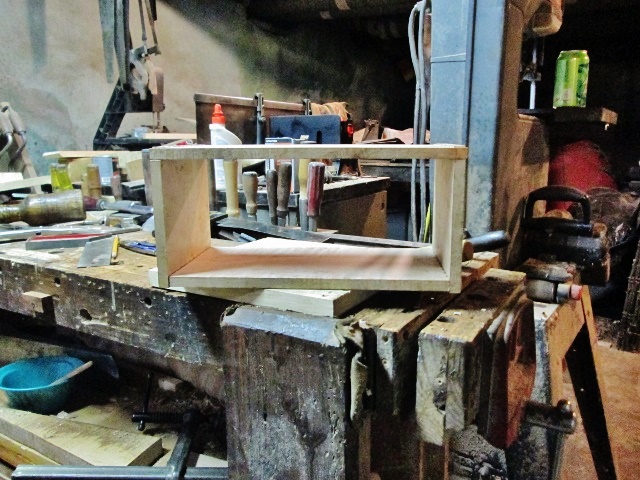

Ok, Yard Sales are down, not much to be found.    Shop is now as dry as it will ever be...maybe I can get a wee bit done?

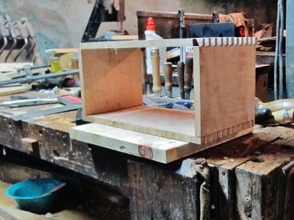

Tried to match up the grain as it goes around...Corner #1 is now fitted.   I'd rather have the fingers a tad long, than too short.  Just a dry fit...down at the other end, corner #2 is getting marked out..
Used a SHARP pencil ( a new one, at that!)   then I cut either splitting the lines or cut on the waste side.   Then clamp it down and chop the waste out...some of them flying up past my head.   Dry fit for #2..
The slab of pine is for all that chopping going on, it saves the bench's top.   Flip this finger up..
And lay out the last two corners.   More saw work, more chisel work, finally got all four corners fitted up..

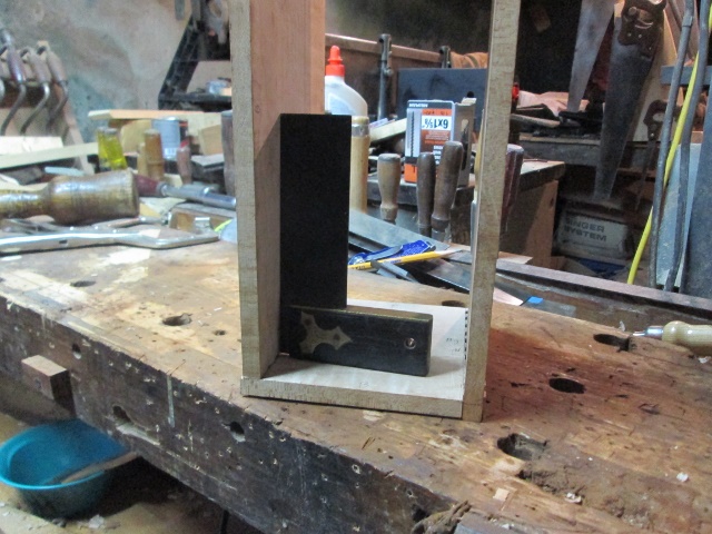

Check for square?
close enough for now.   Have a lot of grooves to cut....
