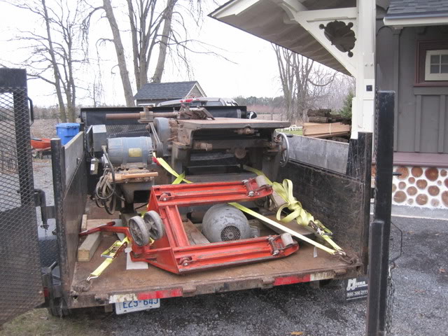

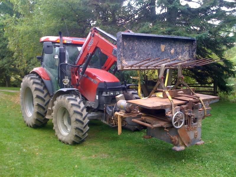

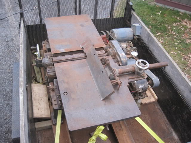

2 day ARN haul horse trade. The wadkin RM Over under is in the yard. sorry boys i use a sissy 400HP tractor for loading:)
home to be taken care of and placed in the wadkin tempal.
skewed knife head
used a scale for scale:
head has the removable plates for moulding
one box of scary came with it
and few other toys
jack

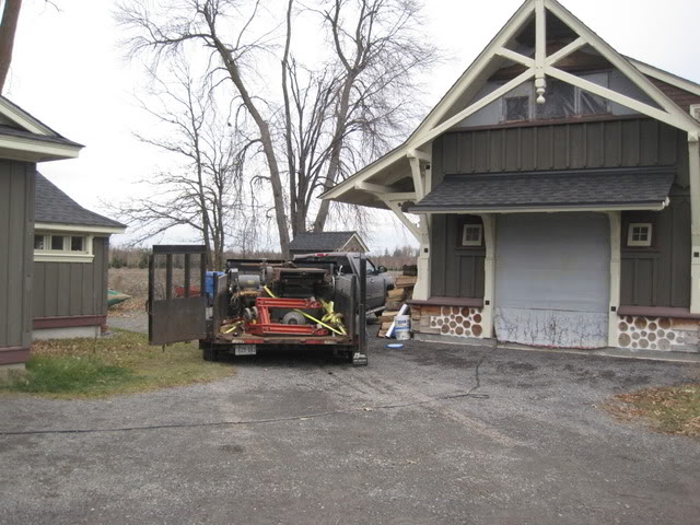

John this thing is big. it takes up about the space of 2 10" cabinet saws. a pump cart can move this so that the best mobil  base for it. for moving it from location to location you need the serves of rigger(that's the name of the pros that do this type of work). you can do it your self like i did but i have a 7 ton trailer with drop axcels amd hydraulic dump and drop ramps. Arthur has moved some crazy stuff and is a real pro. he"s the one to tell you what it takes to move tonnages. In most case you don;t need much.you can move a lot on pipe Maybe Arthur will tell you all about a the 30,000 lbs mill he move this summer.
 jack

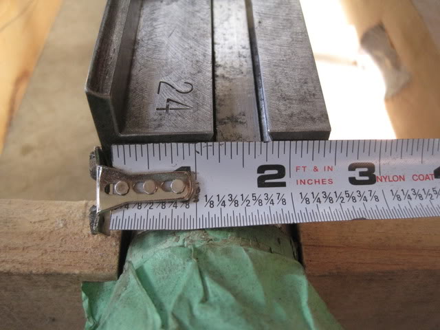

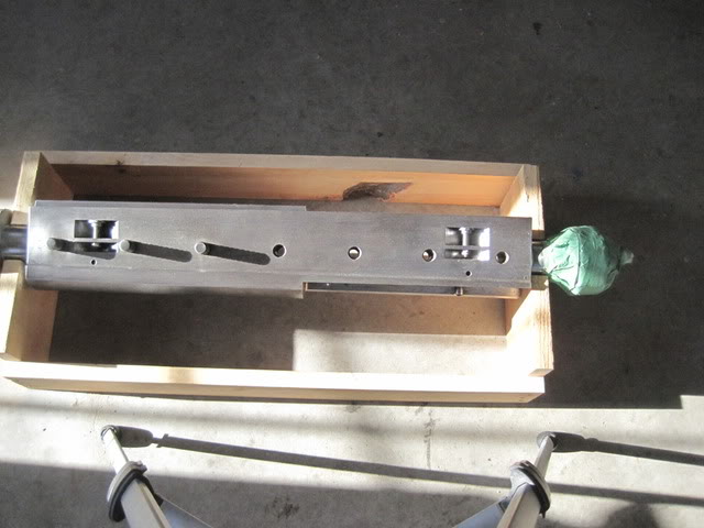

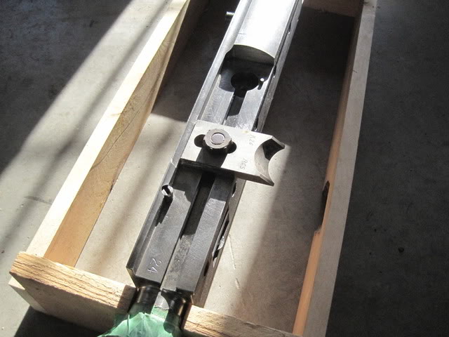

got the head cleaned up and ready to store until i am ready to work the other parts.I wanted to clean the rust and look at the bearing any way. here are some pics of the workings of the wadkin plate/clam head
here you can see that the cutter block is tapered on the sides the jointer knifes plates/clam go.
the wadkin head has keyed jacking/ knife adjustment screws and you don't need the plates to to hold the knifes from slipping like the Oliver head. the stud hole is through the head and the stud bottom on a small rim on the top edge.
a set of Wadkin spent knifes(no life left) with the key slot at the back on the blade. only half of the knifes are useful in this design. the blade are about 1 1/2" wide when new. You are still able to get theses from wadkin.
i have found regular knifes placed in front of the key screw. this is very dangerous with this type head.
you have a 12" section for moulding knifes in the jointer head and it does not upset the straight knifes.
the hard wood side of the head is thinner than the softwood side of the head by about 5/8" this is what skews the knife.
hope you enjoyed the view of the Wadkin Plate type head.
jack
